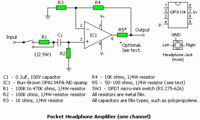

Well, I discovered that if I use a zener and a resistor network to stabilize the base, I might be able to kill the hum almost completely. The higher the resistor in series with the zener, the better. At this point, a JFET might be the best solution.
Of course, I tried to use 10K resistors at the base, but only attenuated the hum. And with 330K resistors it ran into distortion.
Well. The discrete amplifier was a dissapointment, With FETs or no FETs, with zenner or no zenner. The thing still has supply humming with a filtering with 5% ripple.
I guess I will try the OPA2134 idea. I will try it with the resistor inside and outside the loop, and without the resistor.
I wonder it the TL071 is good too.

The thing is that my last experiment had the hum reduced drastically. With music it wouldn't be noticed, but with silence it would produce a bzzzzzzt. I guess I used the wrong FETs too. Is there any JFET suitable for audio?
I don't notice much difference between bipolar and JFET.

Unfortunately, the project I'm doing is fed by a single external supply. However, I might use the current mirror idea to stabilize the amp further.
By the way, what software are you using?
