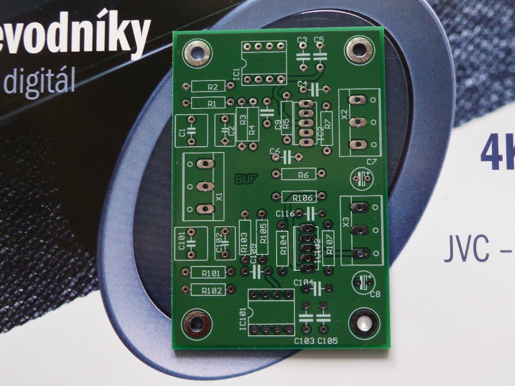

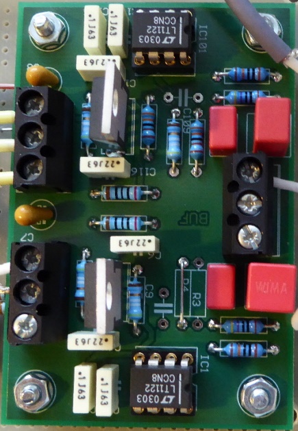

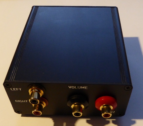

Years have passed again and I made a PCB innovation (ground plane) about half a year ago. The circuit drives long cables without any problem and is perfect for measurement purposes 🙂. Immune to EMI interference.
