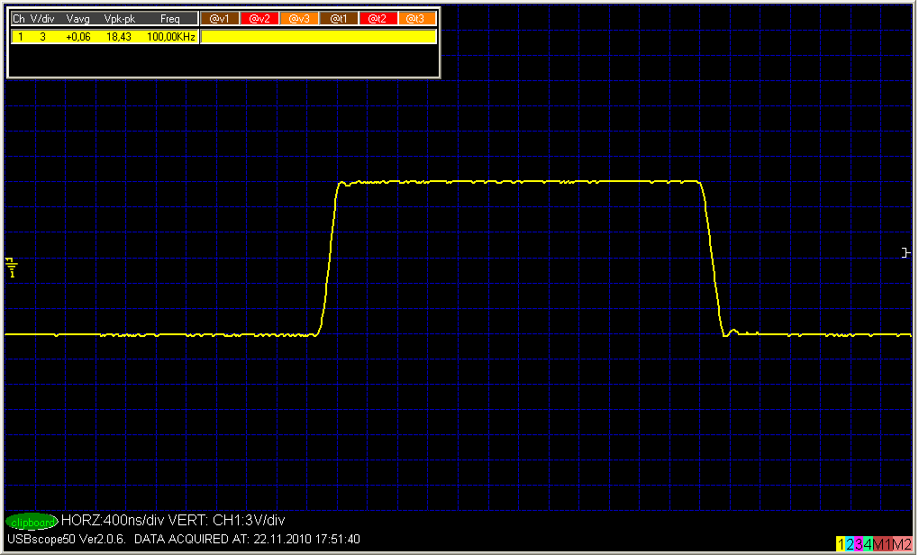

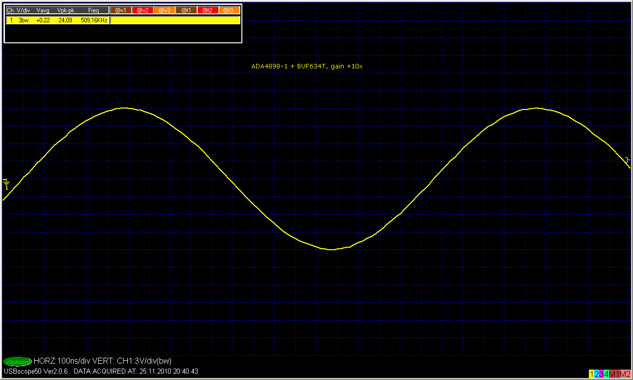

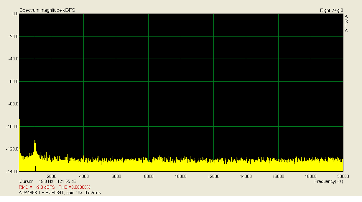

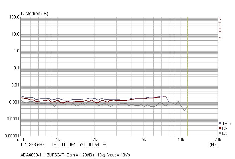

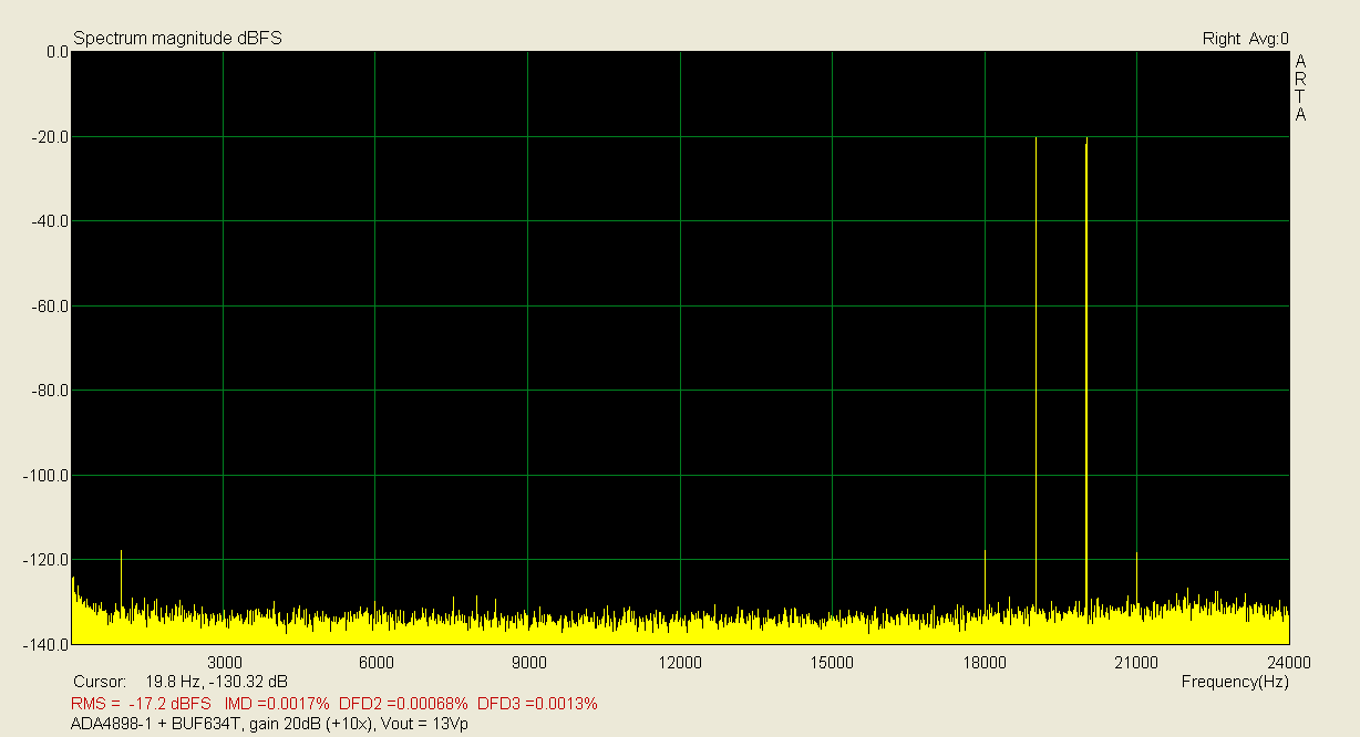

Anyway - what are the current mods. I needed gain, so now I have the gain of +10x, i.e. 20dB. I decided to use Analog Devices ADA4898-1 opamp. This is a very nice part, which has very very low noise 0.9nV/rtHz, enough slew rate of 55V/us and very low distortion up to 100kHz.
Some distortion results measured just below clipping, and 100kHz square response in 400ns/div:

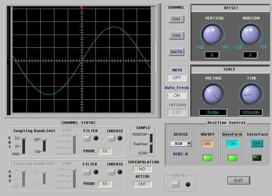

please take into account that the plots are for gain 20dB, and 13Vp. Also, take into account CCIF 19+20kHz plot, and the time plot in 400ns/div.
For 5Vrms, I get 0.00068%, which is just the bottom I am able to measure, so in fact I do not know distortion at 5Vrms.

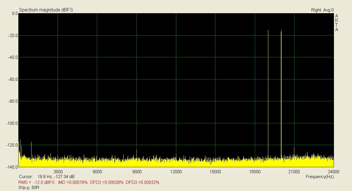

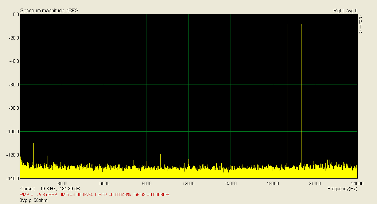

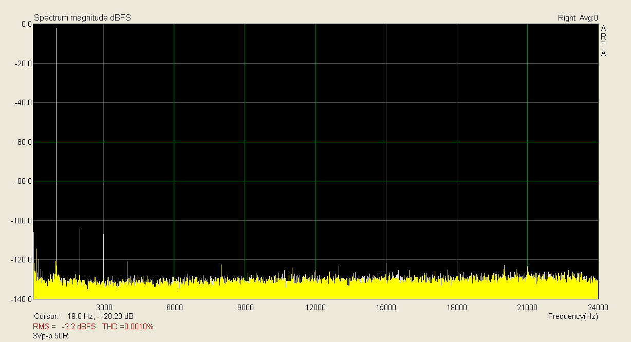

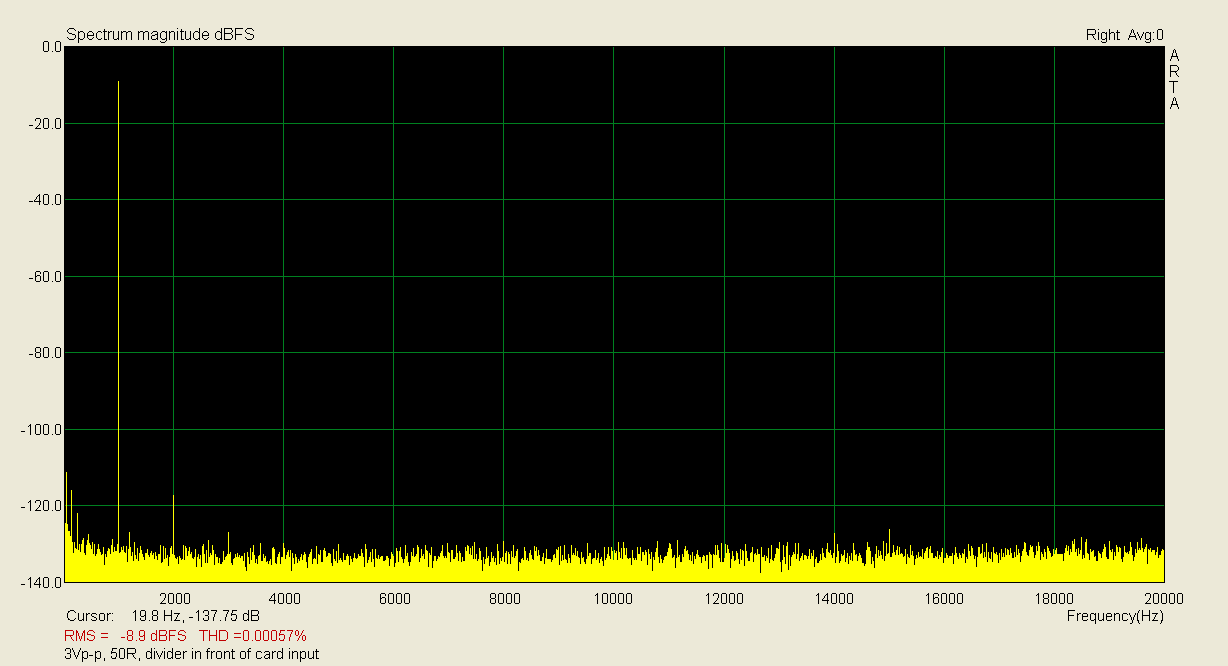

Pavel, regarding the results above, into what load were the measurements made? Unless the same distortion applies into any load down to your 100 ohm example. I'd be most interested in distortion results into a typical load like headphones, for instance, 32-64 ohms, of an output voltage of about 3V p-p.
These 2 measurements are for 50 ohm load at 3Vp-p
________________________

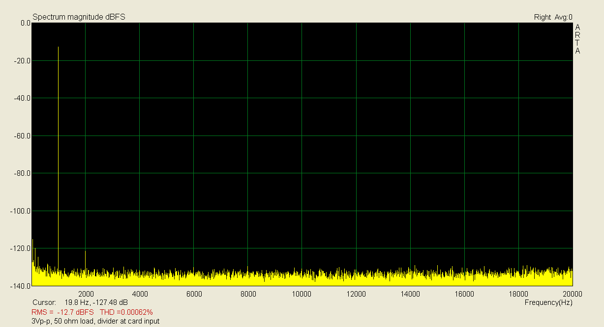

Edit: in fact the result is my soundcard again, and not the buffer. When I add the divider before the card input, I get 0.00062% at 3Vp-p/50 ohm, and I have reached my limits again. The 3rd image.

Thank you Pavel. I think these are excellent distortion results.
And speaking of that, why would anyone try to do better? It really begs the question, why one would go to the trouble of building a tube headphone amp, hugely inefficient, with every kind of distortion higher than this one? 🙂
If we were to put into volts the amount of 3rd order distortion from the second graph, which looks to be around 105dB down from 3V p-p, it would amount to about 17uV p-p.
May I ask what sound card you're using for these measurements?
The soundcard is a cheap M-Audio FastTrack USB. I have to run it 6-12dB under full scale input to get lowest distortion. Also, I often have to use input signal transformer, to convert card input signal to balanced - this is the only way how to keep low distortion of the card at higher frequencies, and to avoid ground loop.

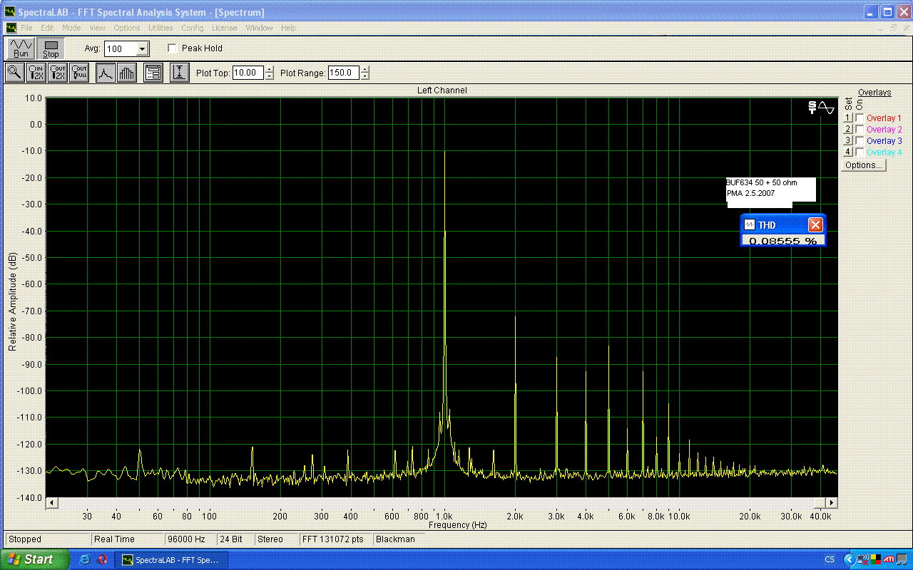

The reason why I do NOT use the buffer out of the FB loop is shown in attached image. When loaded, the distortion becomes very high. This might sound 'rich' to some, but it is undoubtedly incorrect approach. Maybe another out-of-the-loop buffer than 634 would behave better, but I do not believe it would behave perfect.

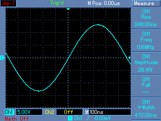

Measurements of the same circuit at 1MHz and full output swing. Now we have both extra low distortion and very fast circuit with very high slew rate above 100V/us. No worries about TIM and PIM ghosts 😉.
The circuit as here: http://web.telecom.cz/macura/buffer_en.html
with gain 20dB.

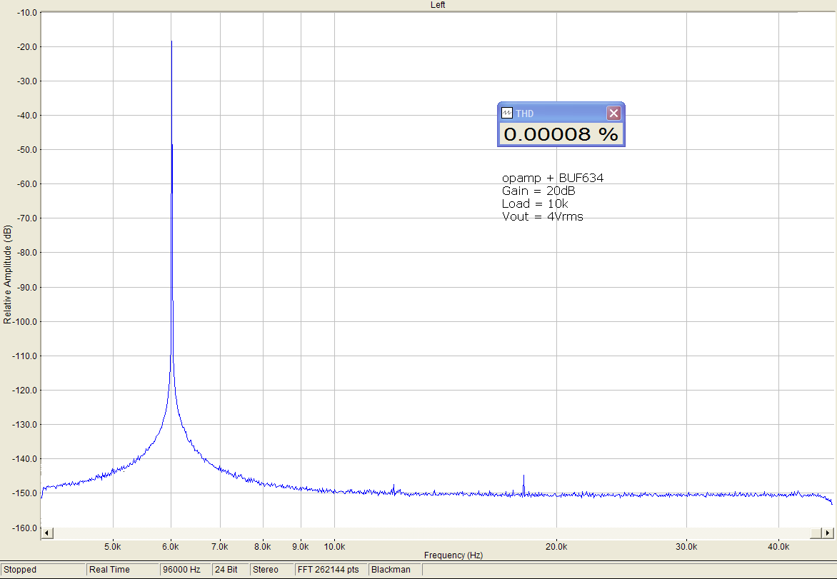

This is the earlier OPA134 implementation, right? It's still absolutely capable as a wideband amp, as you indicate. Thanks for the post.
However, I'm not sure how to read the different instrument plots shown when comparing those of your own M-Audio/ARTA system with your colleague's in post #17. I take it that the greatly reduced "grass" at around -150 dB is due to less internal system noise or is some other, perhaps DSP, technique giving the improvement? It certainly is an excellent display, regardless.
