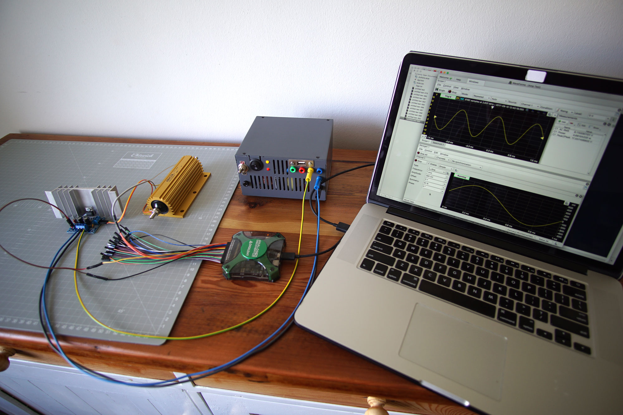

Yup, progress all around! The Analog Discovery is rapidly shaping up to be the ultimate all-in-one beginner's audio analysis tool.

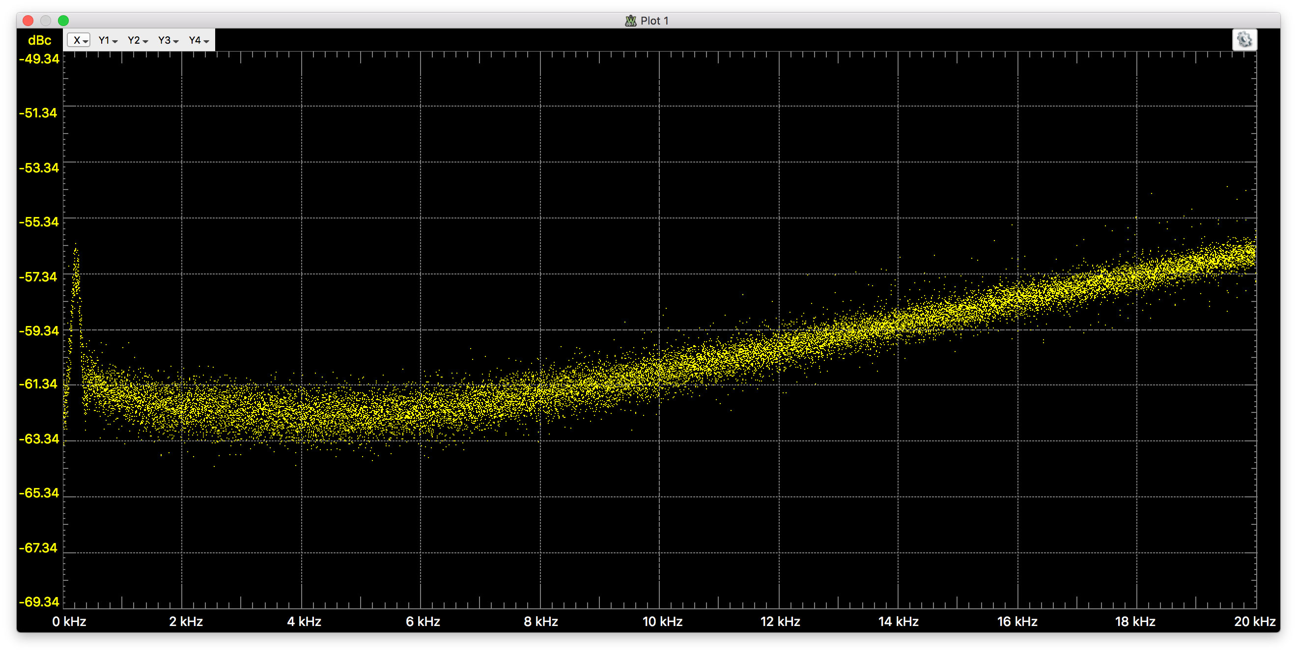

THD vs Freq script
Hi, for those interested, I posted a new version of the script I am working on.
Using script with Spectrum on AD2 - Scopes & Instruments - Digilent Forum
It is not too complicated to use, set the wavegen voltage to obtain the desired output from your amp under test prior to lunching the script.
also note that if your frequency responce is below 100kHz, the values for high frequencies are invalid. You need at least five harmonics to compute a valid thd figure.
The script is slow compared to the video I have seen of the audio analyser suite, but it is better than nothing for those like me who do not have a working copy.
