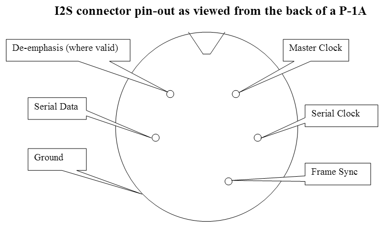

Does anybody know the pinout Audio Alchemy uses in their transports and dacs?
They used a mini-din plug.
I have an Audio Alchemy DDE v3.0, and it has this plug.
It worked with their transports.
My cd-player is a Yamaha CDX-593, with LC-Audio clock.
It would be nice to have the datasheet of the YAC514 dac.
I can't find it anywhere on the net.:bawling:
It seams to me these guys like to keep it secret.
I wonder if Yamaha uses I2S...
Here you go.
Stu
