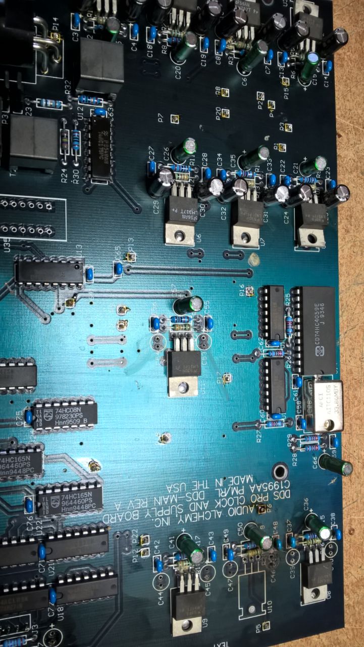

Advice for all owners of Advance Acoustic DDS Pro is to do this what stephensank talking about. I was reading this post one year ago when I bought AA DDS Pro, and I was shure he know what he talking about, even we had email corespondence and he sent me a shematic, but I was to lazy to do it. Every day i consider, and I was saying O.K. i will do it tomorrow, it's not so urgent. This is result - all 22 caps are leaked, and one exploded:

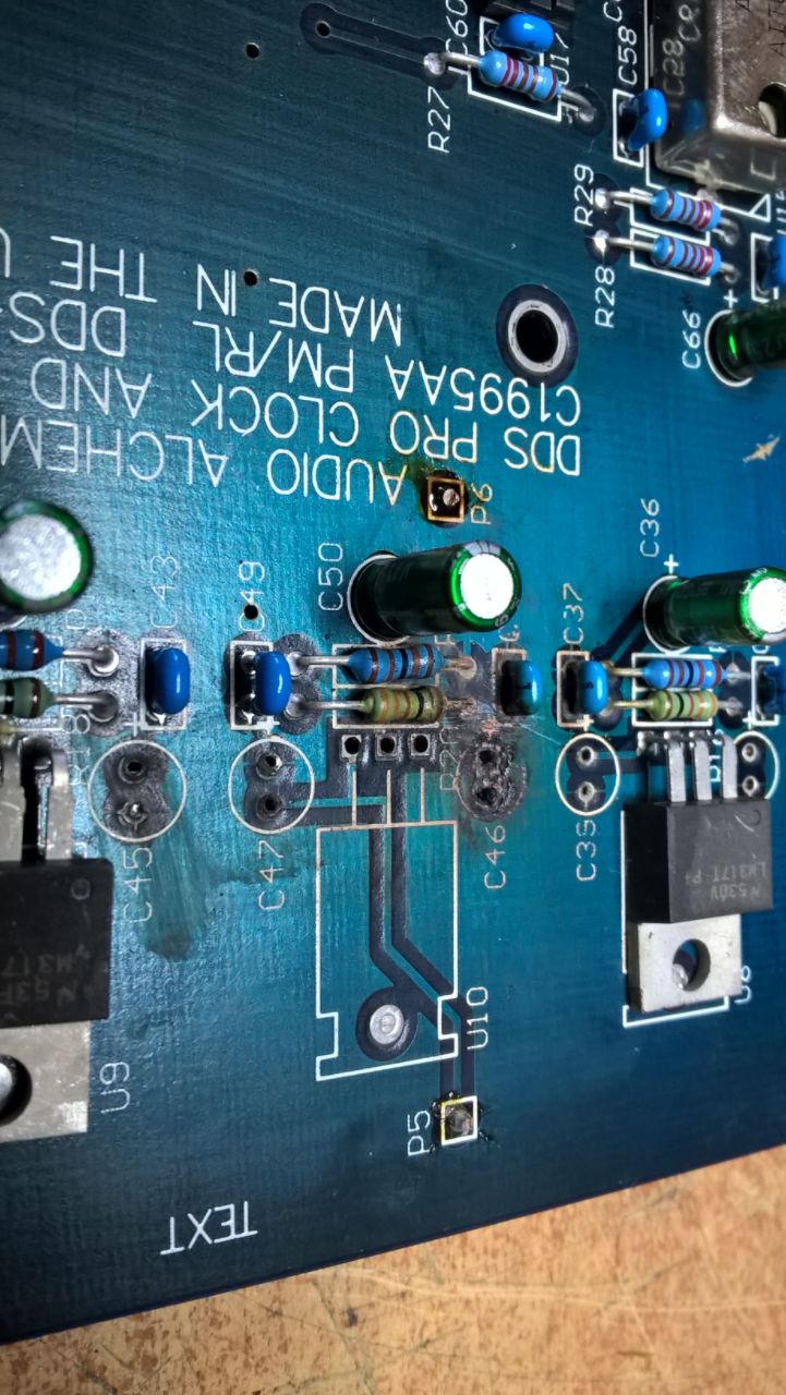

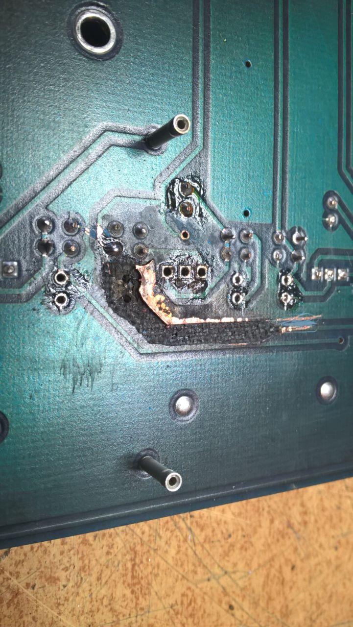

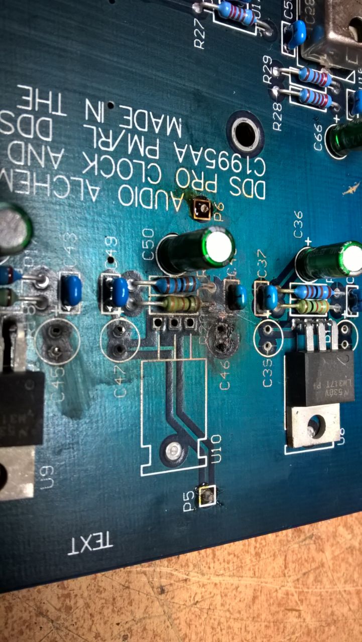

I have one here where i have replaced all the capacitors on the power supply board and even repaired a hole on the pcb.
But now when i plug the powercable sometimes the laserunit moves and i see sometimes scrambeld display or i see 00 and no responce from the buttons and sometimes the laser moves to the begin position.
Do you have some service manuals on all the points on the power board ?
Or could be the servo pcb is broken by the leaking capacitors on the power board.
