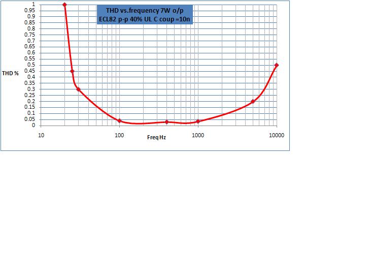

Decoy....reducing the coupling caps in gnfb amps and with a bigger signal in o/p tranny generally results higher F2 harmonic. Try it. Graph shows it.

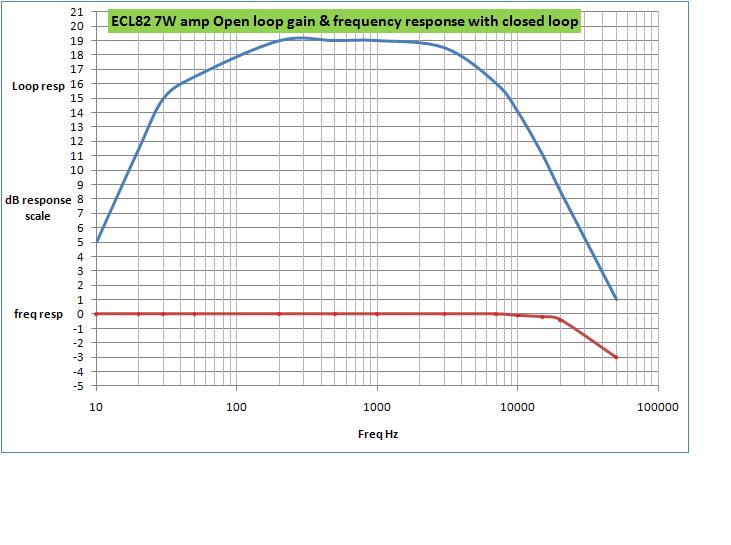

Reducing coupling cap value in early stages reduces loop gain at the lower f end so effective gnfb dB value has dropped.

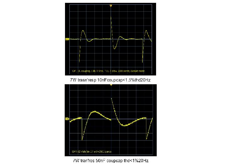

Typ loop gain graph characteristic of a 7W 3 stage amp. Notice the effective gnfb of 11.5dB at 20Hz with 10nF concertina coupling caps. With 50nF caps the line would be much straighter but the circuit has considerable transient overhang with the lower thd because loop gain holds up which forces phase towards oscillation. The side effect of excess gnfb is a sluggish one note transient response......bad for quality as the speaker cone is held out longer on a transient excursion creating a reduction of other audible frequencies. Worse is extreme values causing blocking.
The distortion results at the low F end is shown in the combi graphs......
Which one would be chosen ? The one with the better transient recovery i.e 10nF at the expense of increased low freg thd sounds better and the amp can be pushed harder.. Actual optimum circuit transient response occurs with an 8nF cap so 10nF was chosen.
For those who mention that some tube amps display the LF squarewave with an inherited slant away from a true squarewave form is quite correct.....something has to give for the "Q" to be optimised.
