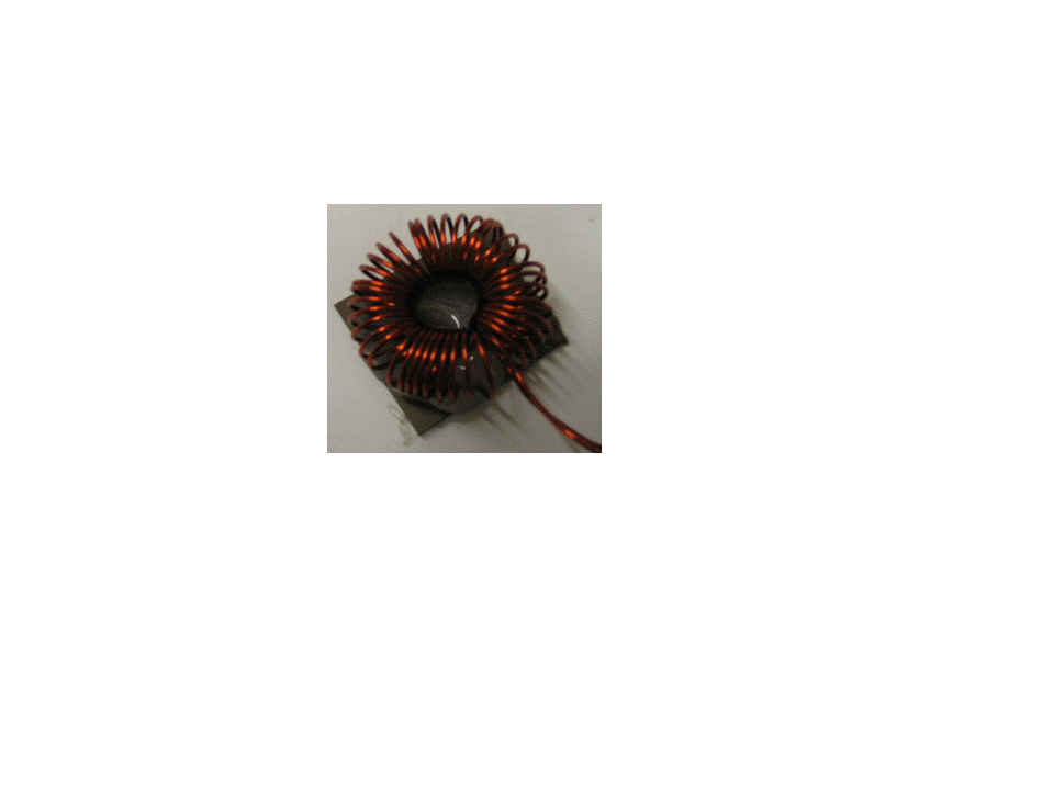

Hi Conrad
I thought I'd solved the direction sensitivity by making the output coil (mostly) non-directional with a toroidal.
But now I'm not so sure even this is any use ...
Picture is of first trial made some time ago. Details for anyone interested (if there are any left) re 39 turns 20 swg (0.9mm) half-inch /13 mm core (drill) and then folded into toroid around same half-inch drill at centre. Inductance 3.3uH.
cheers
John

John- I thought of winding a coil and bending it into a toroid, but never tried it. IMO, it's a much more preferable configuration. I believe you can get non-magnetic ceramic toroids from Amidon or a similar company. Did you know that the large General Radio inductance standards are huge toroids wound on non-magnetic cores, packed in powdered cork for mechanical isolation and stability?
