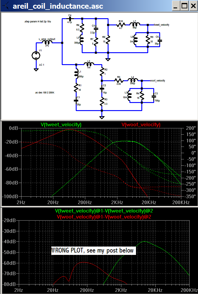

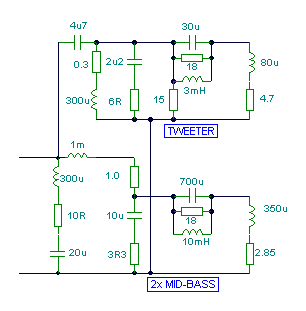

Hi teemuk,
After cutting through the noise I now have a chance to come back to your genuinely valid contribution to this thread.
Congratulations for conducting these simulations/measurements.
A single driver tends to load an amplifier more lightly than a resistor of Re value, though a composite loudspeaker with crossover tends to be more reactive with a dynamic loading quite different to its steady sine loading.
Maybe if you tried something like the approximate Ariel equivalent circuit as attached.
I wonder in what way you tried to 'hear' the differences with an electrical model ?
(Genuinely interested here; ie. I'm not trying trick questions or picking holes in your effort.)
You tried a 2uH choke, and say you observed distinctive crossover components.
Did you check their frequency range/spectrum ? ( I would expect these to far exceed AF frequencies. Thus AF digital equipment might have insufficient bandwidth.)
The voltages you measured for a 2uH choke and nominal 4R LS are relatively greater than those I simulated with a suddenly starting at 10kHz with 6uH choke and the virtual 5.3R(complex nom) Ariel LS, a figure which many in this thread (like Jan) have stated their opinion on as my - "your insistence to built a whole framework of bogus theories as based on a single input signal that is irrelevant to audio".
However, using a musical sample can hardly be claimed as being 'irrelevant'.
Excuse - I've lost your post as I fill in this little window.
Was your 2uH paralleled by a resistor ?
Looking forward to your reply in the hope that we can take this investigation beyond what some claim as being theoretically impossible, and thus back-up the subjective claims of those who state they have heard a choke having a fractional degrading effect.

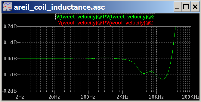

Hi teemuk,
In the last post (four days ago) I commented that the error voltages you measured were relatively greater than those simulated by me.
This is quite logical, because my simulation *merely* suddenly started from zero, and was not an input music voltage waveform driving with respect to an already flowing plus either same polarity or opposing back-EMF/reactively-induced current, due to prior waveform energisation.
I look forwards to you coming back with further input.
Where filters, loudspeakers and reactive circuits are concerned (including many NFB amplifiers), the waveform voltage 'group delay' becomes modified in time by current flow, and thus any voltage error at t=gd has the potential to be at least twice the difference in amplitude for waveforms superimposed at t=0 and t=gd for any excitation when simplistically viewed at either of these time instants.
Not sure whether I could simulate this, though I'm not free to at this moment anyway.

to add to the modeling I've shown Graham's areil circuit, redrawn to show what I believe are the driver's electromechanical motional impedance components grounded as you can see in other dynamic driver models
this should give the electrical analog of cone velocity at the nodes so labeled - another layer of modeling would add mechanical-acoustic coupling to give a predicted spl
I assume that whatever the mechanical-acoustic model that the output spl in a nominally linear system will have approximate proportionality to the cone velocity (at each frequency - kind of the definition of linear system)
the sim steps the L_amp_output from a negligible (and unrealistic) 2 pH to a large by the standards of this discussion 10 uH and the last graph plots the dB difference between the 2 inductor value responses
10 uH is the value at which the difference trace just reaches -40 dB => 1% frequency response difference, and just equal to the threshold established in double blind a/b/x comparison tests as the statistically significant limit of resolution for a wide number of skilled listeners - at least those willing to subject themselves to controlled tests

usual Linear Technology SwCAD III aka "LtSpice" file:
while there is little doubt our understanding of psychoacoustics is incomplete, it would appear that a controlled dbt study showing that the 2 uH output coil that seems be under discussion is audibly detectable with a similar speaker load to the areil model would rate publication

apologies, I did mess up the plot and conclusion above
there is in fact an error in my sim presentation, I confused what LtSpice is doing when I subtract dB in the plot display
the correct approach is to plot the ratio of the 2 traces, giving a different result:
3 uH now gives the 0.1 dB, 1% difference with my interpretation of the areil model:
so my final para above is an overstatement;
2uH should be inaudible but is not as far below the threshold as I mistakenly thought
