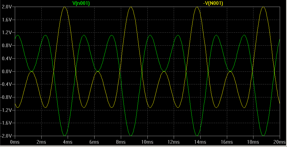

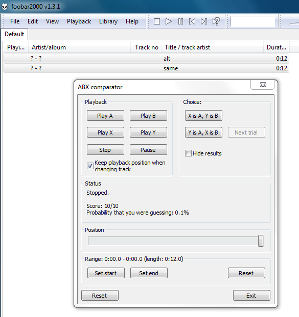

12 second 48k .wav of 200 + 400 Hz 1:1, with "alt" file alternating polaritiy every 3 seconds, 200 Hz + 400 Hz/90 degrees sines 1:1 amplitude
"same" is matched amplitude, frequencies, envelope but polarity doesn't change
haven't tried foobar2000 abx yet - because I can't hear a difference in "alt" sighted yet - but I'm somewhat distracted by the cliking in my left ear as my sinus intermittently blocks and clears

still no activity re my polarity test fies? - admittedly I just put the files here because I couldn't link them to the discussion on head-fi
but as the discussion developed I did install foobar2000 and its ABX plugin and it turns out that I can hear the difference, just can't articulate it clealry - foobar2000 abx, motherboard Realtek HD sound, HD600 direct from computer headphone connector

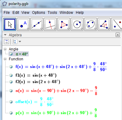

so I prepared visual for showing how polarity of a 1:1 fundamental and 2d harmonic asymmetric test tone depends on relative phase of the components
I add a phase dependent offset (magneta) to the dynamic sum (sum in blue, magenta is "0" line for blue) to show the +/-90 plots mirrored about the x axis so polarity should be clear by eyeball
I move both the fundamental and the 2nd phase to center the +/-90 sum's peaks on the y axis - "48" in the algebra pane is just the value of alpha when I did the screenshot
the varying vertical offset is just a visual aid I hoped would make the sine harmonic addition picture easier to read - less lines crossing over to keep track of - our eyes are really happier looking at a mirrored figure/seeing the inverse symmetry when the "fold" doesn't have overlap, is based off the mirroring line
green, red should be very easily seen to be mirrored about the x axis == inverses, inverted in polarity waveforms just from shifting a sine and its 2nd harmonic
direct link to animated gif in case diyAudio "pickles" the image http://img.photobucket.com/albums/v252/f5r5e5d/polarity_zps3af73b48.gif
obviously the audio doesn't want the offset - see my earlier Spice sim waveform picture - which didn't seem to convince everyone
I did get one taker for a listening test over there so far
Testing audiophile claims and myths - Page 167
...For the benefit of others here, as I said in my email back to you: The tonality of the normal and inverted sections sounds identical to me, but the pitch seems to go very slightly flat on portions 2 and 4 compared to 1 and 3. I know the frequencies don't really change because I looked at an FFT, and I also created an inverted version myself from the source. So I now agree there is a difference! I think it's probably a psychoacoustic effect, but it's there. At least for me.
So what do you hear as the difference, pitch or timbre?
--Ethan
