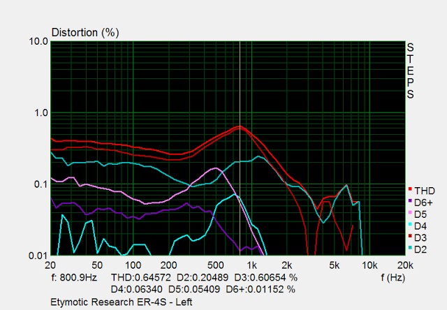

In these tests, how is the contribution of traducer distortion factored? As an example, the very highly regarded, and far from the worst, Etymotic 4s below. How should reports of hearing 0.1% 2nd using a device like this be approached?
