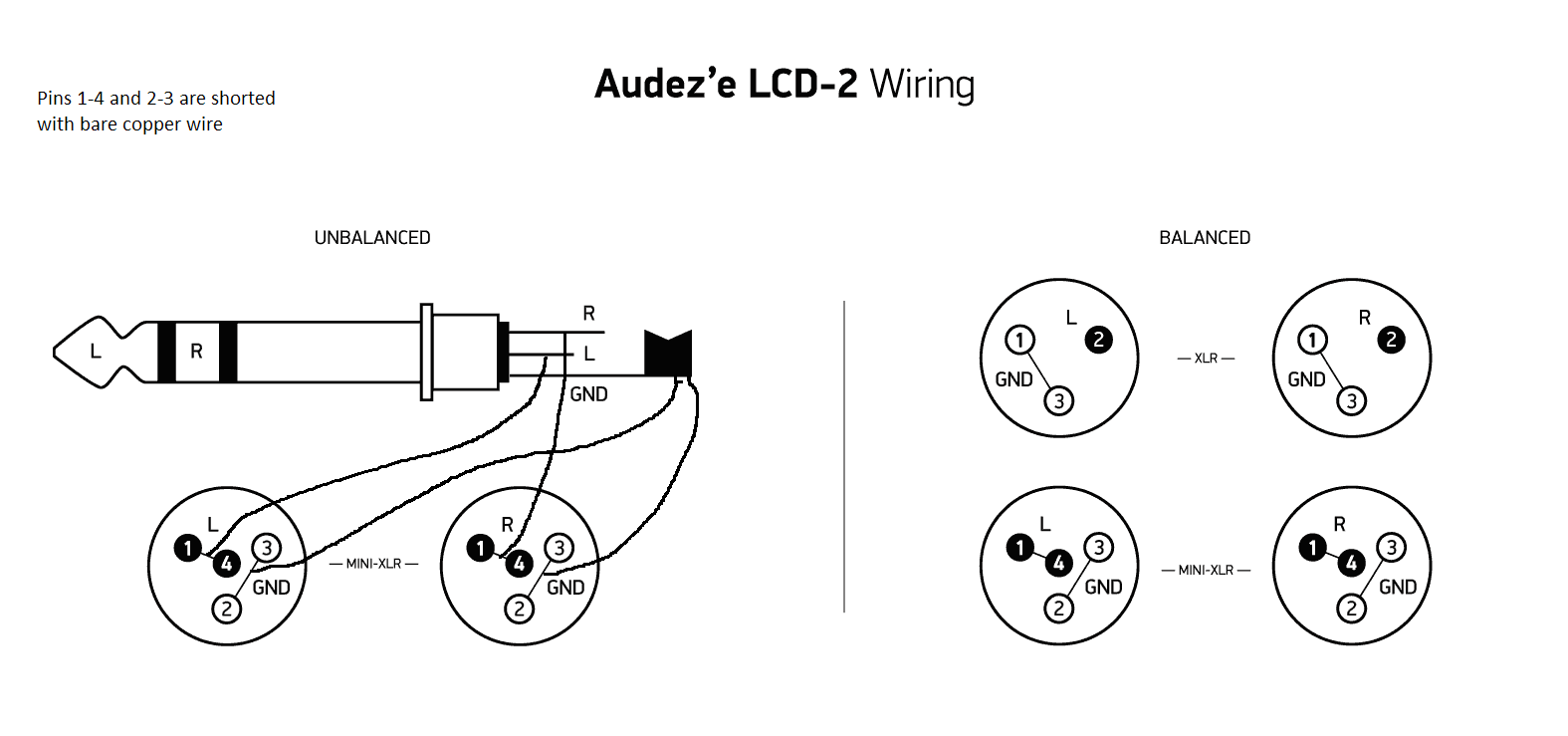

This will be my first attempt at making a headphone cable and would like to know if this is the way to go about it...
Unbalanced cable using a 1/4" TRS plug and 2 mini 4-pin XLR's for the headphone end, left and right.
Is this the correct way for wire hookup? See diagram below....:hphones:

I just use pins 1 and 3 on the mini XLR 1 for + and 3 for - so for you
left channel
phono tip = pin 1 on mini XLR
ground = pin 3 on mini XLR
right channel
phono ring = pin 1 on mini XLR
up to you, its done internally in the headphones afaik, never had a complaint, but if you want to be 100% sure it wont hurt to short them. some places do silly things like using 4 wires, when lcd-2 is one of the easiest headphone loads around
