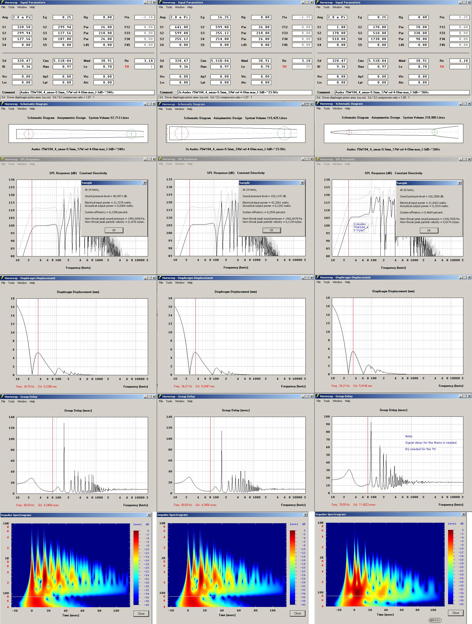

That's a really nice woofer I think deserves a home in a T-TQWT or in a TH:
The first of submitted pictures.
Note that One T-TQWT using 2 drivers equals one TH if SPL capabilities are compared and you need to invest in signal delay units targeting your main speakers and EQ to tame the TH: Making it more expensive to build in total costs than for a dual driver equipped T-TQWT that also would IMO provide superior SQ.

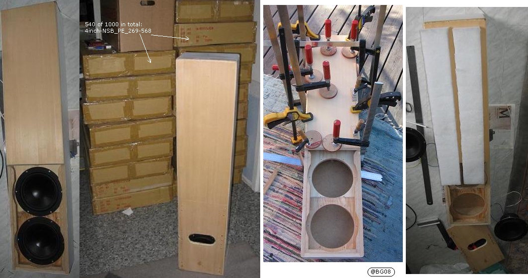

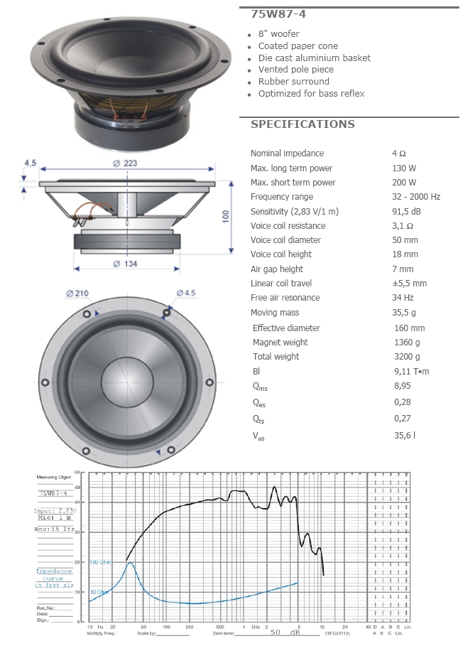

About 4 years ago I made a T-TQWT with the smaller 8-inch Audes-75W87-4 that came out with very good performance.: The following 3 pictures.
b🙂

Hi Henri,
The very first picture contains 3 different simulations: A T-TQWT using a single driver a two with dual drivers.
The first of columns(from top to bottom) is the one with a single driver.
I fact if you compare the first two of simulations you will notice that when using two drivers the CSA:s (Cross-Sectional-Area:s) are doubled but the length's remains equal, thus the volume a two driver enclosure is doubled when compared to what a single driver needs.

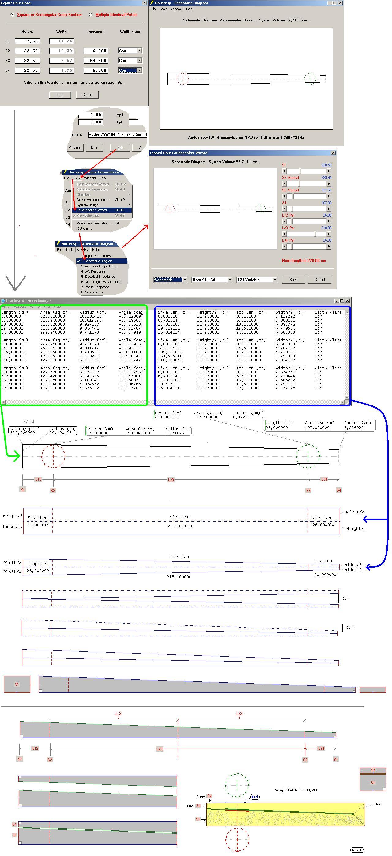

Henri,
Do a DIY search on 'Hornresp tutorial'..and read HR help file. At the main screen set Eg = 2 V for 1 W into 4 Ohm.
b🙂

This is automatic HR calculatsion.
But still to dummy for this program..
That's not what I pointed at.😱 I guess you need more spoon-feedings on this very simple matter:
b🙂

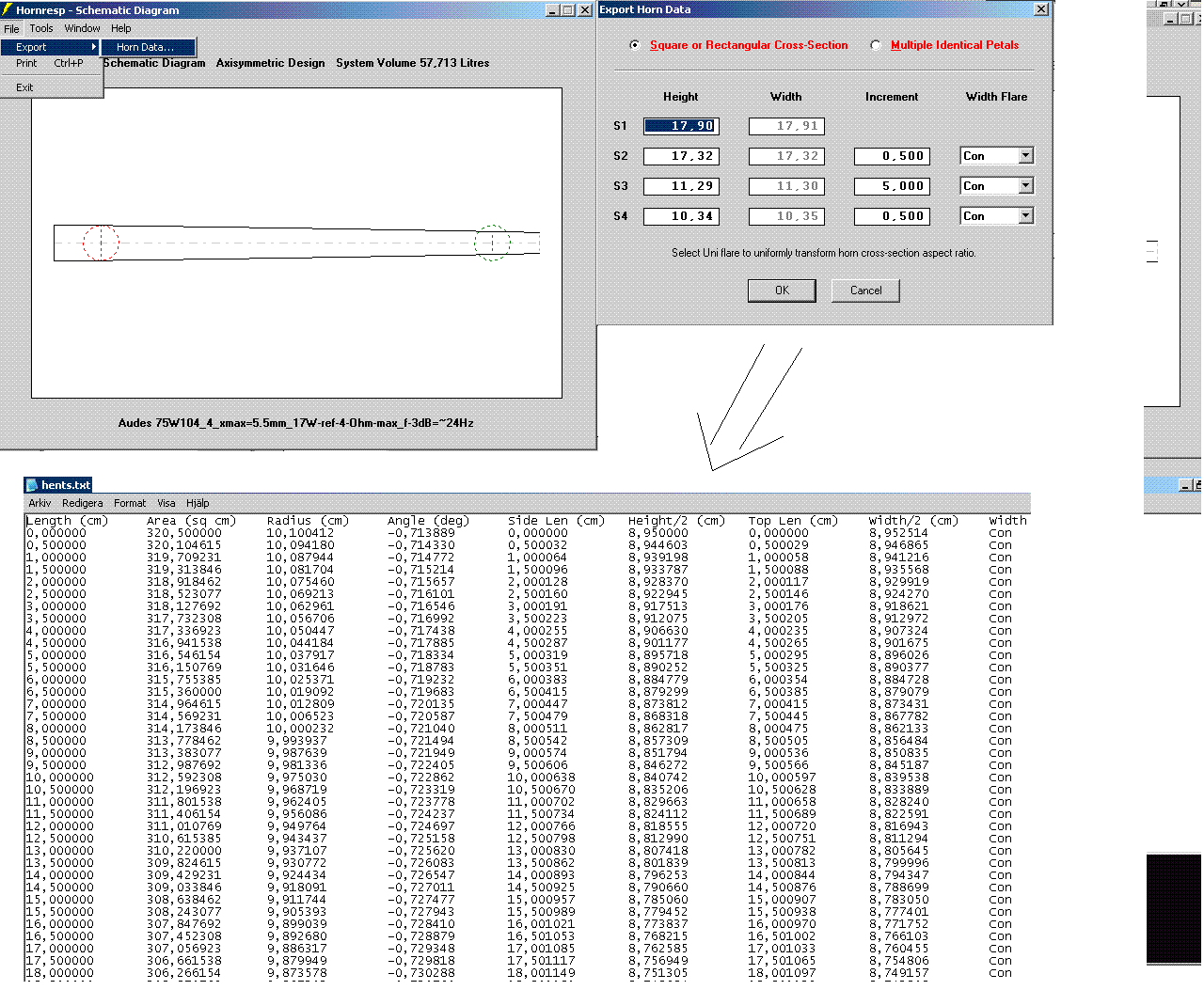

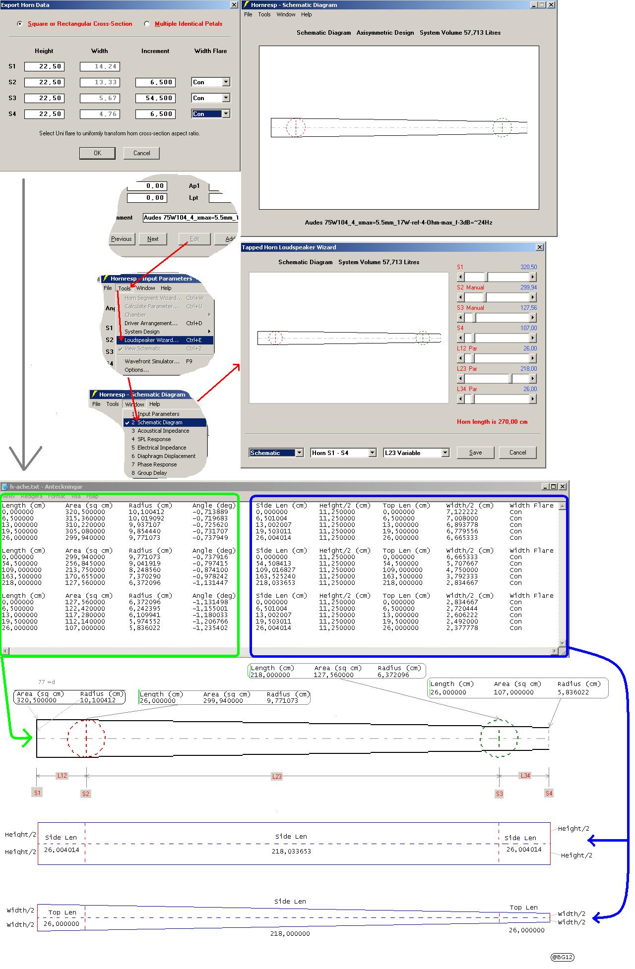

Whne i get HR how long is ``horn`` then i must to make a plans how fold that ´´horn´´?
Or works straight box?
Henri&bad english skill😛
Hi Henri,
The internal height of this single folded T-TQWT is 109+26= 135 cm.
If you use 18 mm wood then the longest dimension would be 138.6 cm.
I updated the last submitted picture:
b🙂

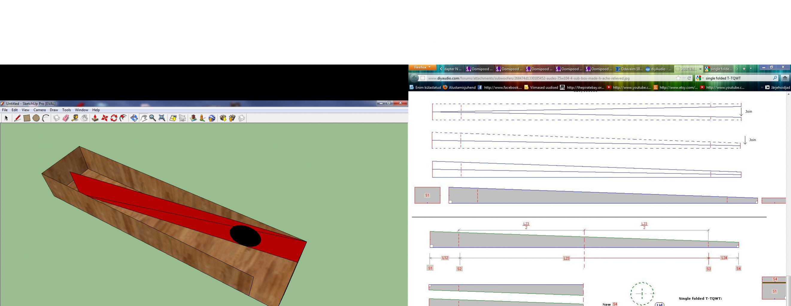

Did this box is like that sketch up?
Black circle is driver.

..Did this box is like that sketch up?

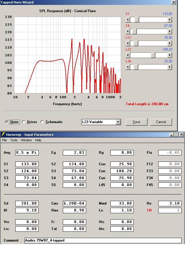

Black circle is driver..
Your Sketch-up picture looks like a TH, not a T-TQWT.I haven't simulated a TH yet..
..Bjorno, did that calcultsion what you posted is right box what i need?..You know how that prog use, did you can say what is this box maximum spl?..
My step by step picture is using the information of the very first simulation/row in post#2 where a single driver can handle 17 W max that returns a SPL/1m of ~110 dB if placed at a floor-wall junction (2 x Pi) and if close to a corner(0.5 x Pi) a maximum of 111-112 dB/1m.
