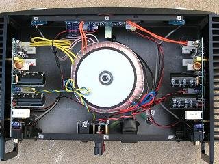

Dear Mr. Chris,
I not only forgive you but I thank you very much indeed for your extremely kind and valuable reply.
The thump at the switch-on does not worry me.
I intend to switch it on once a day and then leave it on continuously.
What still worries me is the current delivered by the amp.
Now that you mention Samson brand, I have actually a Samson Servo 260 at hand that fails to give me an adequate bass response through my present speakers (old Dynaudios).
It is weak and slow, an evidence of low current from the amp.
From some photos I can see that the transformer inside the A500 seems quite more substantial and this is very good.
Do you have any idea about its VA rating ?
Looking at the specs the Servo 260 is 130W/4ohm and the A500 should be 230W/4ohm.
On the basis of your very positive opinion I strongly think that the A500 will be my next power amp.
I like very much the way how is built.
Thank you very much again for your very valuable advice.
Kind regards,
beppe
