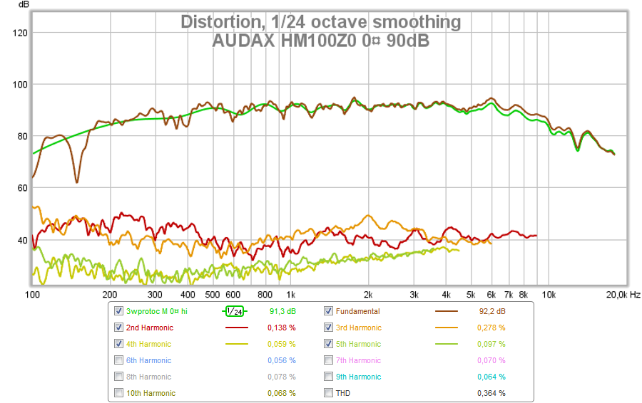

I had a proto 3-way with Audax. Still have them but no ideas to carry on...

Andy, What did you ever do with this driver?
I did not purchase the driver. It or a similar small midrange was intended to squeeze below a tweeter + waveguide in a limited height. Currently moving forward with a coaxial midrange + tweeter but intend to revisit the non-coaxial arrangement at a later date. Would still like to see measurements of the current Audax HM100Z0.

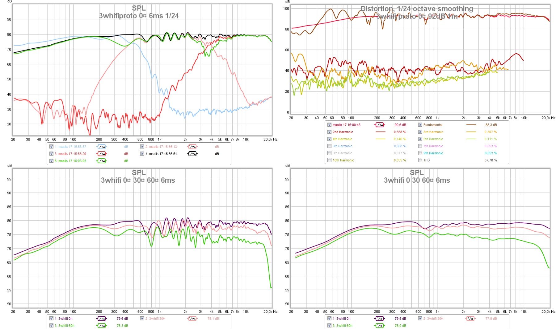

A new one. No idea of sensitivity, but I guess it is what is stated. Low distortion and good sensitivity is almost a challenge! I had 2 8" woofers and Fountek NeoCD3,5H too, minidsp xo LR4 slopes. Nice!
