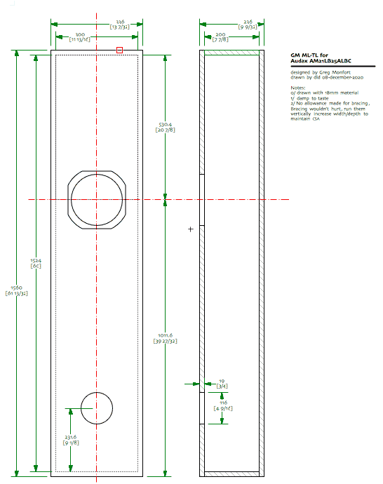

How about this:
Is this the design from the Rouault Acoustics website? My French is not so good, but it looks like it might have been designed by the same person who designed the driver. Can that be right?
Yes, this is the manufacturers data sheet design. It states that bracing should be placed in two places, but for some reason it does not say that on this diagram.
Dave, if you would recommend a MLTL for this driver what would it look like?
You say wider would be better, could one just modify this design and add bracing?

Scott designs the horns & TLs, i just draw them. He has been pinged.

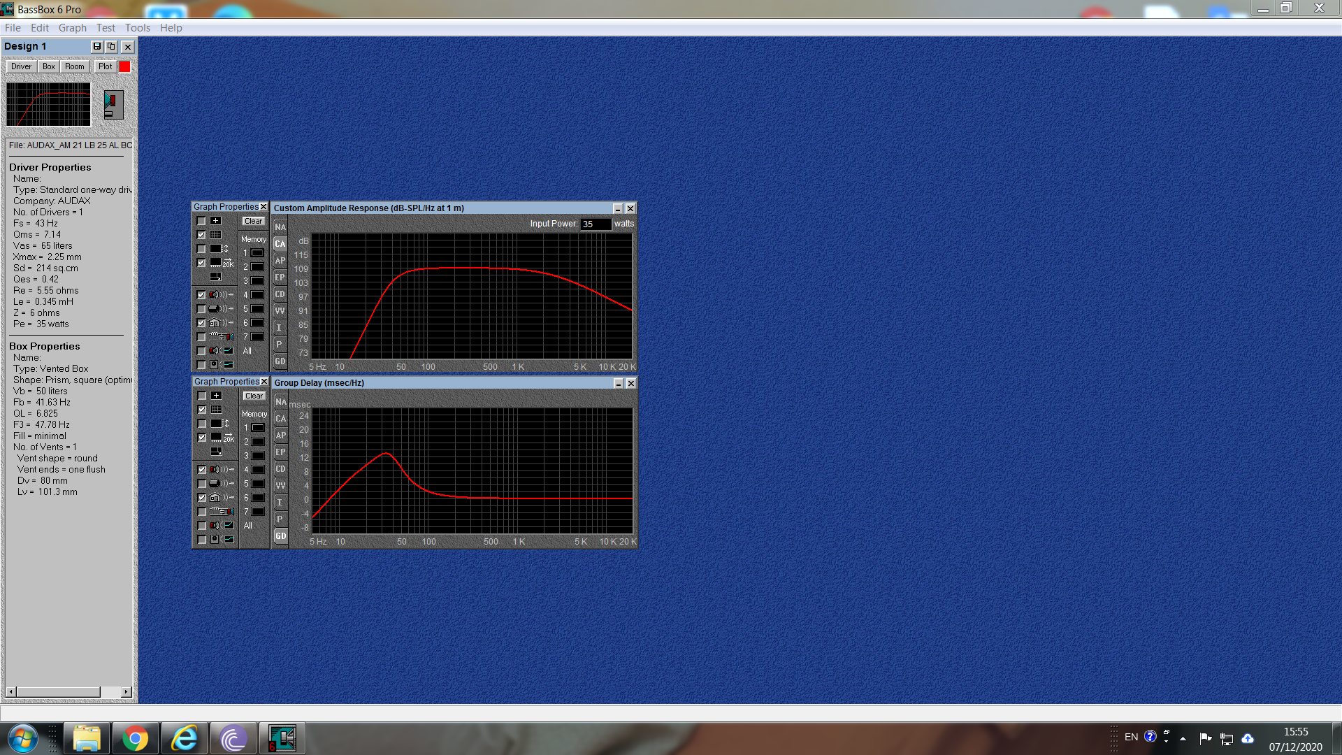

I thought it simmed great in the BR, MLTL I posted using Hornresp, but apparently not: Audax AM21LB25ALBC 8" Paper Cone Full Range new at Madisound!!
GM
GM
~42 Hz MLTL
Vb = 91.45 L net
L = 152.4 cm/60"
Am = 600 cm^2
So = L*0.349
Ap = 214 cm^2/33.17"^2
Lp = 1.9 cm/0.75"
Po = L*0.848
QC GM?

Just stumbled across this thread...
I remember the driver from the test/feature in HobbyHifi back then...
The case that planet10 suggested looks fine to me and will boost the lower midrange some (baffle step).
So it needs to be measured again in the final case (as always) and then you can decide about the neccessary network (notch filter).
The response has quite a dip in the upper midrange that will be even deeper when you try to adjust the bump @3.5kHz that most likely will be too "hot".
But a suitable notch will take care of that and can be adjusted to your liking by changing just the resistor (within reason).
I would probably also tame the rising response at 8kHz because the 30 degree response is rising as well...

QC GM?
Thanks! Looks fine to me except missing port offset [P0]: ~60*0.848 = ~50.88" [7/8"] down or ~9.12" [1/8"] up [i.d.].
What with all the different drivers available these days combined with folks wanting myriad HxWxD combinations, kind of surprised you don't have generic online drawings for the [3] basic [ML] TLs with A/B/C/etc., dims for us to just post a chart.

GM,
Vent was in the right position, just needed to ad the dimension. The picture in the earlier post updated and this is the pdf
http://p10hifi.net/forum/GM-AudaxAM21L-MLTL-081220.pdf
You can take any of my images and tweak them, i never start from scratch, this one started out fom an earlier A12 ML-TL you did. Scott does that all the time.
