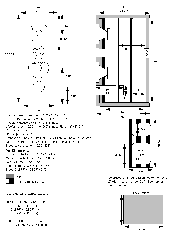

An MTM with the 6.5” bass driver. I have some speakers with that woofer (single woofer, wall mount) and it is one of the few loudspeakers i bought new. They ar decent, but that was in the mid ‘80s.
You have all the drivers, so i don’t see why not. But i would revisit the enclosure (first thing would be to orient the braces better).
dave
