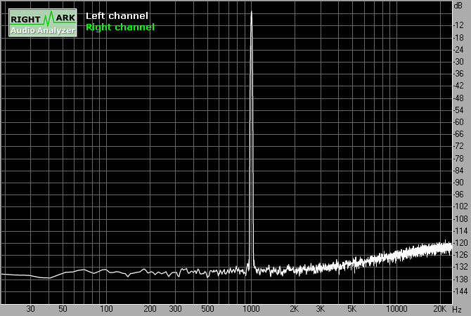

I recently generated a sine wave with audacity - 1kHz @ 96k sample rate. I then tested it with RMAA to determine the worthiness of Audacity as a sine wave generator. On the far right of the FFT there are some peaks which are probably results of sampling and digital errors. Does anyone else use Audacity to generate sine waves?

Keantoken, is this an fft plot of a wave file ? If yes, the quality is more than bad. How big was the wave file ? 1 second ?
The artefacts are likely to be jitter or resampling.

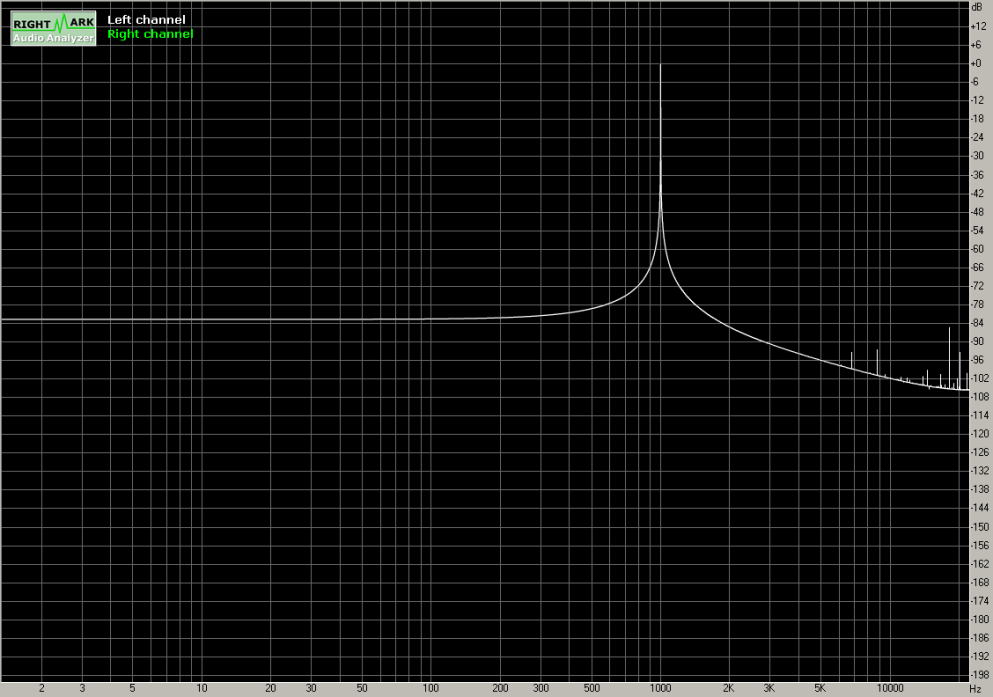

Attched is fft plot of 1khz/1sec/48khz-fs/16bit, kaiser window beta of 15. fft-window size reduced to 8192. (Created with goldwave)

I did not resample (to my knowledge).

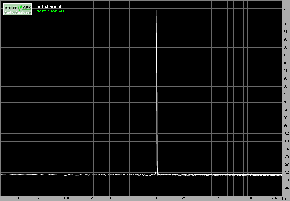

My sine waves were 30 seconds long.

With a 30sec sinewave you shouldn't have any problems... See attached file for fft of 30sec file.
About the dithering, you are thinking way too complex. Simply add white noise (output from a random number generator) to the signal (Scaled down to the scale of a single bit) before quantizing to 16bit.
And, don't rely on proper rounding from the FPU, it doesn't. You need to round yourself with (int)floorf(Val+0.5). Otherwise you get crossover distortion, as the FPU always rounds to the number closest to zero.
Another trap when generating a sinewave is jitter, caused by unaccuray of the float format when calculating the phase for the sinewave absolute instead of relative.
