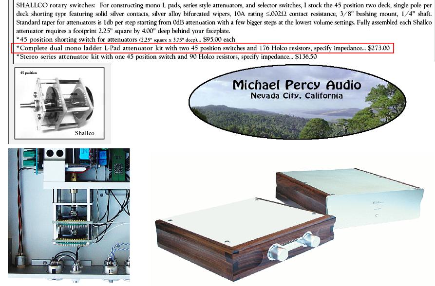

Allow me to make a small correction - I wrote $273 and not $237. This is the price of complete Shallco attenuators as stated at the Percy Audio webpage. If I'm not mistaken, this is the same exact type you use in your flagship Lyra (picture below). If I am mistaken, would you please explain what is "custom special" in your Lyra (which is a neat job, by the way).
My point is that John admittedly has a problem with the stuff he uses, which may be due to either TKDs or something far more serious...
Milan

I don't have a problem with TKD pots. I had heard about ONE complaint in the past. However, Bob Crump used to handle small problems like this, so there may have been more incidents, but it is next to insubstantial evidence to even think that I would build another attenuator that would have even more potential problems than the TKD.

Having worked on the retail and manufacturing side of the industry for the past four years I would hardly admit the oxidation of a contact as a problem. The fact that metal oxidizes over time does not mean that there is something wrong with his choice of parts or design in general.

Milan: Sorry, I must be getting dyslexic 🙂.
The Shallcos that I specify have all been multideck coaxials, and some of the contact pins have been relocated from what Shallco normally supplies. I also think that the decks are narrower than normal. And in general we keep grinding on them for better quality and better feel 🙂.
The so-called "flagship" preamp on our website is a Japan-only version (just like the 4-2SE is an export-only version), and is different from what I designed. The original 5.0 also had coaxials and a stacked, single knob, pretty much like a larger version of the 4 family. Our Japanese distributor wanted more eye candy and redesigned the chassis and the internal mechanicals for multiple knobs. Perhaps they also specified a more standard Shallco switch at the same time. I'm not sure.
