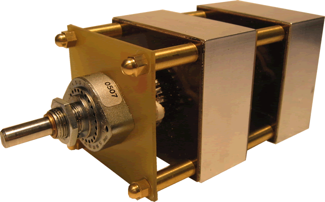

Hi Guys,
many thanks for that useful technical information and suggestion.
There remain some open questions about the transformer solution in my mind
I want to attenuate balanced signals, will the Auto-Transformer work ?
If a transformer is used to attenuate, what happens with the small DC Offset on the input ? I guess it will not transferred to the Output ? So it is possible to keep the Couple C out of the system ?
Regards
Marcus
DC offset is a problem for certain types of trafo - mumetal cored without an air gap are the most sensitive. Coupling caps recommended for these. I wind my own trafos on ferrite (SMPSU style) cores, they're only expensive in terms of time spent as the parts (enamelled copper wire, cores) are very cheap. They do have one disadvantage over the more expensive metal-cored ones - their primary inductance tends to be a bit on the low side, whether this is a problem in practice depends on the driving circuit. I haven't found it to be anywhere near a show-stopper and I air-gap mine which makes matters worse...😛
Thanks for you explanation. Could you give more details to understand what are the problem of DC offset ? Magnetization ? How many DC offset usually a problem ?
But at least the DC offset not tranfered to the output, or i'm wrong ?

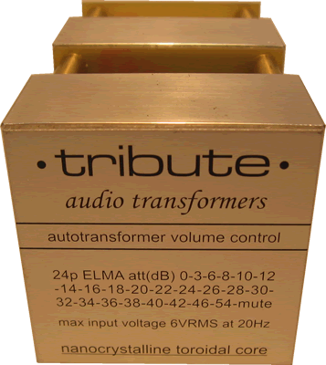

Contact Dave Slagle of Intact Audio....
I originally had a resistive volume control built by Ric Schultz. That device used a Vishay resistor in the signal path with multiple metal film resistors shunting the signal to ground. It was a very nice passive volume control.
I then tried an autoformer that Dave Slagle winds on a high nickel core. Wow, it was amazing. I am quite confident that it will beat any resistor-based passive volume control, and not by a little bit either. I recall that Kurt Strain took a pair of Slagle's autoformers to a guy's house to compare them to his $8000 preamps and by the reports, the two were about equal. The autoformer was more transparent and the active preamp was somewhat more dynamic. There are tradeoffs. But the Slagle autoformers are only a few hundred bucks for a pair. Not bad.....

Many thanks for share your experience.
A lot of positve reports about transformer solutions. It seems i need to build a µC / relay based tranformer attenuator 🙂
Someone has experience with the Swoter Transformator here ?
Core saturation so yeah 'magnetization' would work too.
Deoends on the trafo design and core material. Can be as low as a few mV.
Right, no offset possible on the output, after all the trafo just looks like a resistor at DC.
