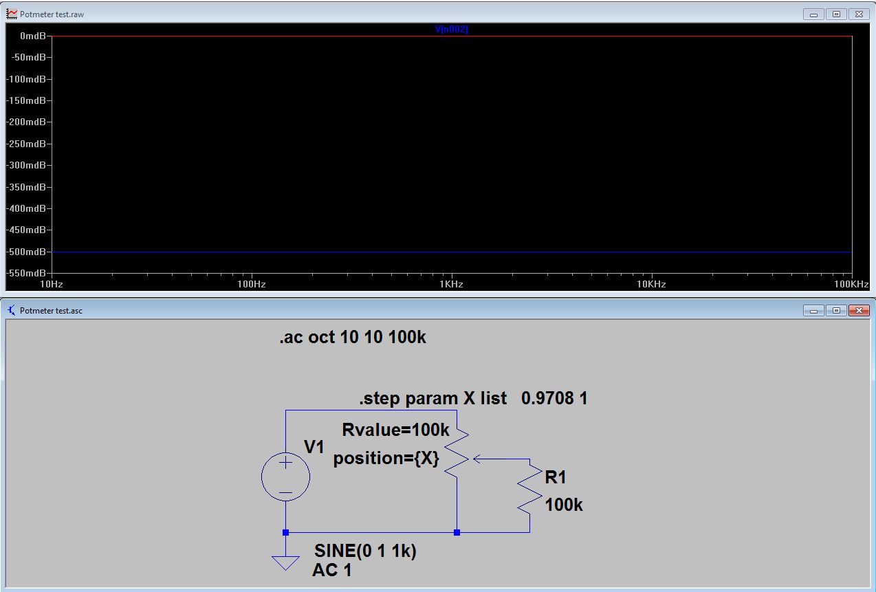

How can calculate the voltage divider to attenuate 0.5dBs, my tube preamp have an input impedance of 50K or 100K because I use two separate volume pots. Using L-Pad calculator:
50K L-Pad
R1 2796.96
R2 843828.8
100K L-Pad
R1 5593.91
R2 1687657.61
Can I use these values?
TIA
or just add a single resistor in the feed to each channel.
For a pot the required added resistance would be
{1 / [inv log (0.5/20 +-)] -1}* pot value
[1.05925-1]*50k or 100k
2963r for 50k or 5925r for 100k.
