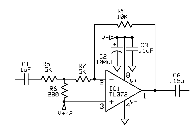

Attenuating Preamp Filter Question
In the attenuating preamp circuit below, what is the high pass filter frequency? I know with out the attenuating resistor (R6), it would be 16Hz, but I don't know what the R6 resistor does to it. My thought was, the R5 and R6 are in parallel, in series with R7, making it at 31Hz.
Thank you.
