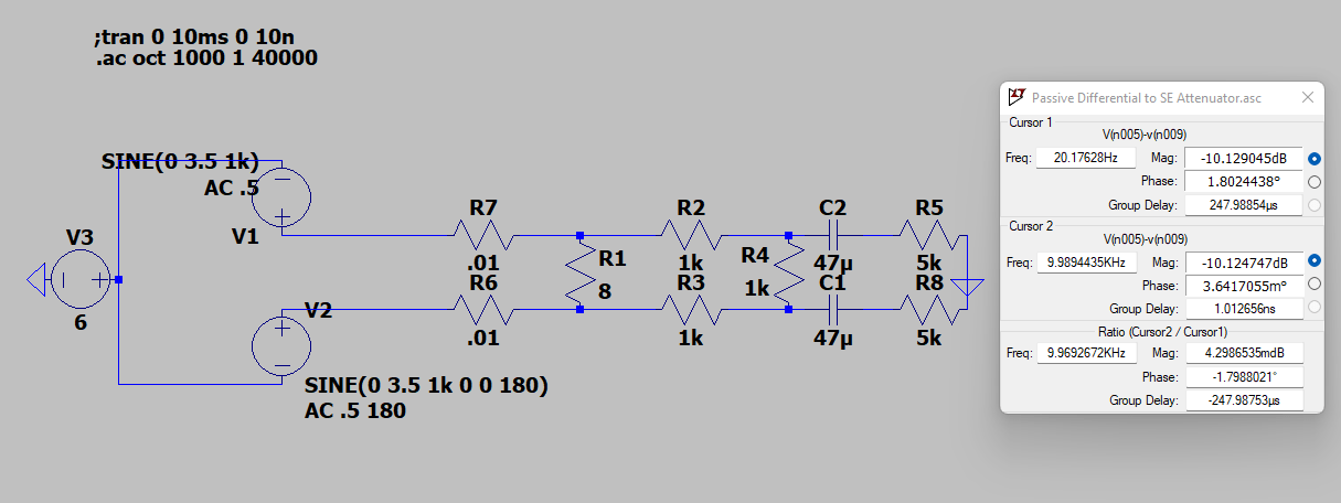

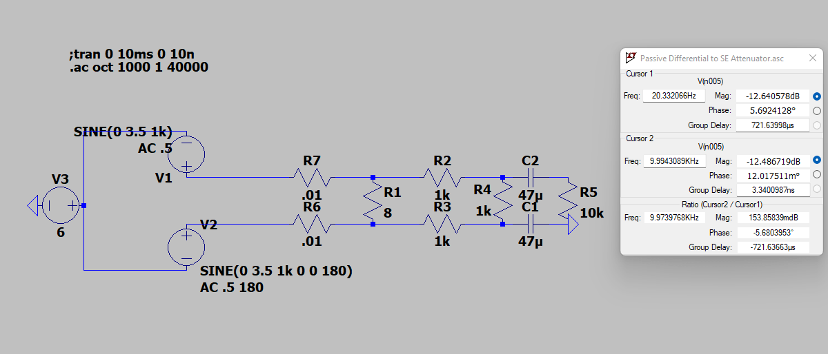

I made this circuit earlier before you said the unit had balanced inputs, so it's a single ended output. 12.5dB attenuation at most AF, -.15dB at 20hz, -.4dB at 12 hz. R1 is load resistor, R2, R3, R4 are the attenuation resistors, R5 is input impedance. Caps remove DC offset. I assumed 6V virtual ground on class D amp output but it doesn't affect anything to change that voltage (once the DC offset is removed). 3W at 8 ohms is 16dbu so this attenuates to 3.5dbu.

Thank-you dkFan9! The FR is very good as there is very little roll off compared to an audio transformer. BTW, the sound card accepts either balanced or unbalanced inputs, so the unbalanced circuit is still compatible. Is it much effort to adapt the design to balanced? I think I have all of these components on hand, so I'll try to assemble a breadboard tomorrow to test.I made this circuit earlier before you said the unit had balanced inputs, so it's a single ended output. 12.5dB attenuation at most AF, -.15dB at 20hz, -.4dB at 12 hz. R1 is load resistor, R2, R3, R4 are the attenuation resistors, R5 is input impedance. Caps remove DC offset. I assumed 6V virtual ground on class D amp output but it doesn't affect anything to change that voltage (once the DC offset is removed). 3W at 8 ohms is 16dbu so this attenuates to 3.5dbu.

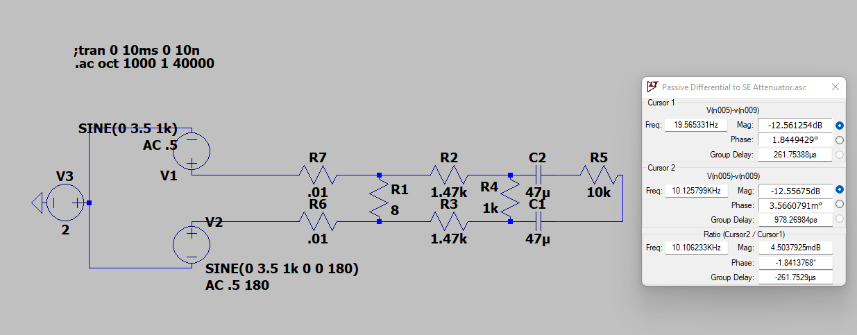

Thinking about it, I'm not sure what you should tie the ground pin to on the TRS on the source end if you go balanced, but frequency response in theory improves. Just increase R2 & R3 to 1.47K (put a 470 in series with 1k) for same attenuation. Leaving at 1k will work, just with 2.5dB or so less attenuation. Changes to input impedance will change attenuation.Thank-you dkFan9! The FR is very good as there is very little roll off compared to an audio transformer. BTW, the sound card accepts either balanced or unbalanced inputs, so the unbalanced circuit is still compatible. Is it much effort to adapt the design to balanced? I think I have all of these components on hand, so I'll try to assemble a breadboard tomorrow to test.

Thank-you! I will try the second balanced circuit as I should have the extra resistors for it. Yes, I was wondering what to do with ground on the source end as well. Tomorrow, I'll see what I can find.Thinking about it, I'm not sure what you should tie the ground pin to on the TRS on the source end if you go balanced, but frequency response in theory improves. Just increase R2 & R3 to 1.47K (put a 470 in series with 1k) for same attenuation. Leaving at 1k will work, just with 2.5dB or so less attenuation. Changes to input impedance will change attenuation.
