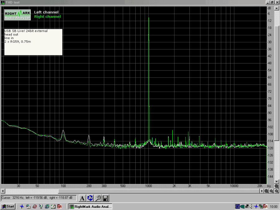

planet10 said:
It is typically 2nd & 3rd that make an amp sound richer. Higher harmonics are grating to the ear.
Here is an example of a spectrum that collapses to a low number, but has a scary amount of high order harmonics.
dave
Very sorry, this is nothing else than an example of a horrible amplifier. There is nothing like a spectrum that collapses to a low number.
Ahh, MikeB's Symasym 5_1 amplifier is "horrible", ok, I learned something new today!
Cheers Michael 😉
I should have known better and not post that chart... The peaks
above 10khz are also present without signal/amp, these are introduced
by the measuring, might be the soundcard, fft-window or something
else. The only valuable infos are h2-h7, where h7 is already at the
same level as measured without amp. (loopback-cable,-110db)
Also, i had written in my posting that the right channel has a defect...
The left channel (not well visible in this chart) has 15db less h2.
Okay, will continue building horrible amplifiers, these seem to sound best... 😀
Mike
The sound card - this is what I would expect. The RightMark itself is not a problem. We are collecting results of different soundcards and I know that the result can be much better than the one shown here.
For the reason you stated it is difficult to evaluate amplifier itself, so there is no much value in this spectrum. I would personally prefer not only higher harmonics to be lowered, but also H2 - H6.
I am attaching a result of another soundcard by RMAA. This was a loopback test as well, and I must say that it is much better to use an external high quality generator.

PMA, can you show a spectrum of an amp of yours recorded with that
soundcard ? Can you record at 96khz ? Most of the disturbances
started at ~20khz with my recording.
Can you also show freq-response for this card ?
Or you can mail it to me if you'd like.
Mike

However, we should not talk absolutes. How does 0.045% distortion at 20W and 20KHz seem, most of it H2/H3?
These figures obtained with an HP339A.
Would this muddy Mahler?

I have to disagree. H2 and H3 applied to more complex music will create disharmonic components, nothing like "full and rich" sound. The result is melting and confusing sound.
