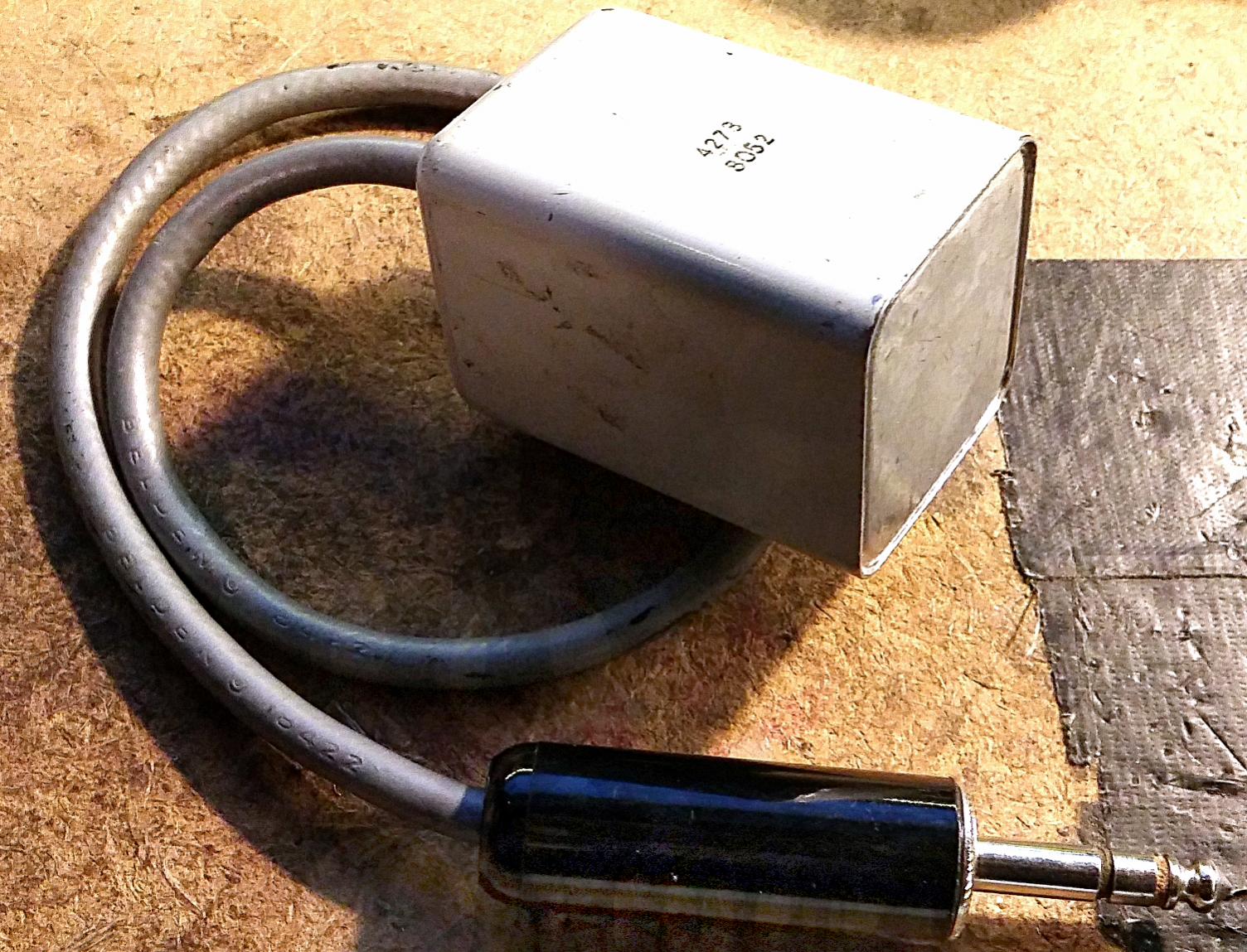

I picked up a box of misc swag from a garage sale and acquired this attachment (pics below) that I have no idea what it is. It measures 16k ohms at the tip and 32k ohms at the ring, but I can't get it to do anything. I plugged it into the input of an amp thinking it might be a transducer but got no sounds. Then I thought, hey it's probably a transducer
and plugged it into a speaker jack, played some music, and started touching various solid objects thinking it might transfer sound... but got nothing there either. So it's either broken or I just have no clue how to use it / don't have what it hooks into. Anybody have any idea what it is?
Thanks in advance!

Maybe a dummy load for an input.
Yeah that's what a few fellas over at the Gearslutz forum thought as well. I'm used to dummy loads on outputs where the ohms would be much lower. I think I'll crack it open and take a peek.
Thanks for the reply
Have you tried applying a small AC voltage (say 10 - 100mVrms @ 1kHz) between tip and sleeve and seeing what if anything appears on the ring relative to sleeve?
Perhaps this is an audio transformer of some sort? Or something entirely different.

No, I haven't tried applying any voltages to it. I don't have a variable AC source I could do that with.
use a fixed resistor attenuator to reduce the signal from a CDP or DVD or a PC.
10k+1k gives ~-20dB
10k+100r gives ~-40dB to ensure a maximum signal of 2.2Vac is never more than 22mVac at the input to the signal transformer.
Pano gave you a couple of calibrated test signals that you can copy to a CD.

OK, it took me forever. Unfortunately I destroyed it in the process. And still have no clue what it was used for. 😕
Here's the outcome:
https://youtu.be/dVWDf91x0DQ
Speculations?
