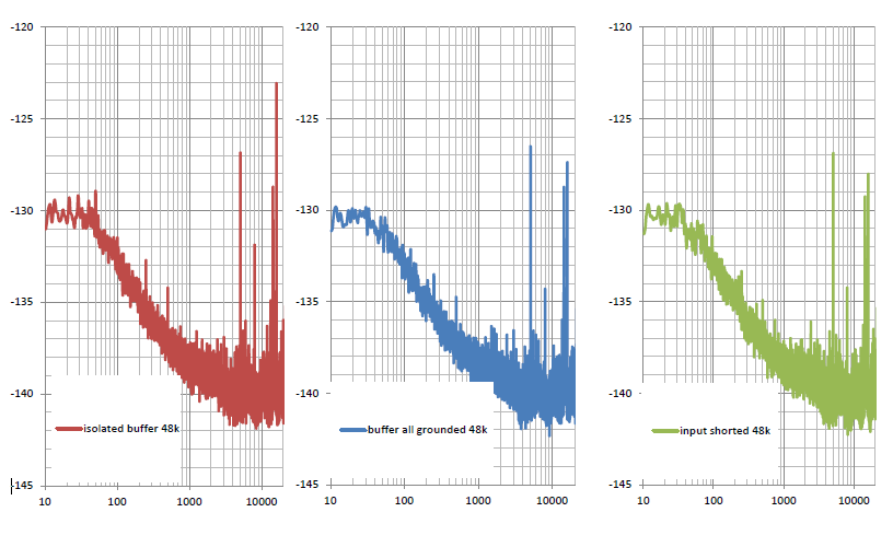

I did some measurements on a low gain preamplifier in two configurations.
The dut is a 4 channels buffer preceeded by a 4 channels 10k pot. The buffer is mad with 2* 2 channels AD712 AOP.
The "pcb" is a double sided test board with ground plane on top.
The "normal" config is : power supply ground connected to box (steel) ground connected to audio ground.
PCB ground plane is connected to the box by 4 brass spacers , input and output RCA grounds are connected to the box, power supply (+15 0 -15) ground is connected to the box, the 4 "cold pin" of the pot are connected together to the box.
The isolated config : pcb, supply ground, rca, pot disconnected from the box.
For the measurement, input preamp is grounded before the pot which is in max attenuation position.
I used a sound card (Terratec DMX 6 fire usb) with a 48kHz sampling frequency and I record a shorted sound card signal.
On the plots, the isolated config (1) is in red, all ground to the box (2) in blue and the SC shorted input (3) in green.
The difference between are not very important but we can notice :
There is a peak at 50Hz (~1.5dB) in config 1 not present in the other ones
Another one at 250Hz in config 1, also present in config 2&3 1dB smaller
Another one at 500Hz in config 1, also present in config 1&2 0,5dB smaller
The peaks at 5kHz are ~the same.
Peak at 8kHz is smaller by more than 1.5dB in config 2&3
Peaks at 14,4kHz are ~the same.
Peak at 16kH is smaller by more than 3dB in config 2&3.
Preliminary conclusion : Connecting the audio ground to the chassis of a low gain preamp is a very very bad idea !
It is simpler than isolating all the connectors, ground plane etc.. to the box
It is more quiet than isolating, and it is not worse if box is in plastic.

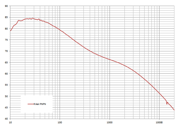

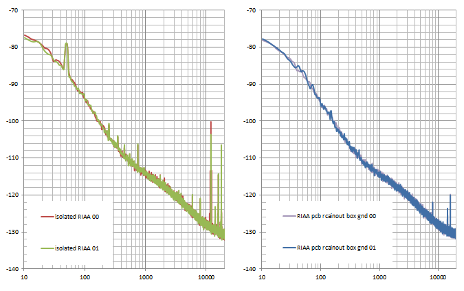

I also did measurements on a high gain preamplifier.
Preamp is a discrete MM Phono stage, gain is ~66dB at 1kHz.
Each channel has its own double side pcb with complete ground plane on top.
The normal config is :
power supply (+15 0 -15) ground (5 pin DIN connector) connected to steel box on one side
each ground plane connected to box with 4 metal spacers
output connector ground connected to the box near the power supply connector
input connector ground connected to the box on opposite side
Isolated config :
all ground disconnected from the box
The first plot show the response of the preamp with pseudo random pink noise in "normal" config.
Spectrum are done with input grounded with a shorted RCA plug, average on 100 acquisitions.
Isolated config is on left (red & green).
Normal config is on the right (gray & blue).
Results are clearly better on what I called the normal config where all ground are connected to the box in order to benefit of the steel box shielding and of the low impedance ground path.
As for the low gain preamplifier, connecting all ground to the box is simpler than isolating and work at least as well as the isolated way.

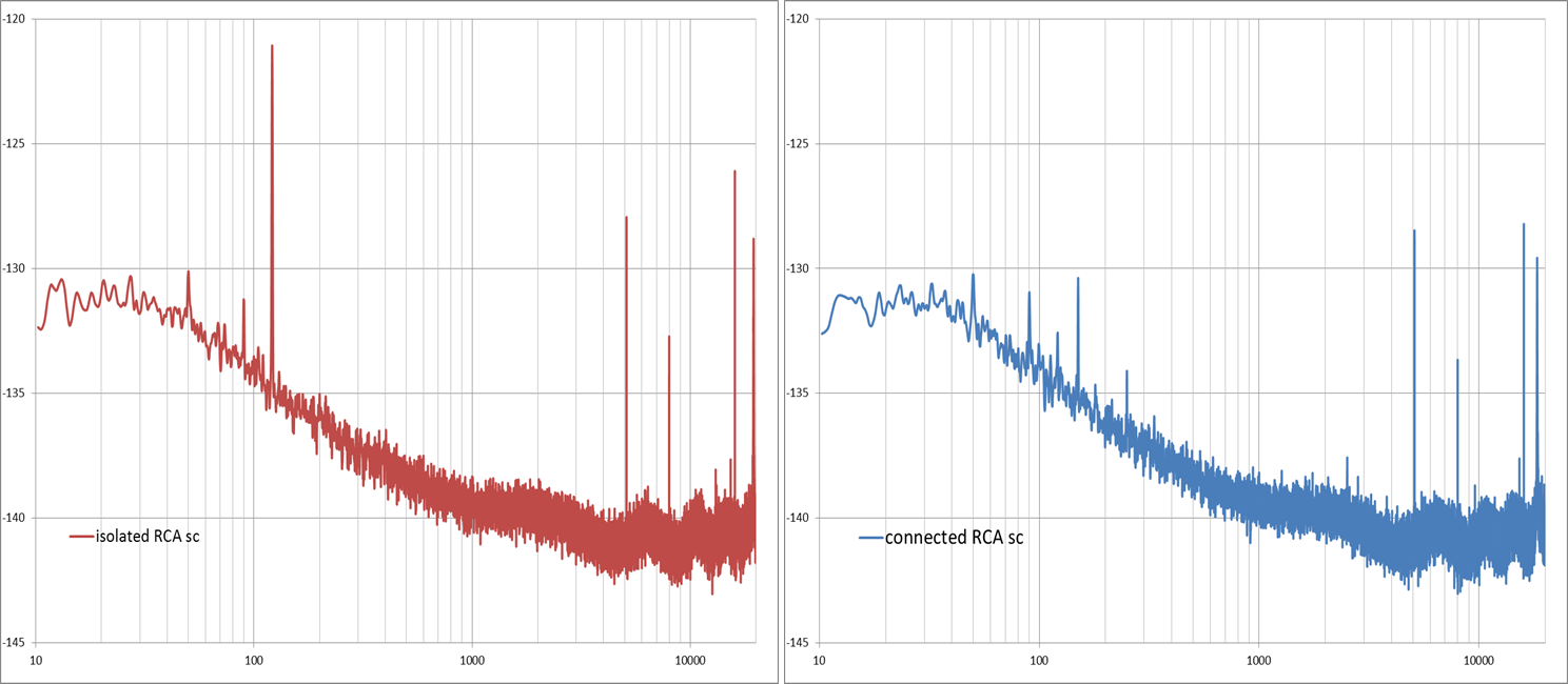

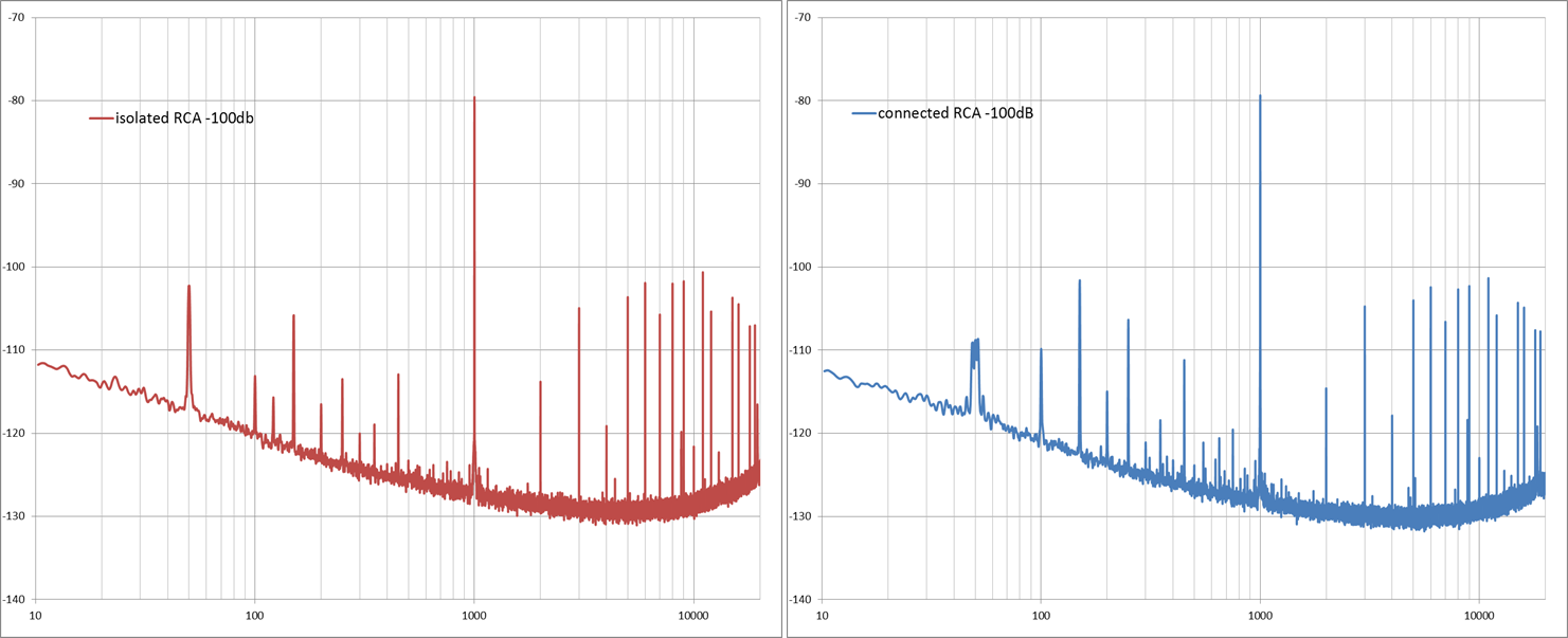

I finally did a third set of measurements with a modified "isolated" configuration closer to "classical" version.
Circuit is a dual ~20dB gain amplifier with opa134 aop, pcb is a double side test board with ground plane on top.
Isolated version : Steel box is connected to power supply ground on one point at power supply connector level. PCB is mounted with isolated spacers and connected to ground on one point. Output RCA ground connectors -on power supply side - and input RCA ground connectors -on opposite side- are isolated from the box.
Connected version : PCB is mounted in the steel box with metallic spacers, then connected to the box, input and output RCA ground connectors are connected to box and to ground plane.
Two measurements have been performed :
1) spectrum with a -100dB input signal level
2) spectrum with shorted input, with a shorted RCA plug.
Power supply is smps +/- 15V. A signal generator, a scope and a solder iron are on at ~50cm of DUT
Results : "classical" config is in red, "all connected" is in blue.
1) -100dB input :
1kHz is at same level ~-80dB
50Hz peak is greater by ~7dB on "classical" (-102, -109dB)
100hz peak is greater on "all connected by 3dB (-113, -110dB)
a 121Hz peak ( -115dB) is present on "classical", not on "all connected" (-123dB)
150Hz peak is greater on "all connected" by 3dB ( -105, -102dB)
The 2 main differences are at 50Hz and 120Hz at the advantage of the "all connected" version.
2) shorted input
50Hz peak is at same level (-130dB)
90Hz peak is ~at same level (-131dB)
120Hz peak is greater on "classical" by 10dB (-123, -133dB)
Once again, the main difference is at the advantage of "all connected" version.
Conclusion : "all connected" ground strategy including ground connection to chaasis works at least as well as all other ground cabling methods.
