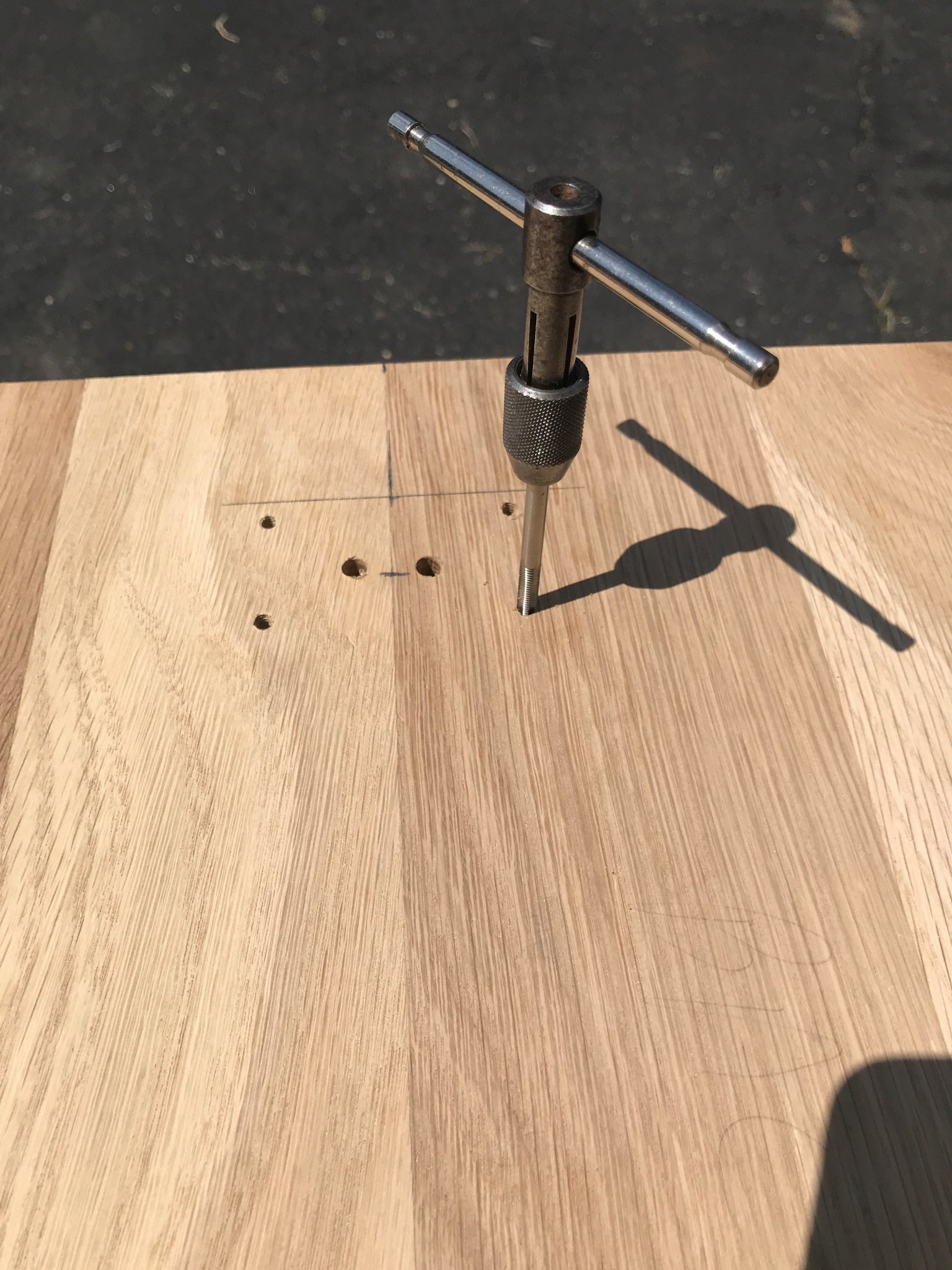

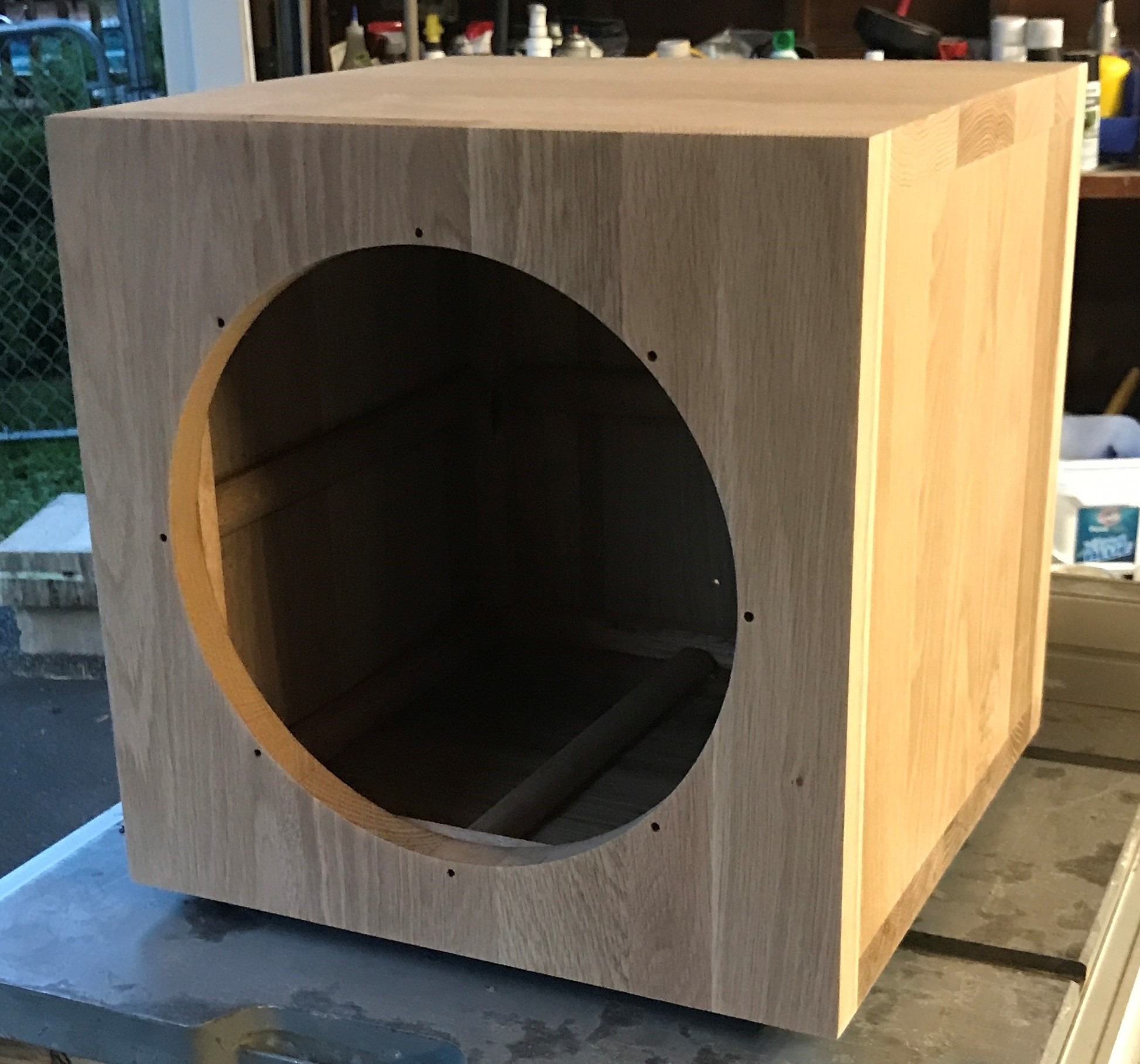

Use oak for the parts of the box that receive the screws from the front baffle, then drill and tap the oak for a fine thread machine screw, like an M5 or M6 x 0.75.
Make the tapped hole about 15 mm deep and you will have a very strong, durable joint that's easy to open. This is easier than t-nuts and takes less space. Oak is incredibly tough and takes machine screws very well. Photos are from my last sub project for the rear connector plate and to mount a 12" subwoofer that weighs 11 kg. I have also tapped plywood and MDF for machine screws with no problems, but obviously they are not as strong as oak. Gave up on wood screws for speaker construction a long time ago.
