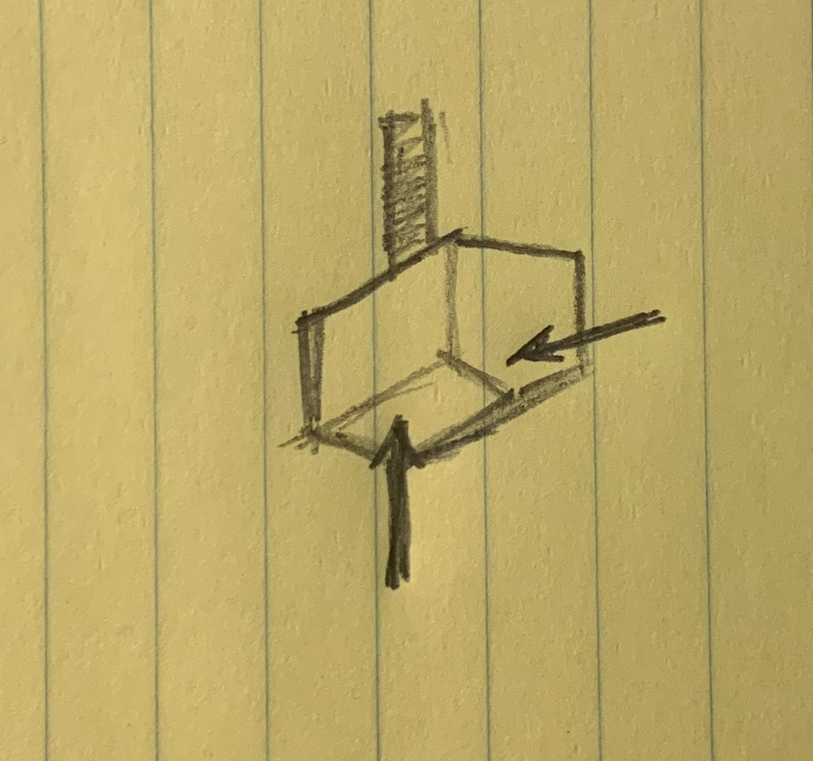

Paddles. Now that's another thing. Ideally, damping would involve a sheet of zero thickness slicing through the fluid with no sideways disturbance, thus providing damping force proportional to fluid viscosity. But a thin sheet will ring. An aerofoil shape would be better. Worse, traditional unipivots immersed a ring well below the pivot point so that rather than slicing, it moved from side to side and slopped the fluid around. Scarcely ideal.
In my opinion, it is not necessary to have a paddle with zero thickness. I don't think it will produce sideway disturbance at such a low speed. An aerofoil shape may defeat the purpose of a damping paddle. For a uni-pivot arm, there are many ways to design the damping mechanism.Paddles. Now that's another thing. Ideally, damping would involve a sheet of zero thickness slicing through the fluid with no sideways disturbance, thus providing damping force proportional to fluid viscosity. But a thin sheet will ring. An aerofoil shape would be better. Worse, traditional unipivots immersed a ring well below the pivot point so that rather than slicing, it moved from side to side and slopped the fluid around. Scarcely ideal.
For my air-bearing linear arms, I designed the paddles as it in the image. First, I used plastic. The reason to use plastic is to utilize the highly buoyant force of the plastic. Another consideration behind this design is to treat vertical and lateral damping equally. The shape of the paddle is to utilize lateral force and vertical force as well.
