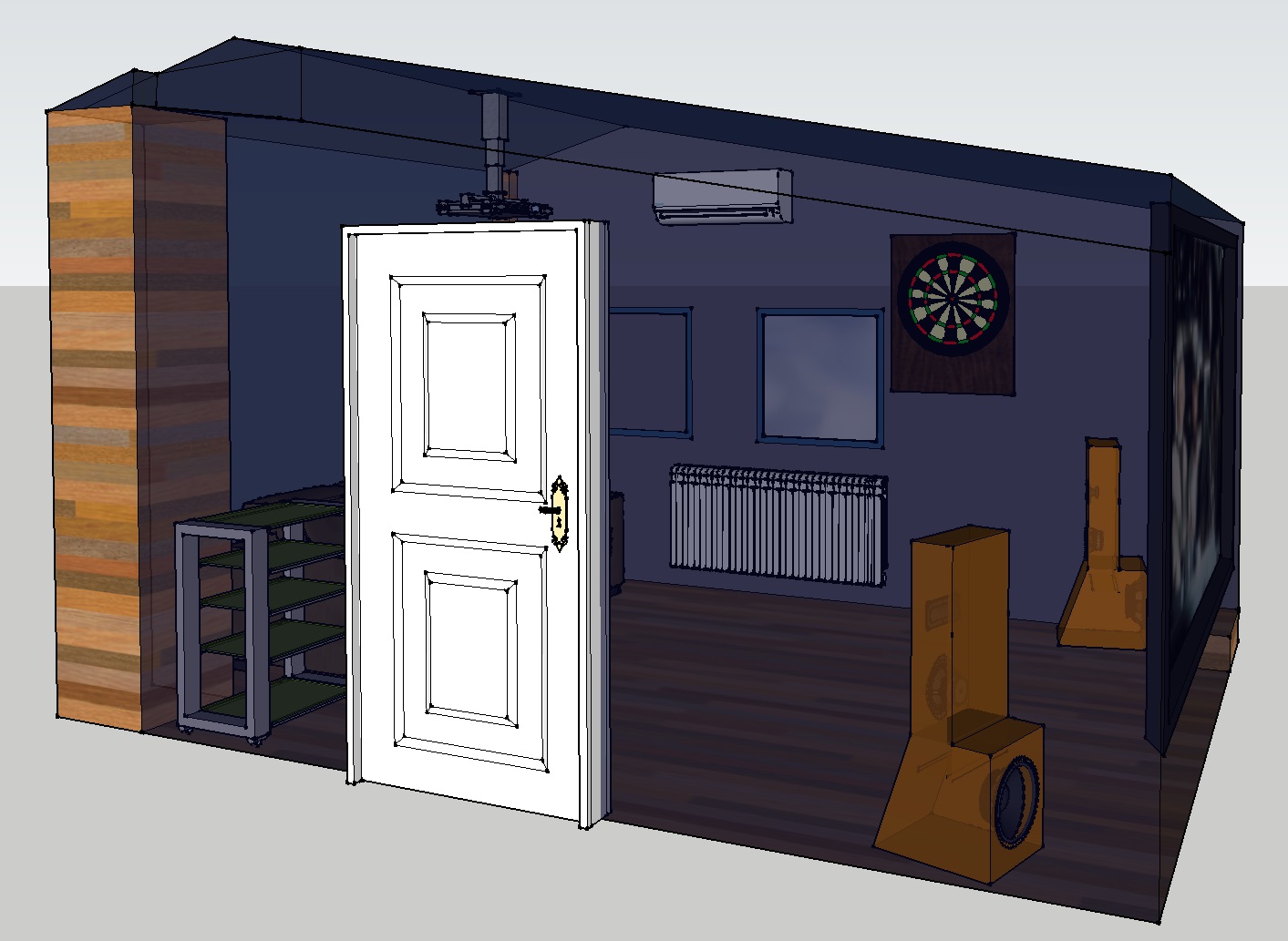

We live at the last floor of a 4 story concrete building. Our flat is also two-story inside and the room is in the second floor. The room size is 4.4 x 3.2 meters (15x11 feet), have two sloped ceilings (2.5 meters to 2.75 meters and then dropping to 2.1 meters) and a concrete beam + column on the right side. You can see its model in the attachment.

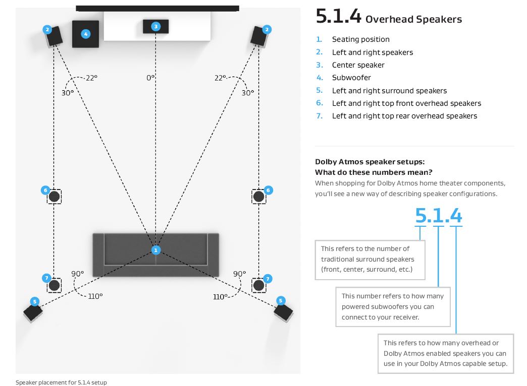

I am thinking a 5.1.4 system and have been reading on avr selections, speaker placements, speaker selections, acoustics treatments, etc. and lost myself.

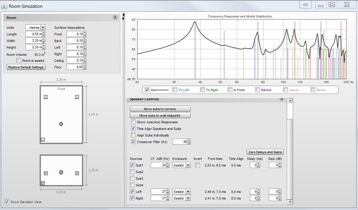

And finally, I checked Room EQ Wizard's room simulation and I played with different configurations. The best I can come up with is attached... What are my options to make the frequency response as flat as possible? I tried various speaker locations, added two subs, changed crossover settings, etc. in the simulation.
