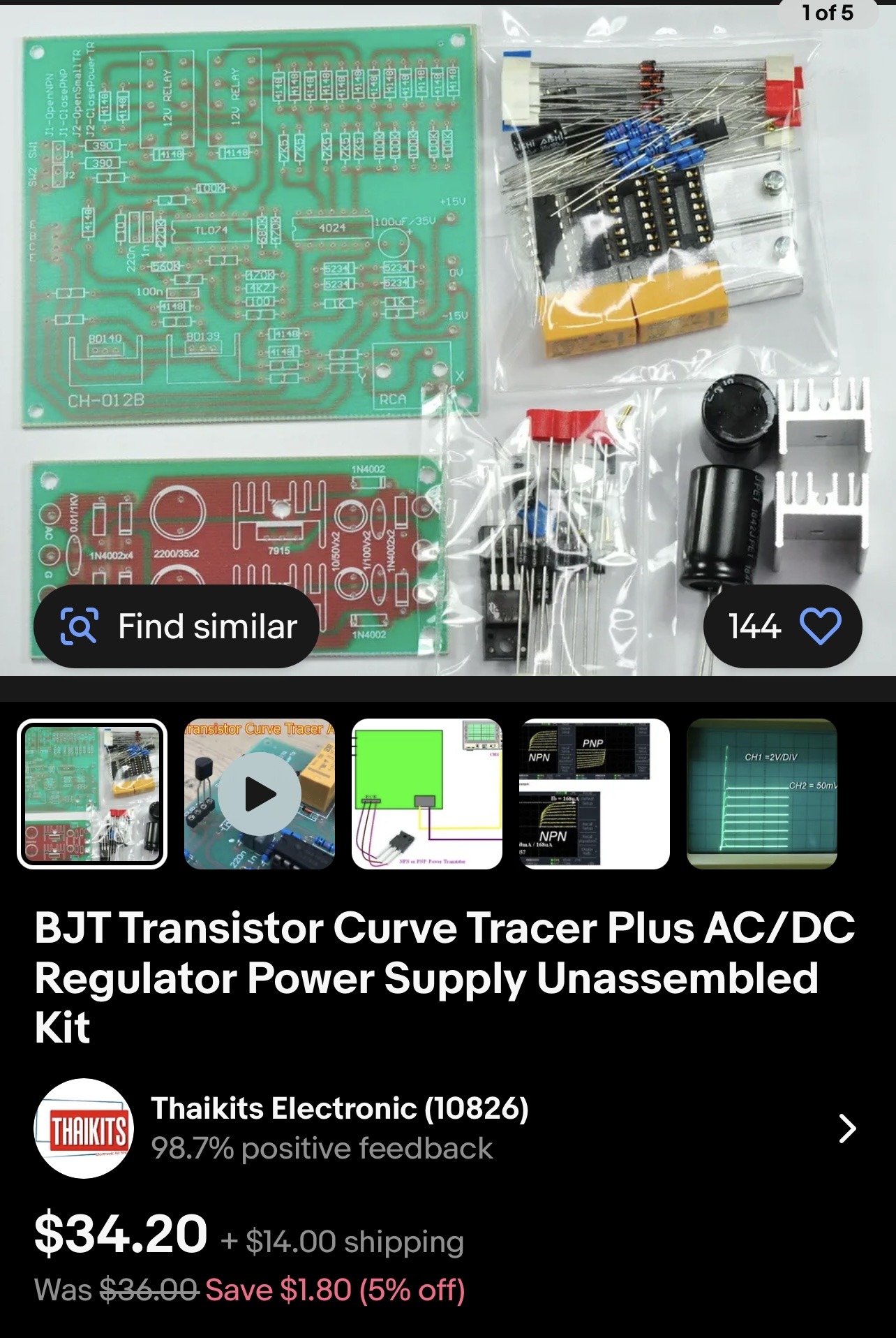

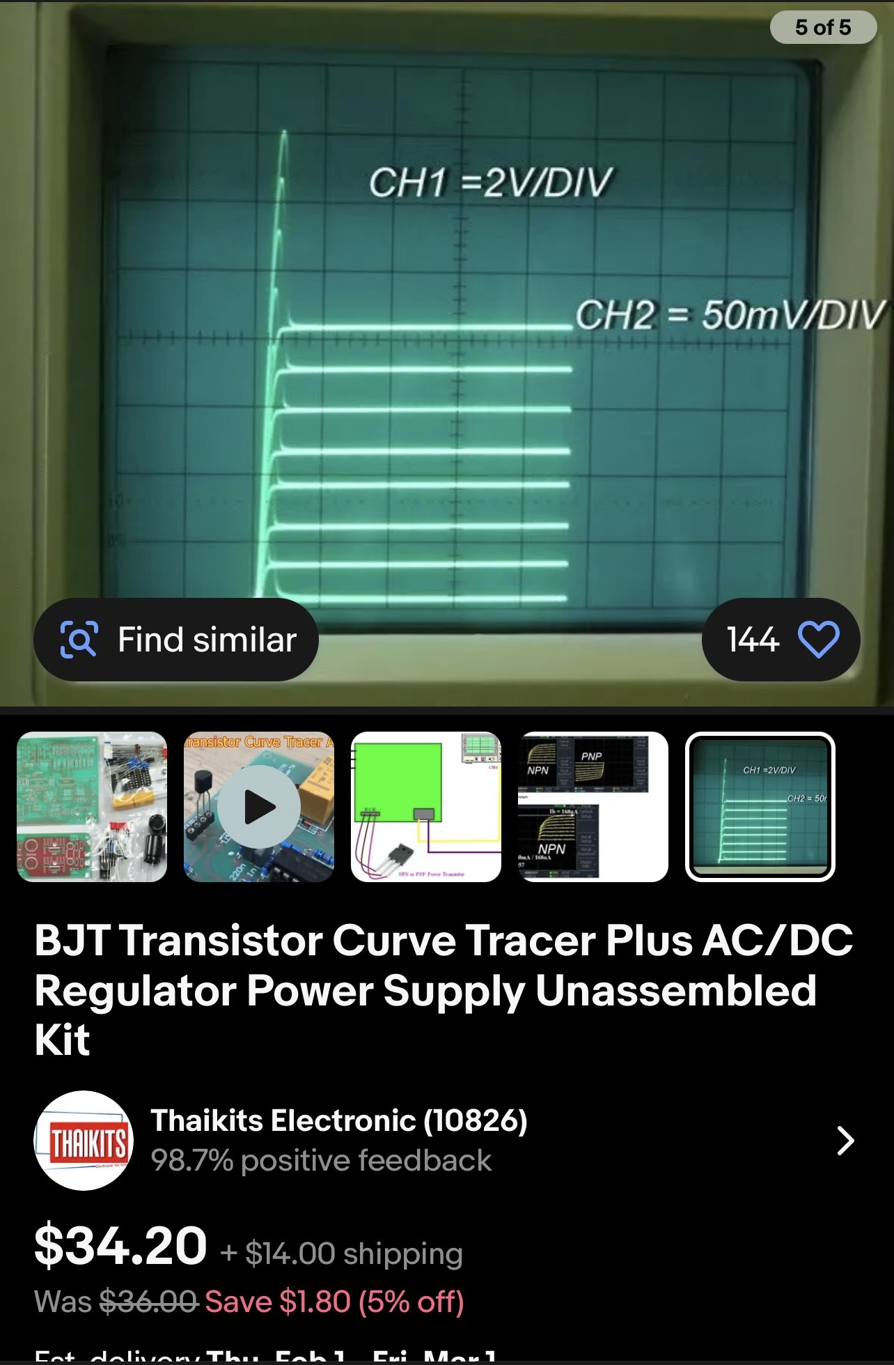

There are some Tektronix options, but be prepared to spend some decent money. I have used it yet as I am still waiting to receive it, but there is a guy out of Thailand selling these curve tracer kits. It tests higher, up to 2.24 mA I believe. I’d like to find a kit like this that will do higher voltages.

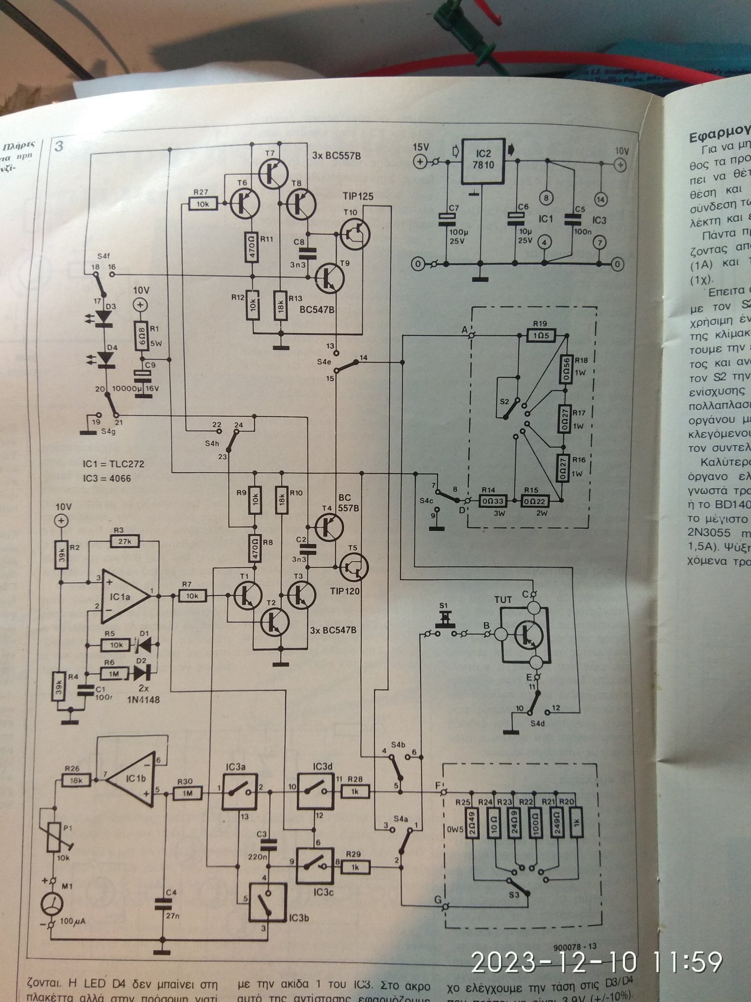

I remember two circuits published in Elektor.
Both for high voltage,high current.
One for bjt and the other for fet.
Not curve tracer but analogue mA mreter.
The bjt version.
