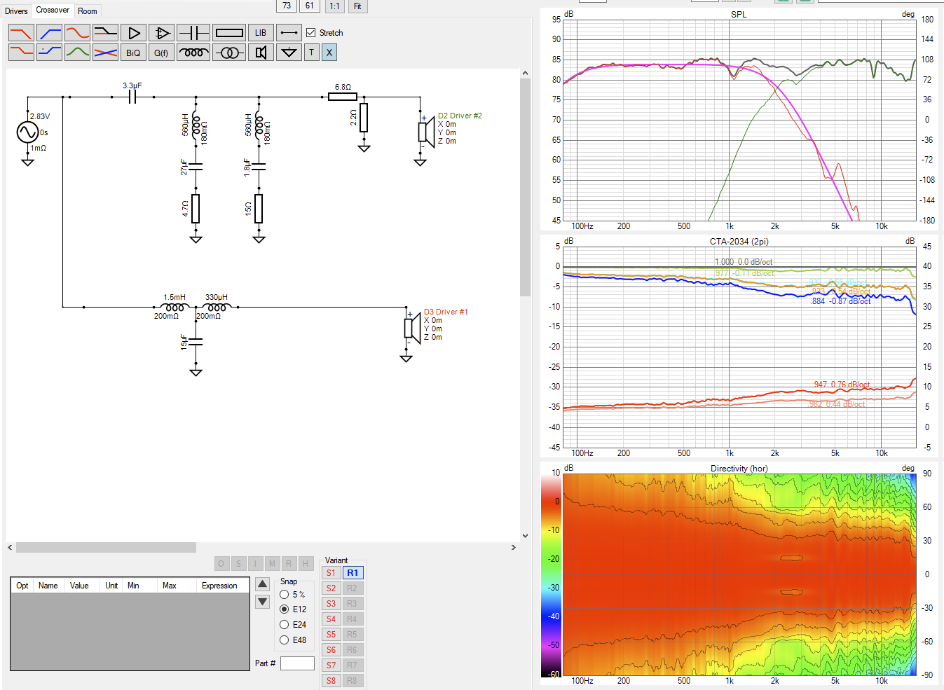

Wouldn’t take me long to narrow down on a wider pattern. Aiming for 5 watt ish for 96dB 60-20k.

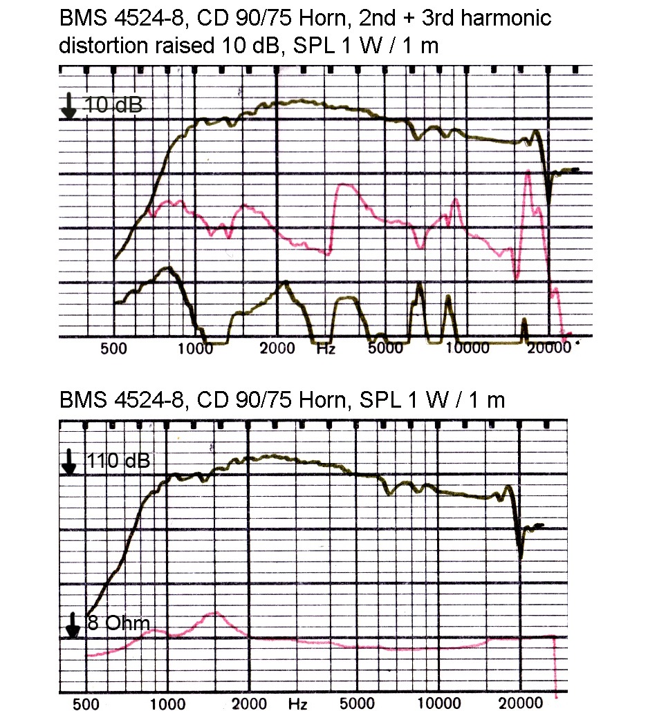

“Budget CDs” and “Budget Woofers” so far …
1in BMS 4524
https://www.bmsspeakers.com/index.php-101.html?id=bms_4524
1in Sica CD 78 26 245
https://sica.it/prodotto/cd-78-26-245/
1in 18sound HD110
https://www.eighteensound.it/en/products/hf-driver/1-0/8/HD110

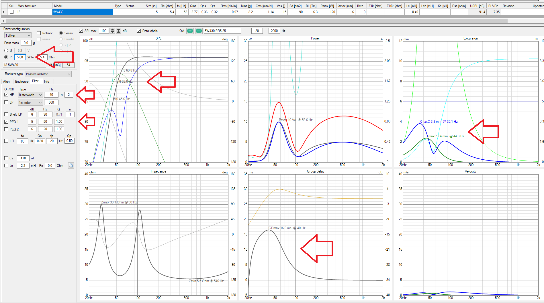

5in 18sound 5W430
https://www.eighteensound.it/en/products/lf-driver/5-0/8/5W430

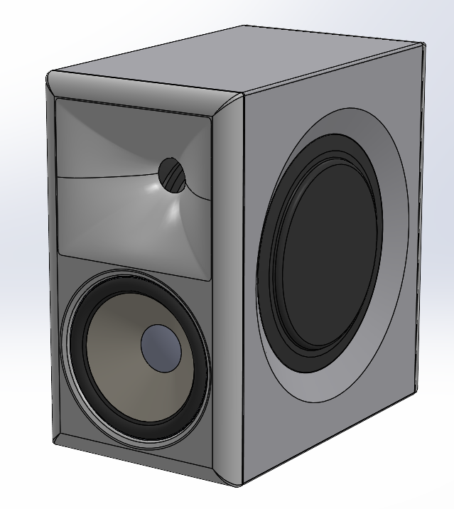

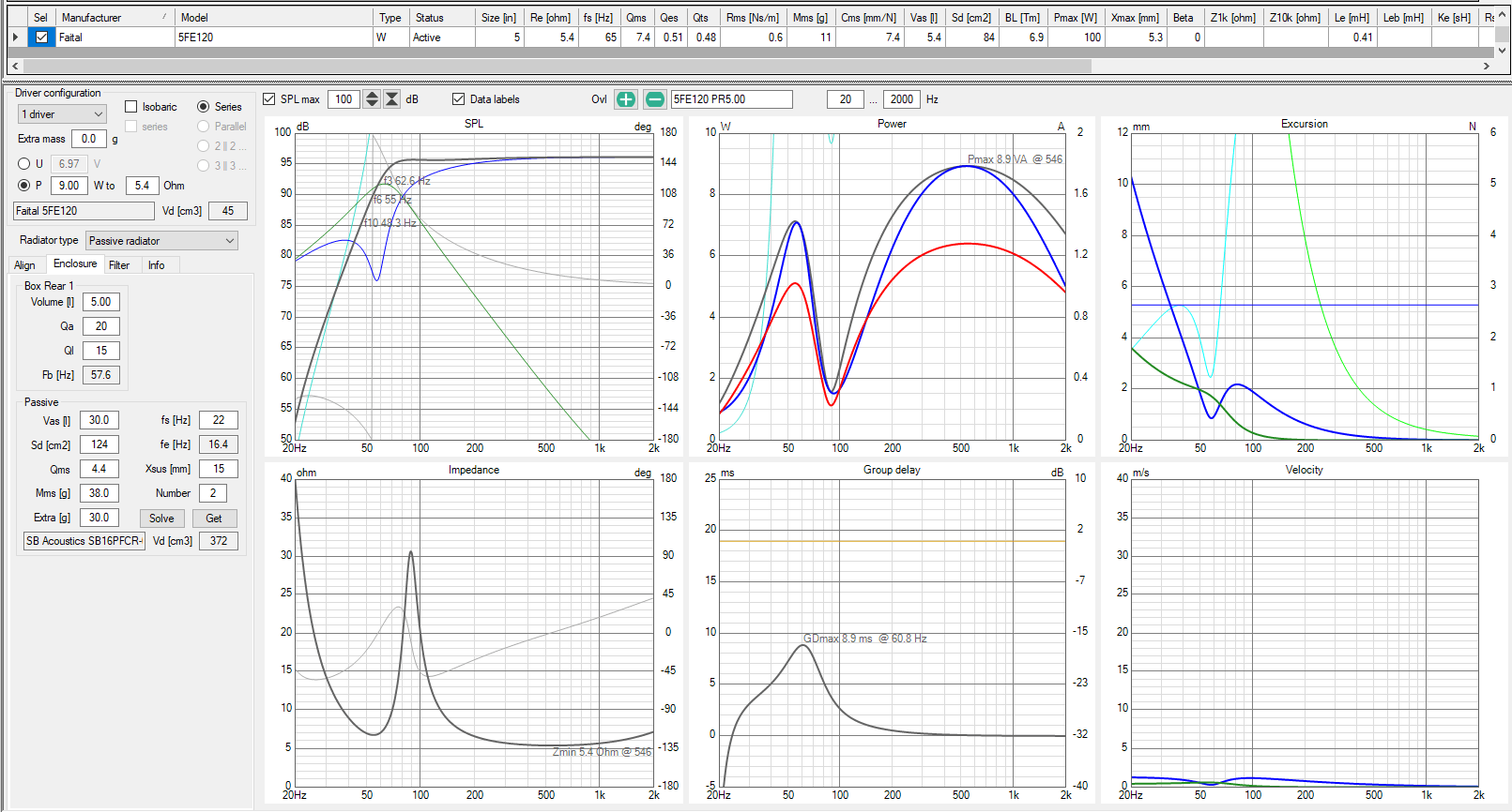

Two passive radiators, SB or Peerless 830878. Looking for the best C/Q values. There are some inexpensive woofers that fit that bill too that could be modified to be PRs. Or cone debonded and moved to a new machined spider in the cabinet side walls.
High pass and 1 eq should allow 60Hz f3 with ample excursion to spare?

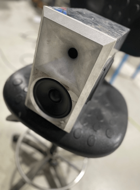

When I was looking for 5" woofers I've settled on the Sica Z002655. Larger coil, Bl, Xmax spec seems more elaborate than usual. The surround is accordion style, it continues as a flat rubber ring over the frame as if it could serve as gasket for this type of mounting, but I don't have much experience with building stuff. It's not on their web site, would be nice if it's still in production.
You want to do a full routed aluminium housing but compromise on driver quality?

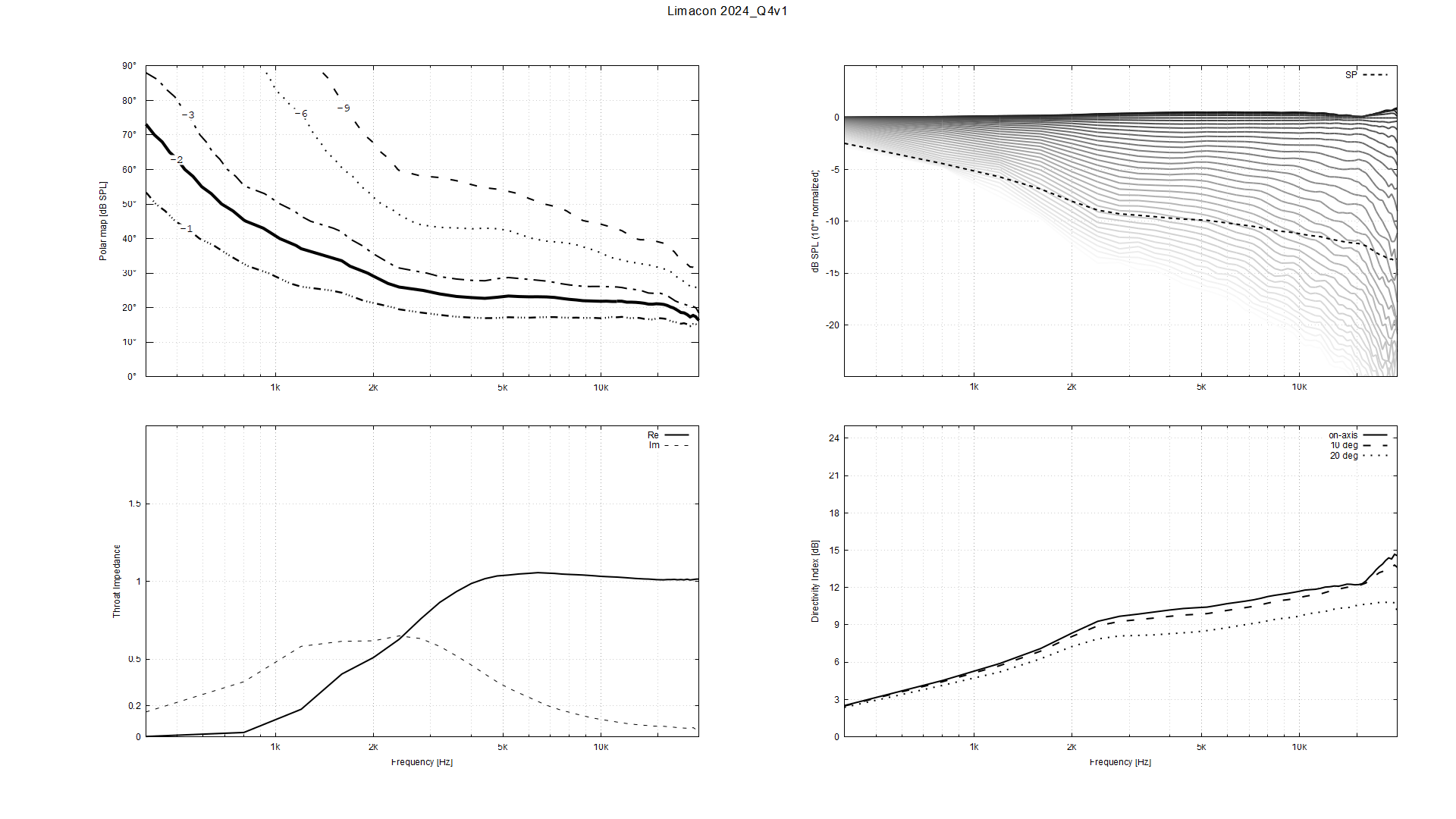

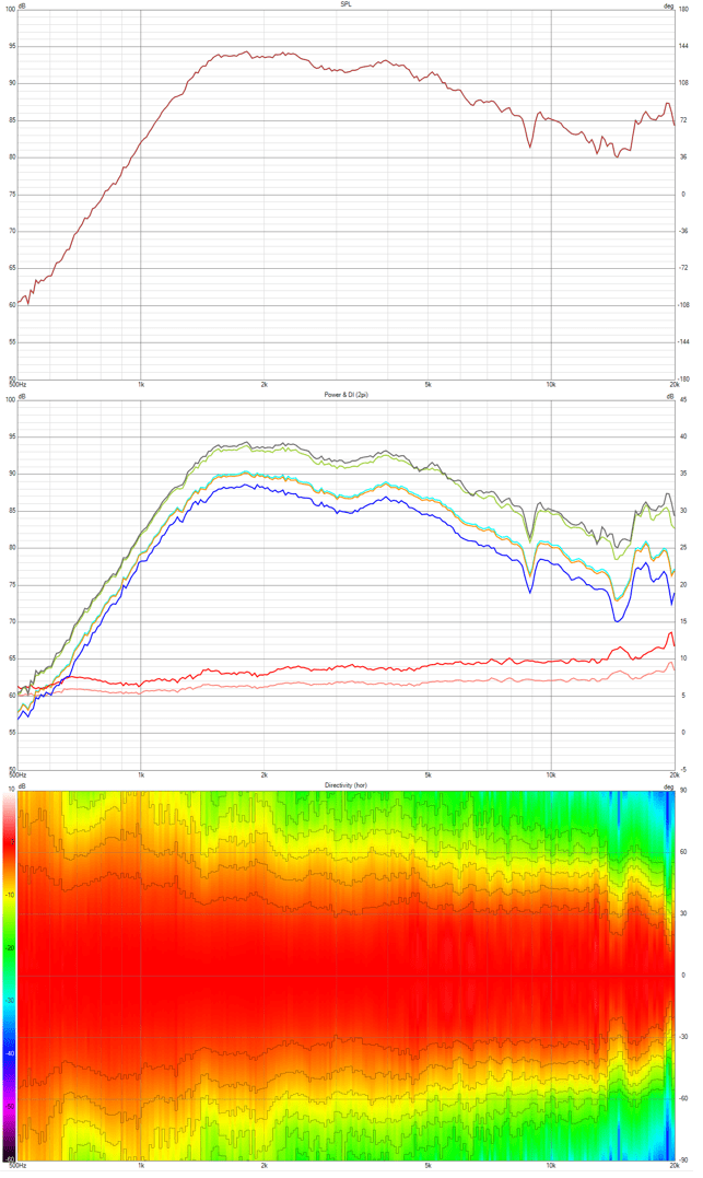

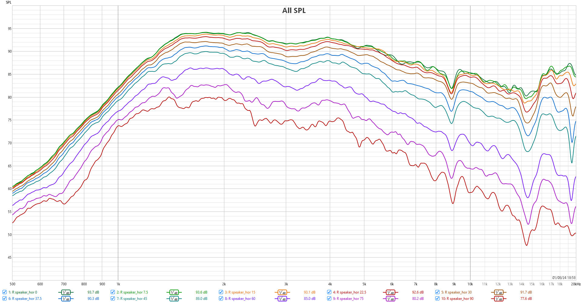

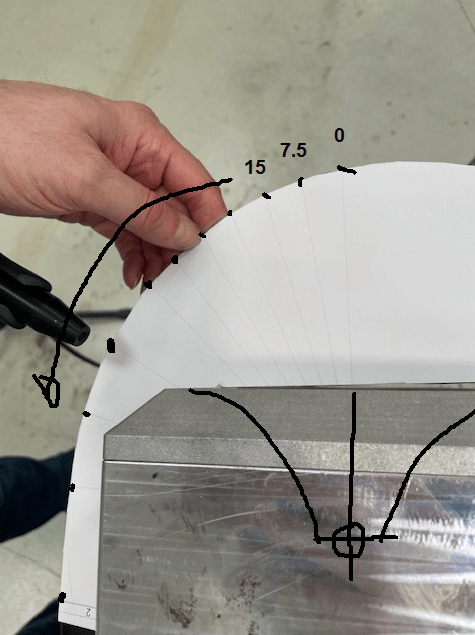

I’d like to think it is misalignment of the driver to the waveguide but there is something in official charts too.
Hi limacon, looks good. Btw, anyone has good explanation why there is small undulations on the response increasing further off-axis? panel radiating sound making interference appear? period seems very short though, or random, so perhaps multiple things, like something in measurement jig turning with the speaker. or what?
@tmuikku nothing yet.

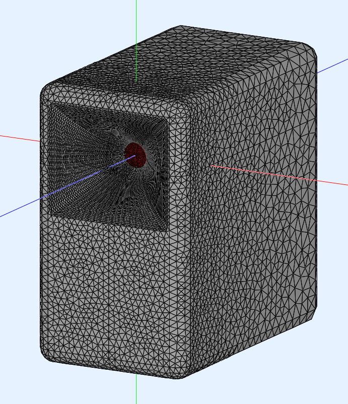

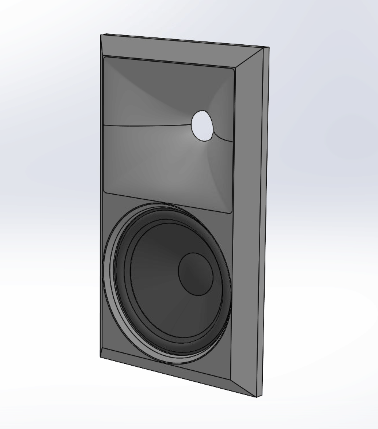

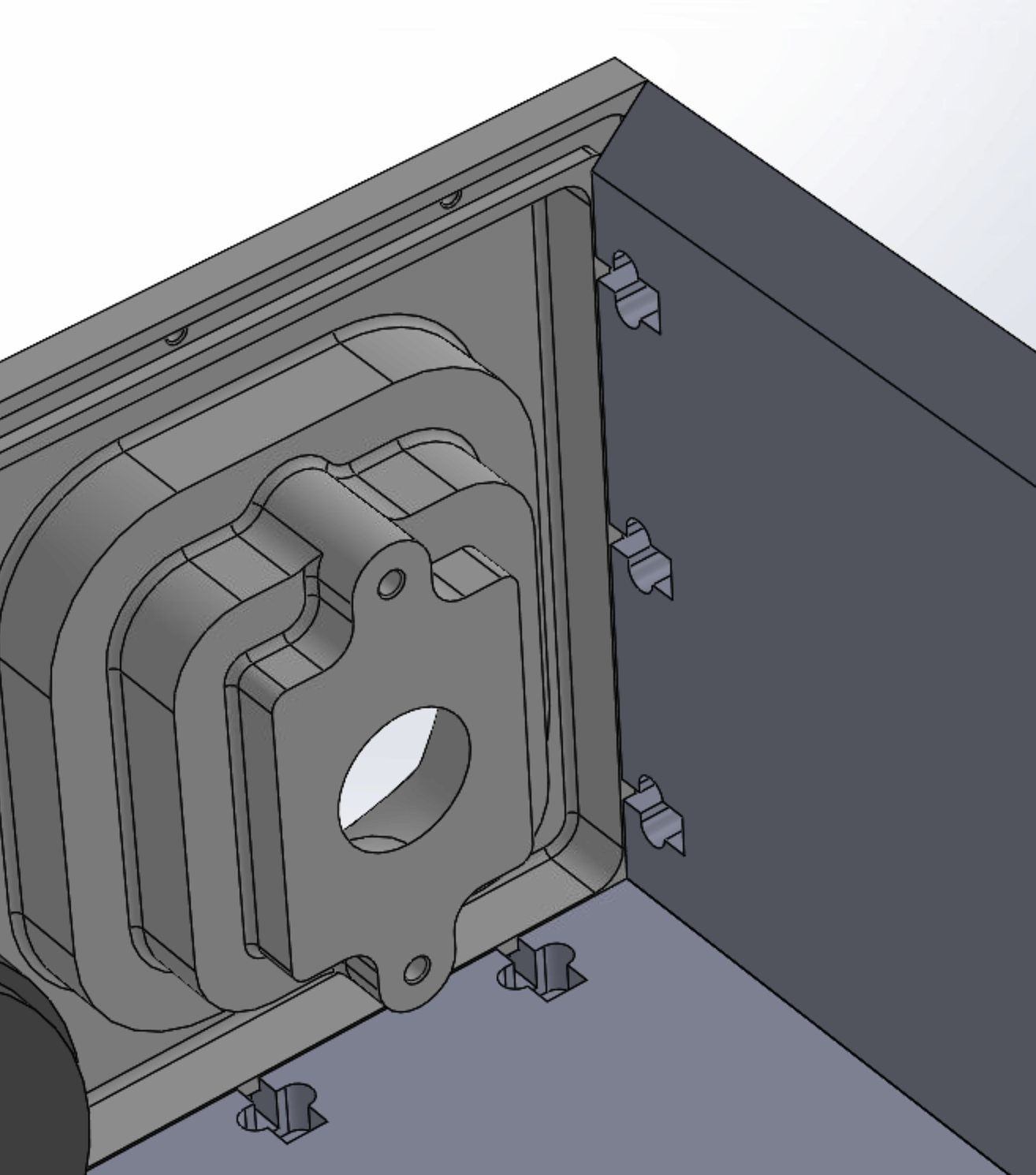

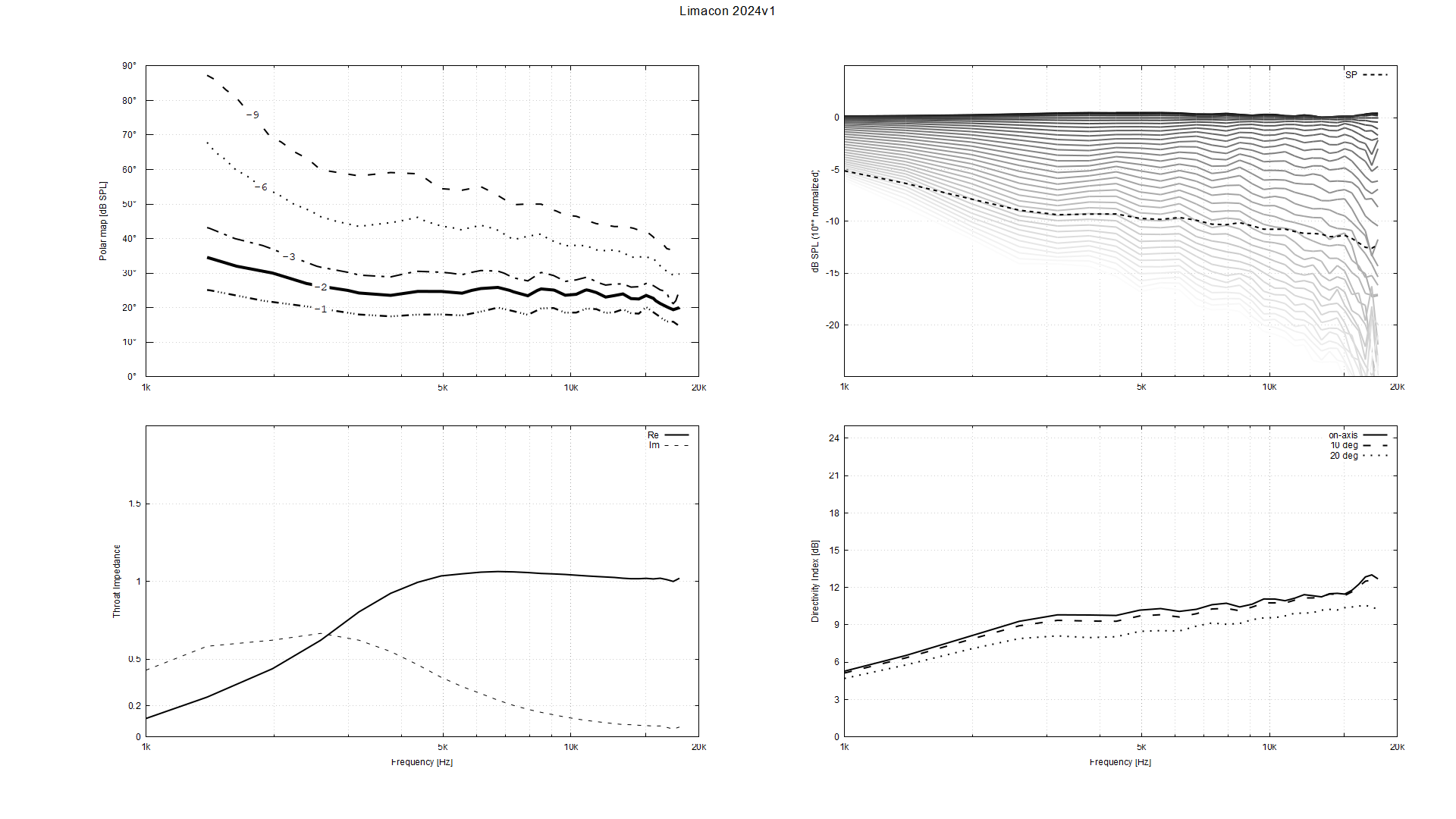

Further refinements yeild positive results. Altering the chamfer angle/size using a custom box shape in ATH4 have yielded the following. A full radius/ellipcal shape might well be better but I like the chamfer approach to the cabinet.

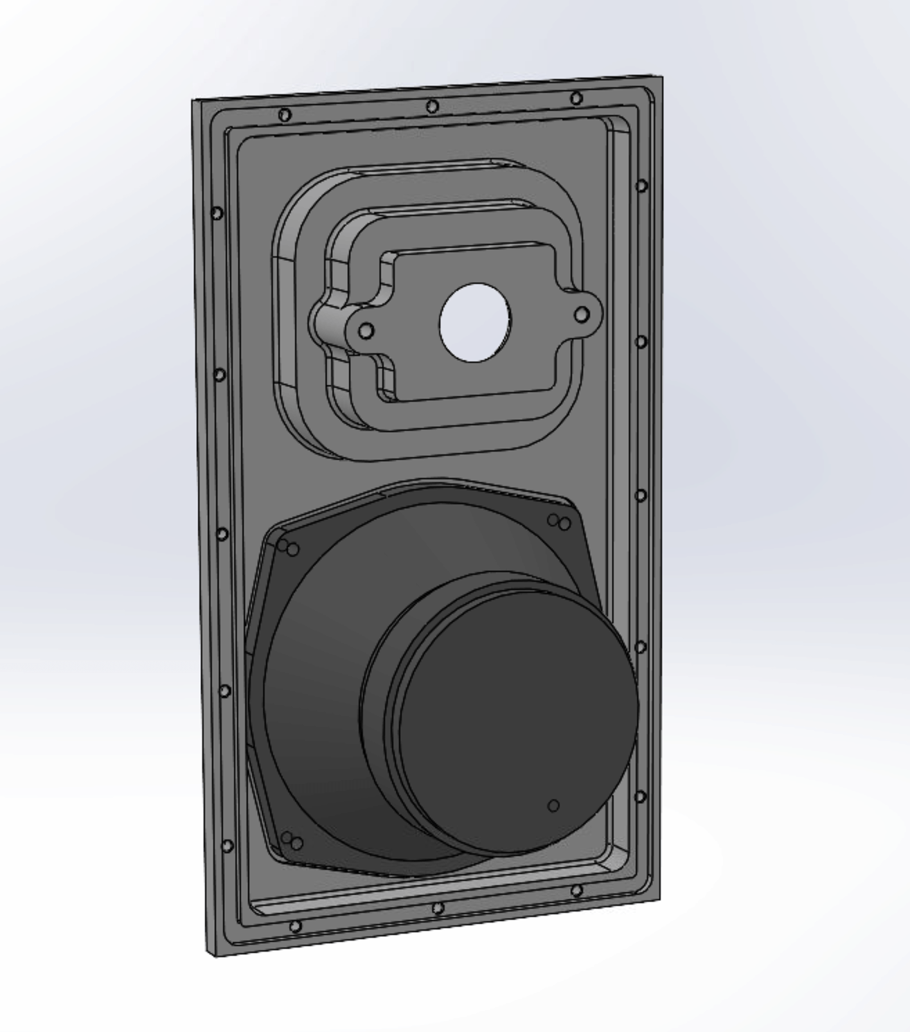

Thankfully I can drop the baffle back on the machine and recut where needed.

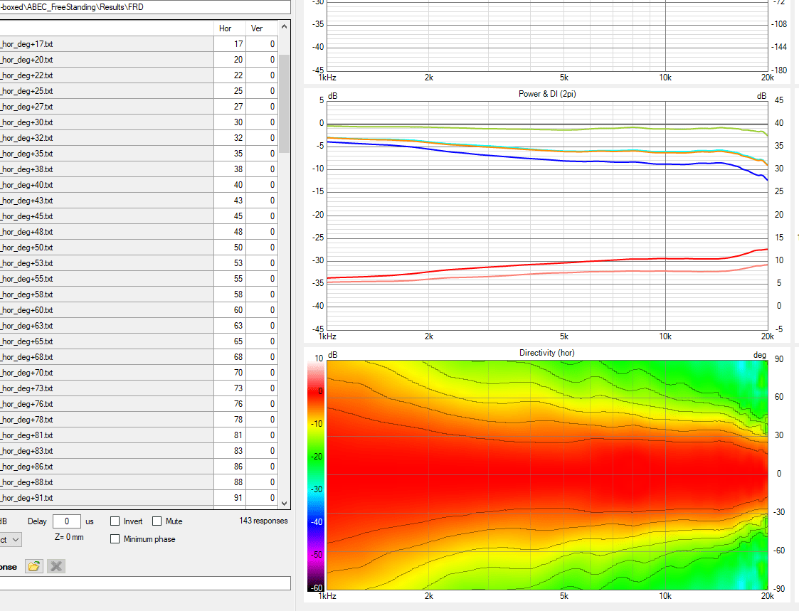

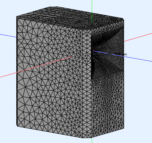

I ended up with 15mm rounded edges and minor changes to the ath4 parameters.
Cabinet dims
Width 164mm
Height 280mm
Depth 280mm
Charts below created with

Code:
Mesh.AngularSegments = 120
Mesh.LengthSegments = 60
Mesh.ThroatResolution = 2.0 ; [mm]
Mesh.MouthResolution = 7.0 ; [mm]
Mesh.Quadrants = 14
Mesh.SubdomainSlices =
Mesh.CornerSegments = 5
Mesh.ZMapPoints = 0.3,0.2,0.7,0.9
Mesh.Enclosure = {
Spacing = 16,16,16,150 ; edge distances (left,top,right,bottom) [mm]
Depth = 280 ; enclosure depth [mm]
EdgeRadius = 15 ; edge treatment [mm]
EdgeType = 1 ; 1=rounded, 2=chamfered
FrontResolution = 7,7,7,7 ; front side mesh element size (q1,q2,q3,q4) [mm]
BackResolution = 16,16,16,16 ; back side mesh element size (q1,q2,q3,q4) [mm]
ABEC.SimType = 2 ; boxed
ABEC.Abscissa = 2 ; 1=log | 2=linear
ABEC.f1 = 400 ; [Hz]
ABEC.f2 = 20000; [Hz]
ABEC.MeshFrequency = 1000
ABEC.NumFrequencies = 50

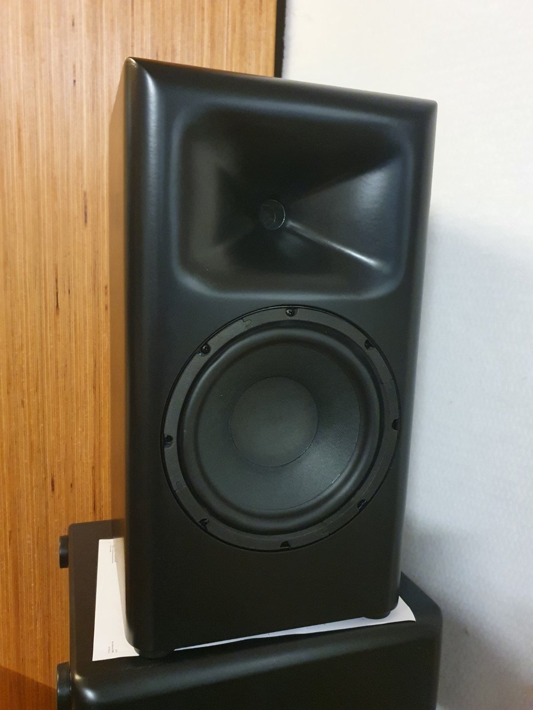

Reminds me of my cinema speakers, just in small:
A rounded Edge is still helpful.
But - how do you like the sound with such a steep rising directivity at around 2kHz? I once built a PA 3-way with 6" in the midrange and small horn for the tweeter. While the sound was very good (lot's of resolution for a time where 12" midrange was standard) I could not stand the directivity - very wide in the midrange but narrow for higher frequencies, didn't sound balanced or even in the room. That's probably a more extreme example as your build but it seems to have a similar tendency.
