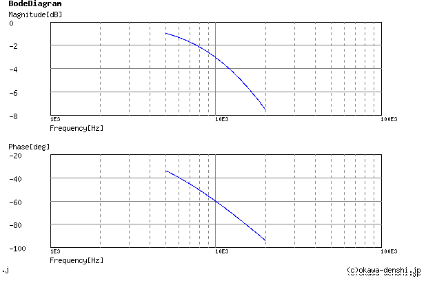

As the DAC nearly newly released maybe somebody will have benefit for it. There was error during asembly and many (I checked photos in internet- same error) or probably all cdp.3 have wrong capacitor soldered in filter - 15nF instead 1.5nF. I accidely found after tried listen to it. high frequencies was rolled of quite badly at 10khz already -3db
once replaced sound become transparent and airy.
i have expierended same ~2011m on m2tech evo usb conveter were highs had -3db at 15khz and 1.5db at 8khz

Hi, Could you tell the part number of the cap? Does it concern the Classé CDP.3 and also the CDP.3 MKII?
I think you mean C403/C413?
https://audiocircuit.dk/downloads/classe/Classe-CDP3-cd-sm.pdf
