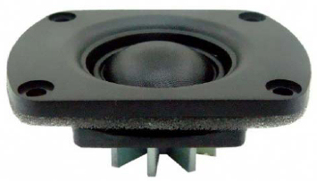

Hello, I have a friend who have a a pair of the original ATC SCM12 model. It performs really good for its age, but it is a speaker on the "dark side".
The tweeter it uses is the Vifa D26NC-15-06 which is supposed to be flat and with a little spark in the 16khz area, so we don't understand why its dark sound.

Take note that your old tweeters have ferrofluid in the VC gap / which has likely dried-up and is now overly damping the High Frequencies.
ie; I wouldn't adjust the crossover for a tweeter that needs service.

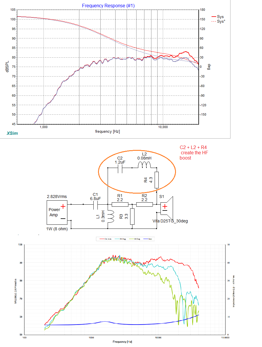

Your friend will need to remove a complete crossover from one cabinet and then draw out the schematic for the crossover. Once drawn, you'll need to post it here.
This leg-work can't be done by anyone else but him ( additionally, the pictures he's provided to you are of very little help here ).
I'm assuming there's a 2 ( to 3 ) resistive pad on the HF ( like other small ATC speakers ).
- That pad ( once identified by your friend ) can be bypassed with something like a 1.2uF cap to add back in some suppressed HF.

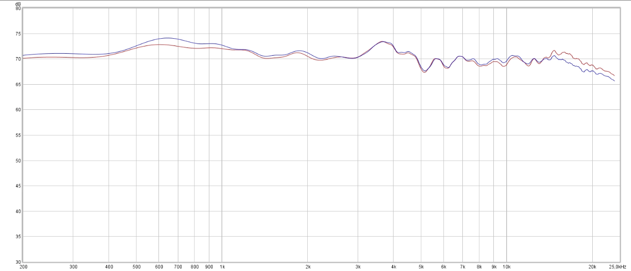

- Taking it further, a .08mH coil can be put in series with the 1.2uF cap to create a frequency-specific boost ) with the UHF "boost" controlled by a single resistor ( see my pic of one possible scenario ).
Here's a "What-If" mock-up based on fictional values ( ie; this is not your friends network ).
- I used the blue ( 30deg ) trace ( belonging to the Peerless version of the Vifa ) for this simulation .
- As such, on axis response might be way too hot in the UHF for some listeners.
I did some reading this morning on ATC's small monitors and it appears there's some consensus that they are somewhat "dark" sounding.
One such thread.
- That might also mean the tweeters ( in your friends SCM12's ) are working as expected ( though to be sure, they ought to be tested to confirm one way or another ).

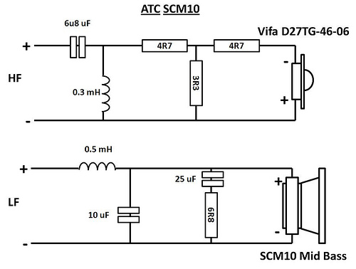

Here's someone else's rendering of their SCM10 network ( I couldn't find any SCM12 schematics online ).
Apart from the values of the coils, your friend should find the schematic of his SCM12 is somewhat similar in layout ( give or take a few parts ).
BTW; the boost circuit pulls the UHF impedance down to about 4ohms, so one wants to use an amplifier that's stable into low impedance when using these sort of LCR circuits.

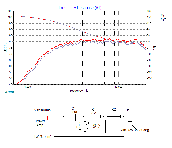

If those SCM12 continue to be dark sounding in there voicing after tweeter replacements ( then as Lojzek has mentioned ) an adjustment of the padding resistors can increase the overall response of the tweeter.
Using my fictional circuit again, one can see how easy it is to get ( across the board ) a 2db increase by simply shorting out R2 ( in the "T" pad ).
- Interesting ( to me at least ) is the new response curve still tightly tracks the old .
- I strongly suspect that an overall 2db increase is too much and that around 1db would make more sense.
- 1 db is achieved ( in my fictional circuit ) by reducing R2 to 1.1 Ohms.
