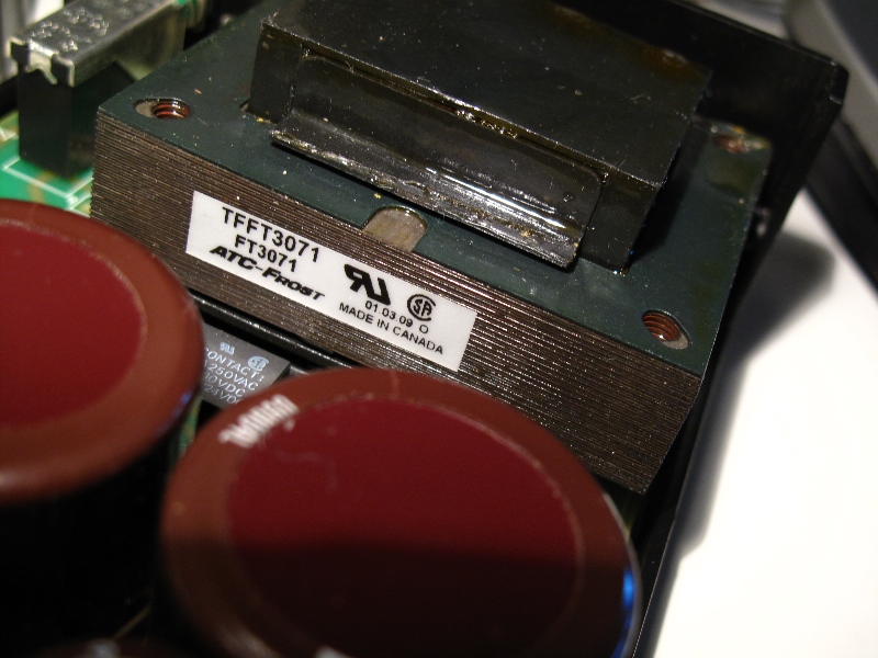

Please I need your help for the data sheet of the ATC-Frost Transformer model TFFT 3071
I'm after the transformer specifications, the frequency rating, and the primary and secondary description please.
Thank you

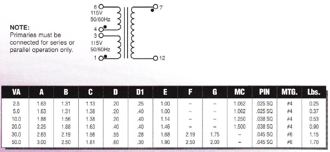

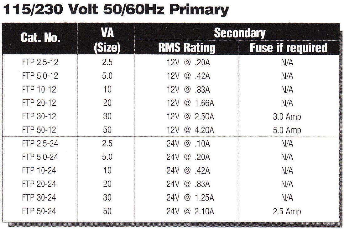

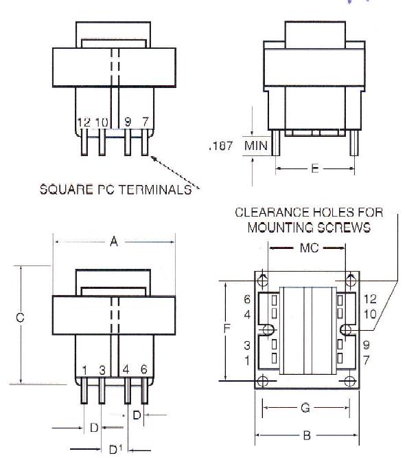

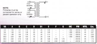

Use the link...looks like ftp series.
I have the datasheet...poor scan.
The part number you have is not listed.
IF the part number follows their numbering system the 3071 indicated a 30VA transformer at 71V...BIG IF
These are dual primary single secondary.
Says industry standard size...you might find a sub from someone else.
good luck
good luck

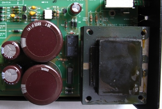

DUG,
Thank you very much for the follow up.
Please check out the thread and the inserted pictures as requested.
Based on your information and the transformer's suitability for both 115/230 volt - 50/60Hz, I pulled out the 115 links J1 & J2.
Soldered J3 link for (in series) 230volt.
Replaced the fuse to a 250 volt / 150 mlA
Pushed in the ON switch.
Measured +40 volt / - 40 volt across the voltage regulators.
All good and working as it should be.
Kind Regards,
Joseph
Kind Regards,
Joseph
