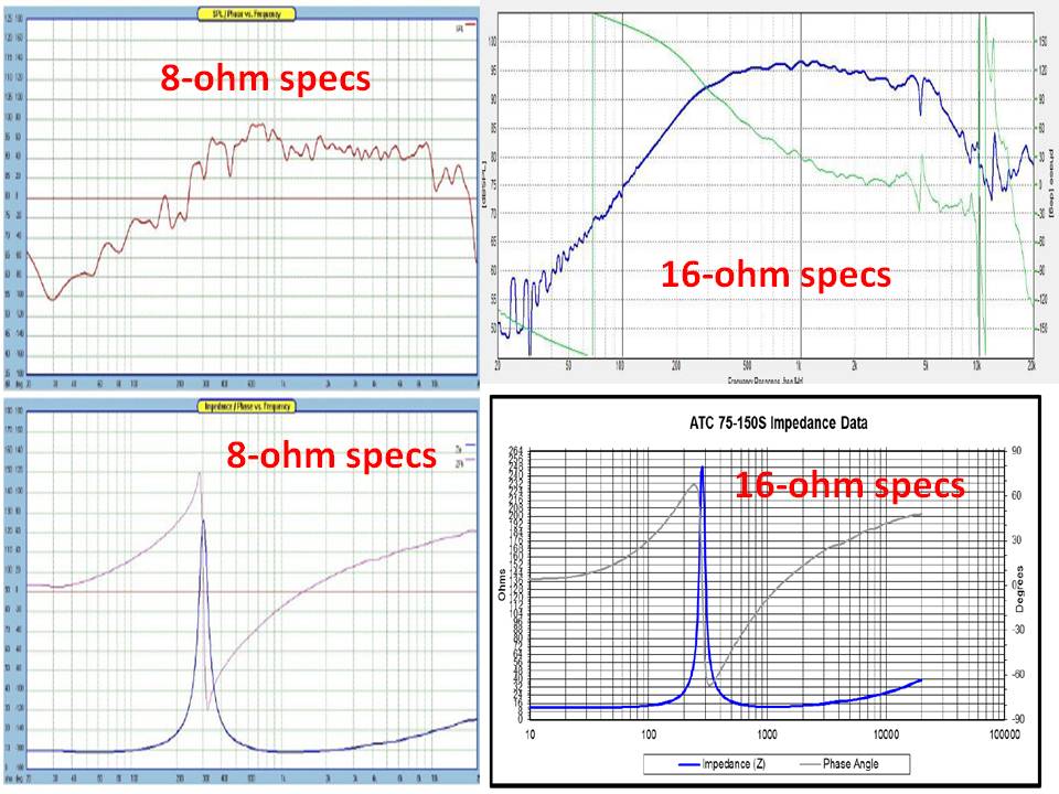

For the best sound, you would need to measure your new ATC 75-150S_8ohm in the actual cabinet and design a new crossover. You would probably want to use a similar filter type.
For a quick test, you could add a 5.7-ohm resistor in series with the new ATC 75-150S_8ohm so a "similar" 10.9-ohm impedance is seen by the crossover circuit. AND you would want to reduce the 6.8-ohm padding resistor at the front-end of the ATC 75-150S_16ohm crossover to about 1.1-ohm resistor (need to experiment with this value) to "approximate" the original SPL/watt as seen by the amplifier for SPL balance. DON"T EXPECT GREAT SOUND WITH THIS PATCH!

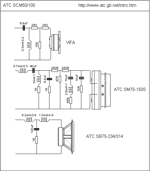

Attached example ATC factory crossover for the ATC 75-150S_8ohm suggest the need for R-L-C notch filters for "optimum" sound.

While it may not change the ATC's FR much going from 16 ohms to 8 ohms using the same filter, the Q at the Fc's will change, and the response lumps will change as a system. Due to the 8 ohm unit looking peakier at the extremes of its useful range in the image Linesource linked, you'll need a lower Q filter to achieve the same system response. Being that the change is going from 16 to 8 in terms of load, the xover will have a Q of half what it did before, and suppress the peaks with more damping using the 8 ohm unit, and it has the lumpier response inherently.
If anything, the lower Q with the lumpier 8 ohm driver should not change too much to the negative from the smoother 16 ohm and higher Q system. At any rate it may be dipped at Fc instead of flat, and definitely not peaked, but that is a worst-case guess.

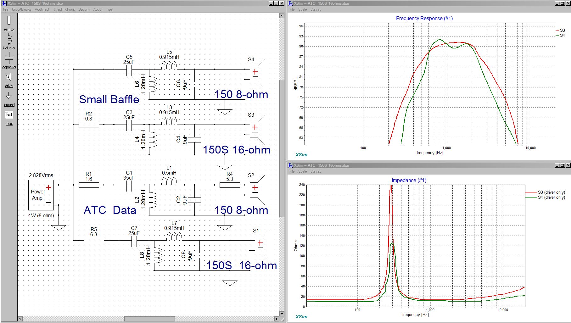

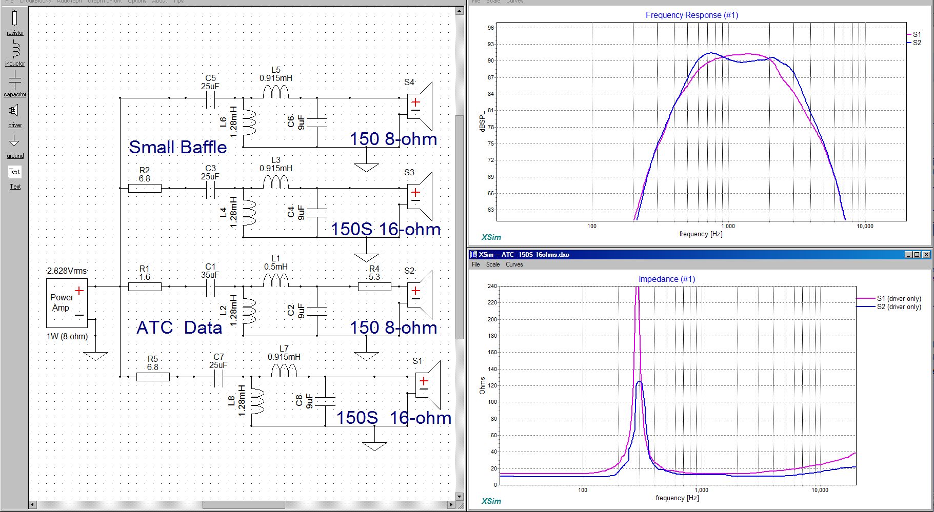

The only way to build a good sounding crossover is to take quality measurements of the actual speakers in their box.
Pulling frequency and impedance data from the ATC website, and from diy speaker projects I took your crossover circuit and ran two simulations.
1) using ATC data, probably LARGE baffle board testing, and experimenting with front-end resistor power resistor and series resistor attached to 8-ohm ATC. Very good results.
2) using data from a diy project on the web which had a very small area baffle, and experimenting with capacitors, front-end resistor power resistor and series resistor attached to 8-ohm ATC. Changing crossover capacitor values was also required to get a decent curve match.
Hope this motivates you to download Xsim and SPL Copy free software and make a few measurements.

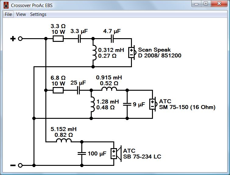

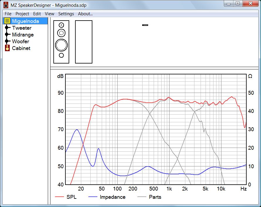

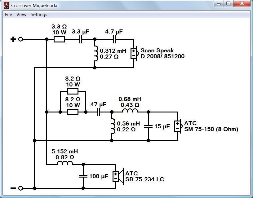

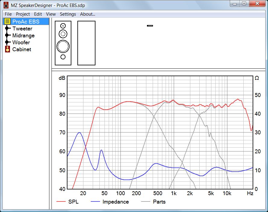

Hi Miguel,
Now that Troels Gravesen has published his measurements of the standard ATC SM75-150 16 ohm (ATC-SM75-150) it's more possible to answer your question. I get the best match with the original response when all components of the midrange filter are approximately halved or doubled.
Attachment 1+2 is the original ProAc EBS using the 16 ohm midrange unit, attachment 3+4 is the modified version using the 8 ohm unit. Note that all drivers are positive polarity. My simulation does not at all confirm the inverted tweeter shown in the original schematic. :scratch:
