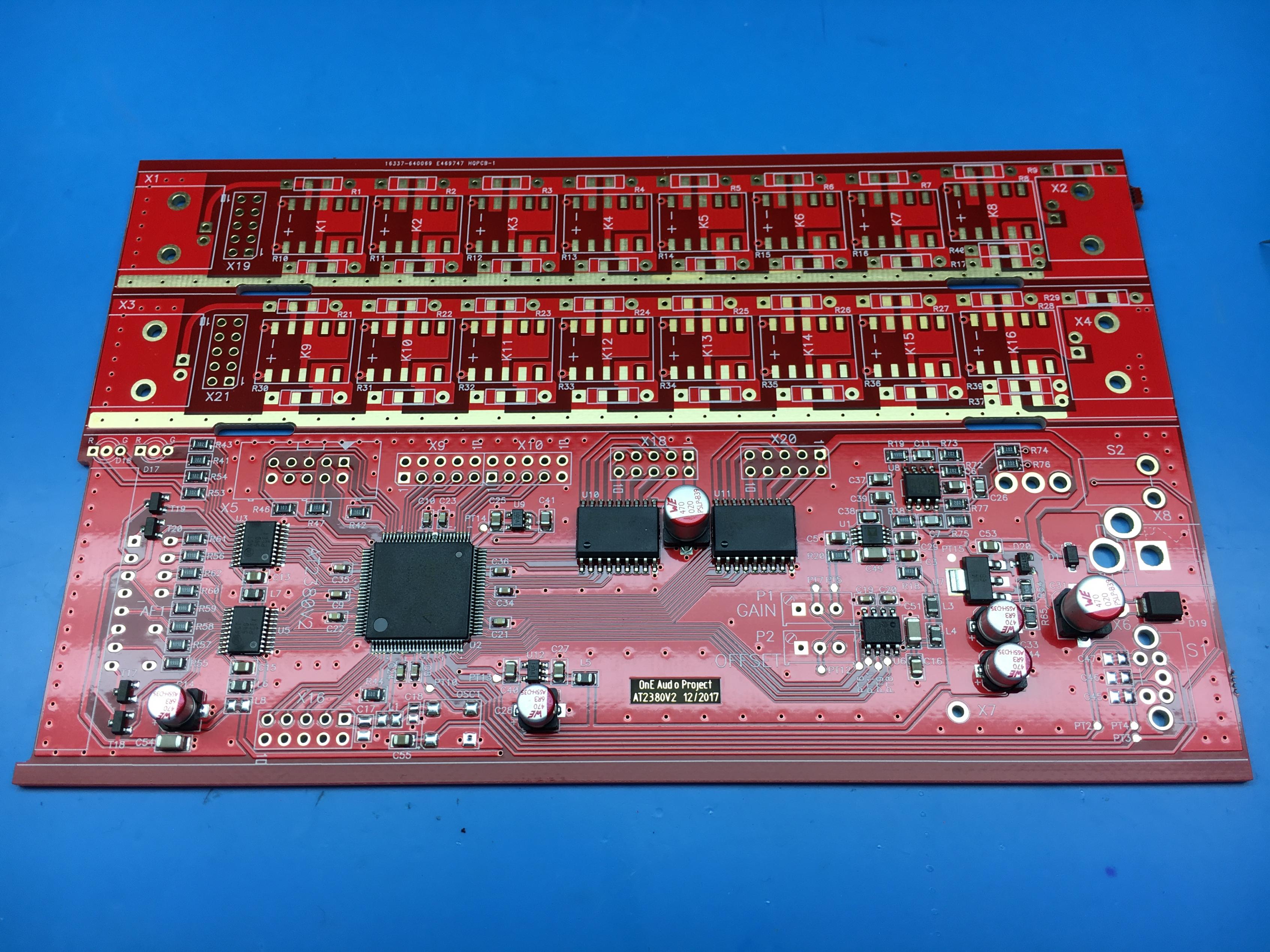

Mouser order arrived, and I stole an hour of sleep to start the soldering...
This is the most complicated and challenging project in my DIY career so far, but Frex went a long way to put an excellent package together, thanks for that! The documentation is outstanding! A professional documentation couldn't be better and more in-depth, and this is a hobbyist effort for no profit at all. Your commitment to the DIY community is most generous!
So far, I soldered the ICs ... that CLPD in TQFP-100 case was a real challenge. I could not succeed with hand soldering, there was one short between pins that I couldn't get rid of. In the end, the cheap chinese hot air station that I had bought out of curiosity, and incredile amounts of flux solved the problem!
I believe I found one mistake in the BOM, U8 is supposed to be SOIC-8, but the Mouser part number is for VSSOP-8 case (BOM: 595-THS4531IDGKR , should be 595-THS4531IDR or 595-THS4531ID).

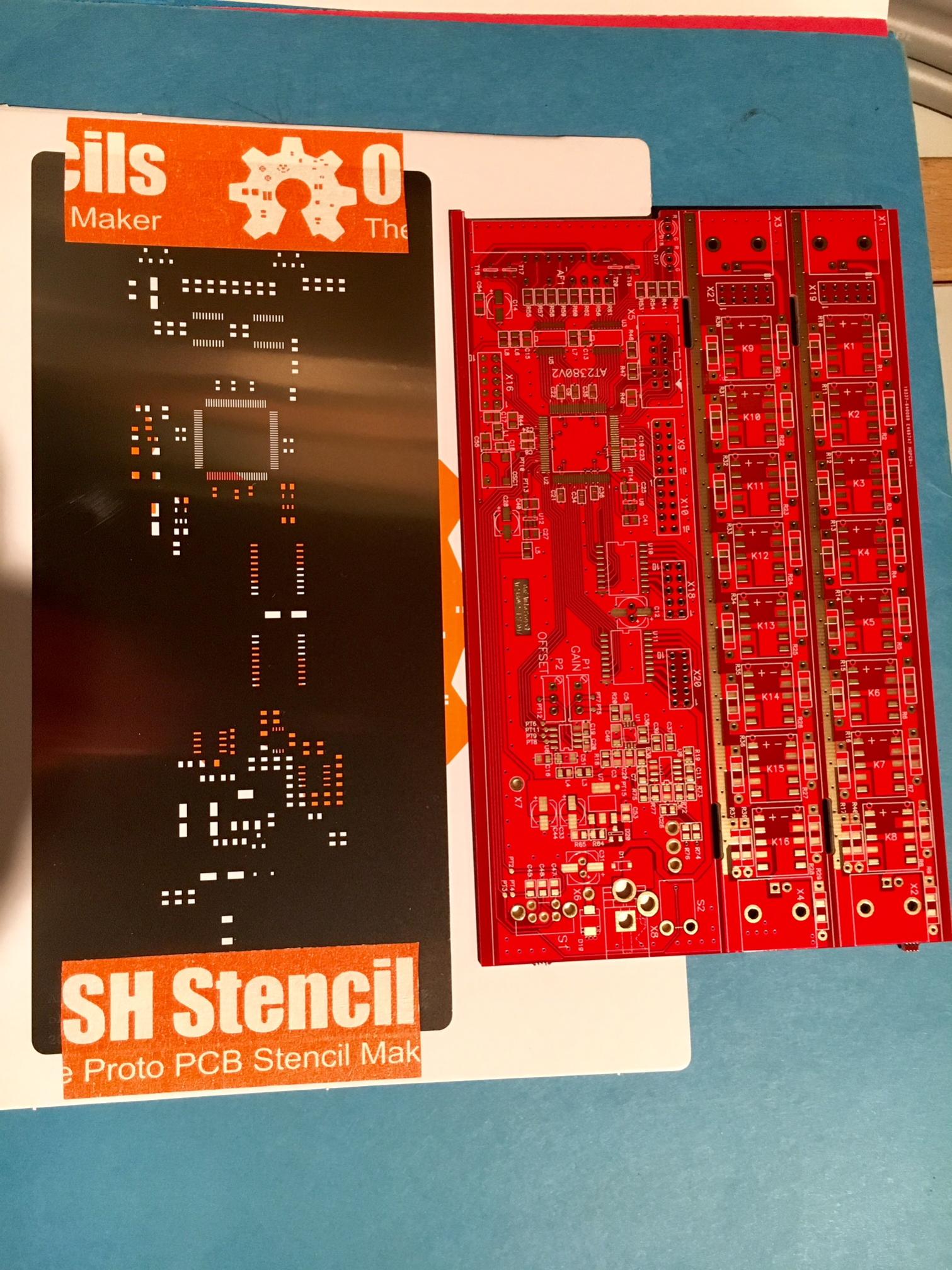

Thanks for the heads-up on U8. My Mouser order literally just arrived (with VSSOP-8). Took nearly a week to ship evidently due to the large number of line-items after combining two big projects! They were nice enough to upgrade to overnight shipping. I think I'm going to stencil due to the TQFP-100 pitch.

Indeed there is a mistake in the Mouser ordering code...
The right Mouser code is 595-THS4531IDR for the SOIC version (not VSSOP).
