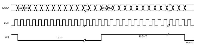

Greetings,
DDDAC,
Perhaps I am missing something obvious, but in your v2.1 schematic you are providing a new WS and BCK, but you are doing nothing to synchronize with the data. If the converter does not know where either LSB or MSB are, how are you guaranteeing conversion of the appropriate word level?
-Chris
