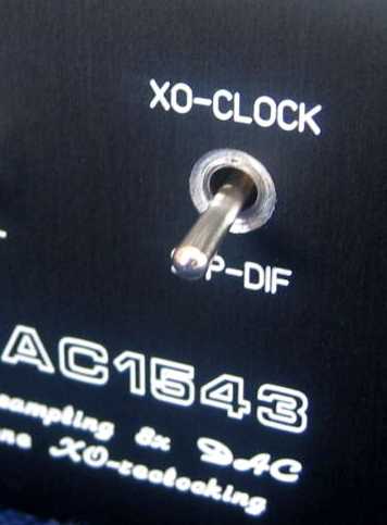

The only true comparison is real A-B. Like I use in the dddac1543. Actually you can switch, whilst playing from normal clock to asynch reclocking mode. Everone, no exceptions, who I demonstrated this and also people who built the same design and did the test themselves were the same opinion. it works........ more space, more clear soundstage, no discussion needed, blind test, clearly detectable. No theorie, no datasheets, no different designs, no cable plugging, just click and there it is.....
BUT, it only works, if you use a XO clock which is 11.2896 Mhz. I tried 12, 18 and 24Mhz and it produces clearly noticable IM distortion......

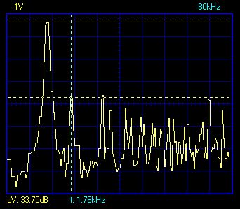

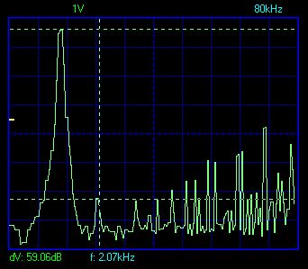

look at this pic..... shows a 1kHz sine wave spectrum reclocked with 12 Mhz. You can hear the xtra tones with female voices easily, brrrr

Doede,dddac said:I used 12, 18 24 Mhz, VERY bad......
Reclocking with non Fs multiple frequencies won’t in itself introduce that distortion.

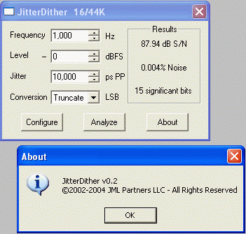

To evaluate the audibility of jitter and dither, I wrote this little program, jitterdither.zip. The included source code should answer any questions about what the programs does. Recompile it if you are wary of viruses in downloaded exe files. [/B][/QUOTE]
I am not clever enough to understand the source code but dis run jittertest thru' my spectrum analyser. What I got was a series of spaced hrmonics with a fundamental.
Can you please explain how this should be used to measure jitter?
Interesting, but I have no idea what you were measuring. The program doesn’t output anything expect a few numbers. It samples a mathematically perfect sinusoid, using the specified parameters, and compares the result, sample by sample, to the original.fmak said:What I got was a series of spaced hrmonics with a fundamental.
