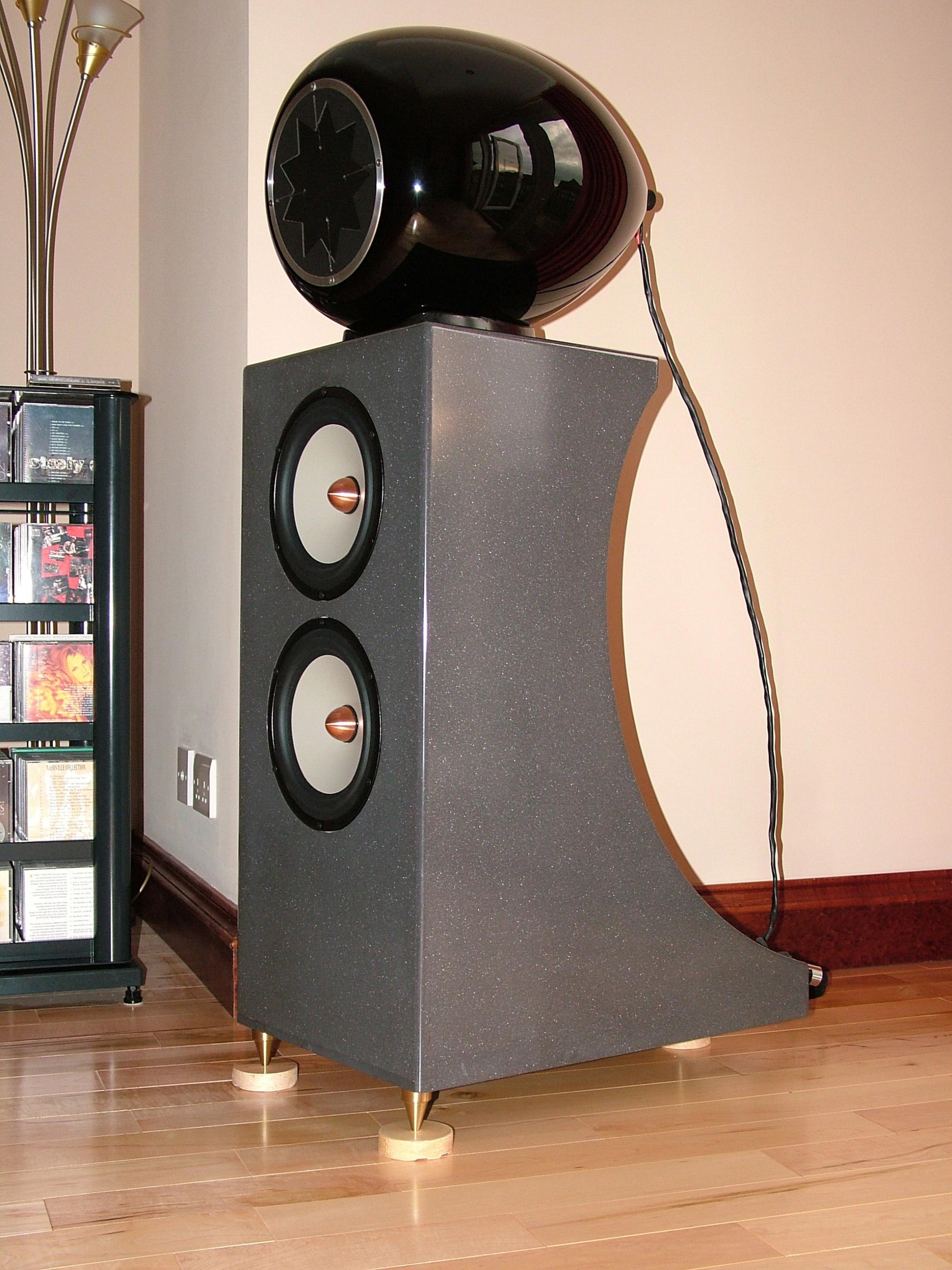

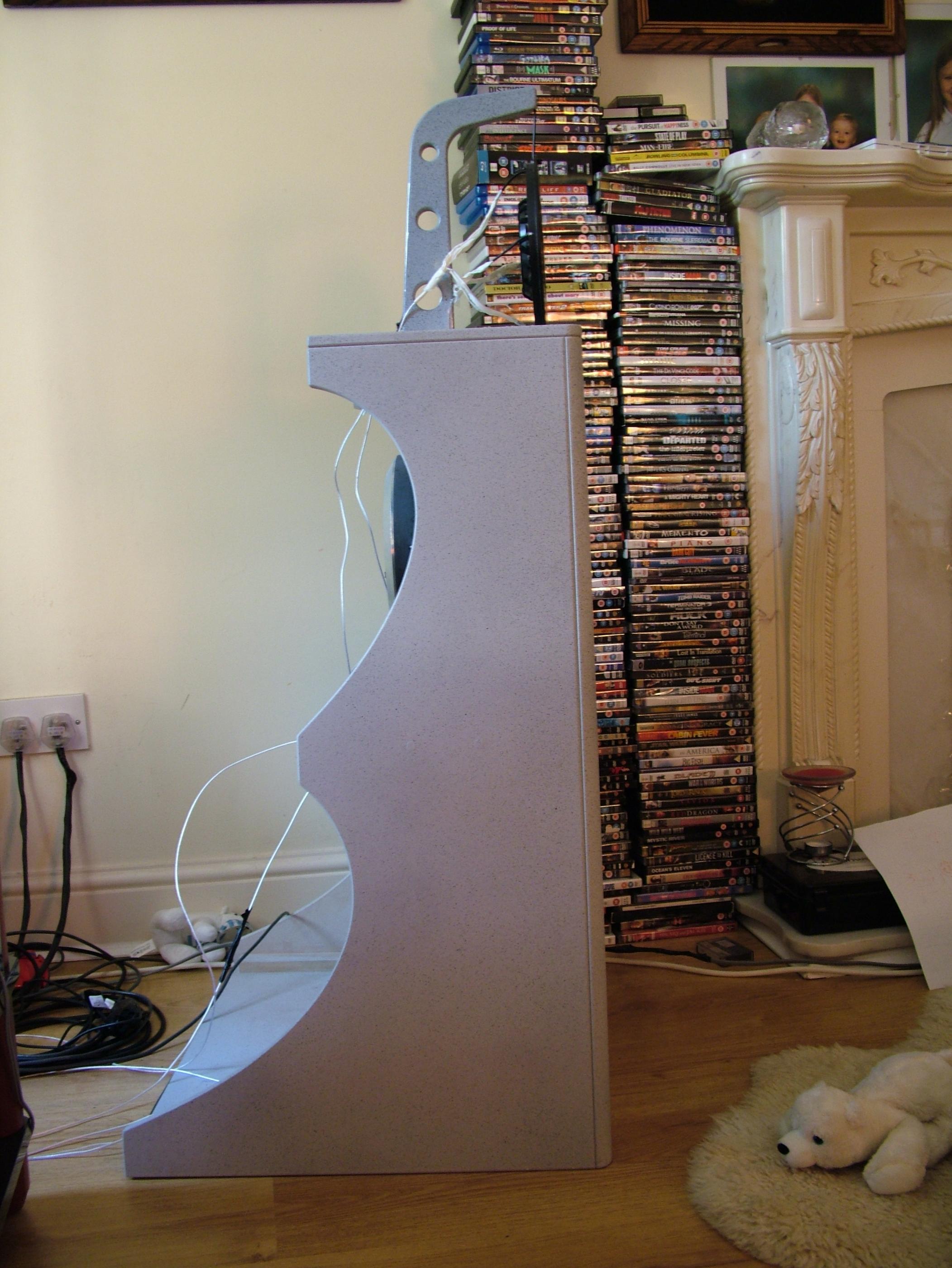

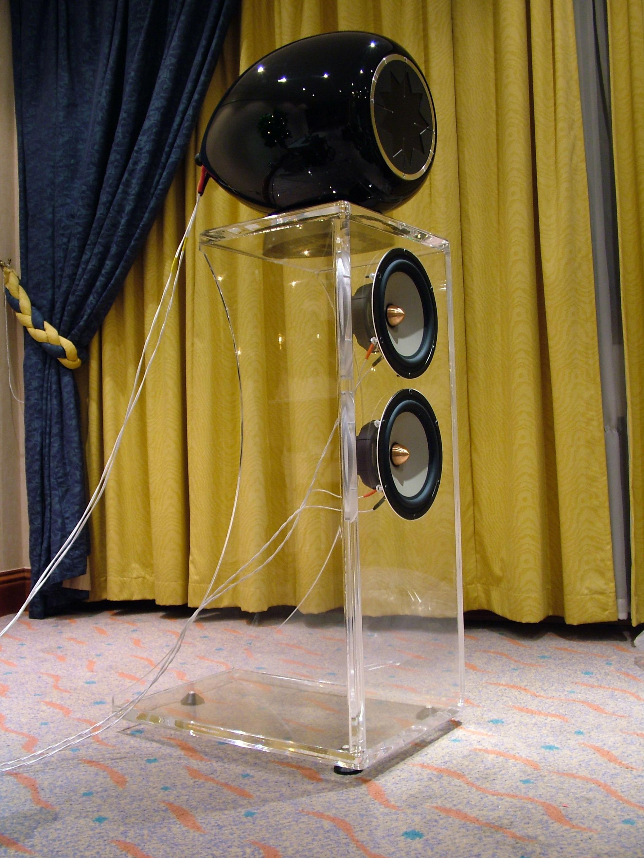

Hi Beanbag,
VPL is your answer, its easy to build and test it out and gives you the best of both worlds....The extended low end performance of deep sided U frames without the cuppy & boomy low midrange and bass (pipe resonance issues) and / or very wide front baffles.
I have attached one example in two different materials ( acrylic and Corian) and I can post another more advanced version in MDF. to give you a visual example of the concept.
Its not rocket science, it just uses asymmetry to eliminate baffle step and path length cancellations.
The clue is in the name "baffle step" lets get rid of the "step" and make it a very gentle and variable "slope"...!
Imagine how the sound waves "see" the baffle as they radiate out from the front of the cone, spread out over and around the baffle, round the sides and are met by the sound waves coming out of the rear of the cone on their journey round the cabinet.
By taking "shark bites" out of the sides one can achieve various degrees of asymmetry therefore varying the actual baffle width (this dimension obviously includes the depth of the cabinet sides) that the sound waves "see"
One can even use different shapes for the left and right sides of each cabinet.
Taken to its logical conclusion one can use 4 different shapes of sides on each pair of speakers...This spreads any room interaction ( note interaction not just room...Earl!)
As I was selling commercial designs I balanced asthetics with performance...4 different sides did improve the performance but looked wrong!

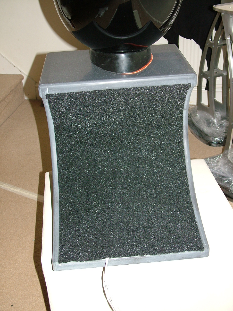

Also you can use some Twaron / Angel Hair and various absorbers close behind the drivers and cover it with black grill foam...looks good and works great. Pic of that somewhere...I will post it later.
Anyway, hope this is of interest and you cut some sides and test it out.

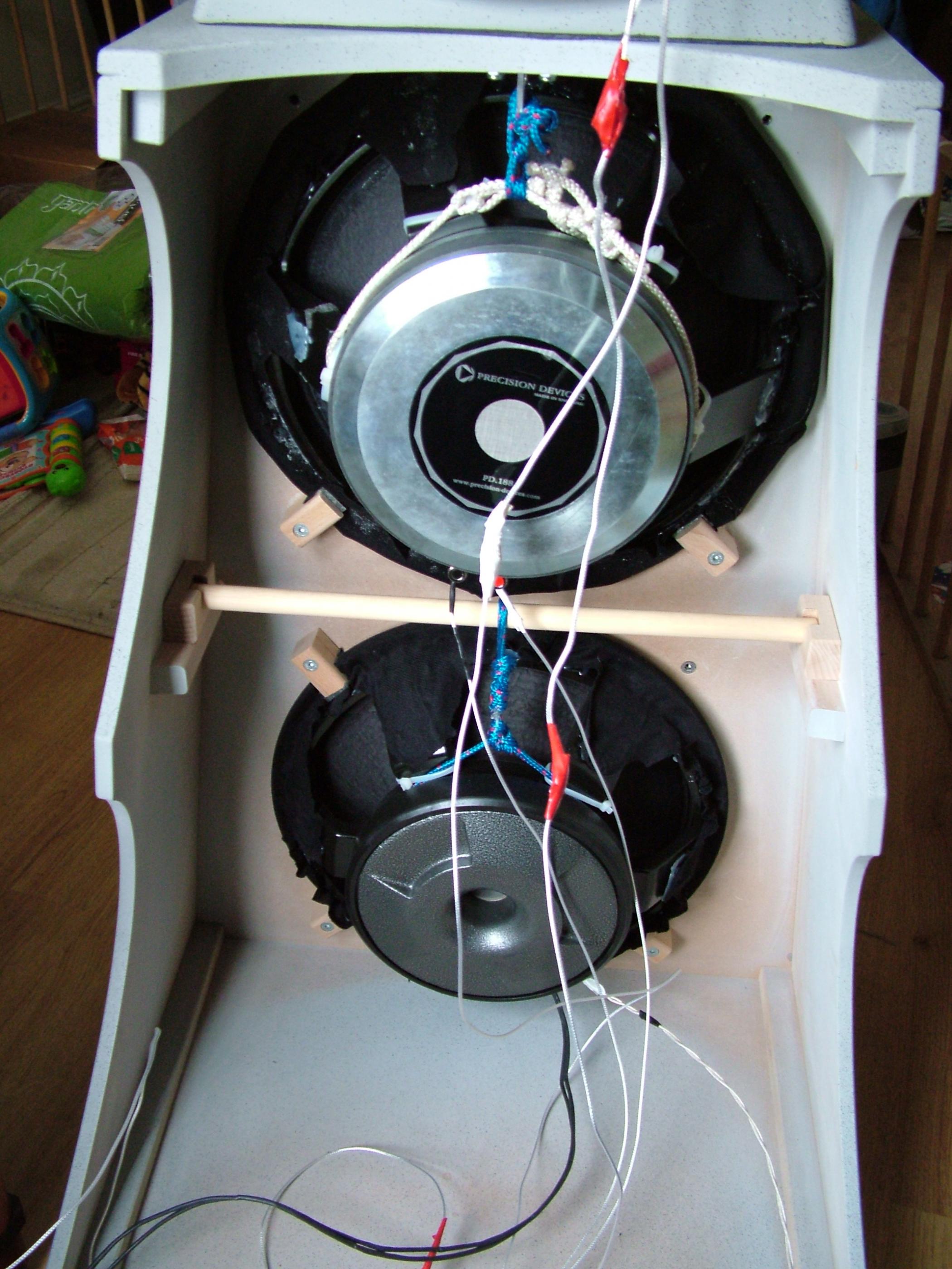

Suspended drivers
Last big upgrade was to not to bolt the drivers to the baffle...
Suspend them and ensure they are a "snug" but not tight fit...Use a thick internal Sorbothane or foam gasket and use wooden . Sorbothane foam gaskets to gently hold the drivers in place ....Works a treat and totally eliminates cabinet resonance. This is a big issue,
Cheers
Derek.
