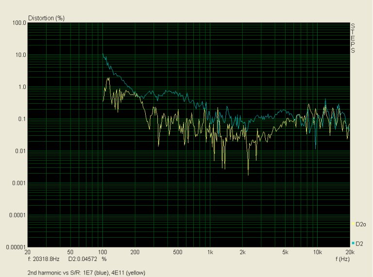

Need for Higher Resistance Coatings
arend-jan,
You have clearly demonstrated the advantage of using higher resistance coatings to lower 2nd harmonic distortion for ESLs with large geometric asymmetry in their construction.
The question that comes to my mind is:
For the average ESL where asymmetry is typically <5% would the higher resistance coating provide any reduction in 2nd harmonic distortion? or is the lower resistance of the commercially available coatings more then adequate.
Is this something you could easily test with your setup?
arend-jan said:As we can see, no increase in second harmonic this time! We have actually improved the linearity of the device by raising the surface resistance of the coating.
That this is so, is confirmed by a significant drop in second harmonic compared to the measurement from post #1, especially in the mid range (0.03% vs 0.1%)
Wachara has commented that he could hear the difference between low and high resistance coating in his headphones. These measurements support that claim.
Unfortunately many commercially available coatings for ESLs are in the 1E7 to 1E8 range. I'd say this makes a strong case for higher S/R coatings!

I now realise that it was not completely obvious at first sight, but if you look at the graphs carefully you will see that the distortion is always lower with high SR coating, even without the added asymmetry. Here is the measurement for the normal constructed (e.g. NOT asymmetric) headphone panel:

I also got a first hand experince with low res v. high res coating when I changed the 12µm aluminum coated membrane of my stats to 6µm Hostapohan coated with antistatic vinyl polish that should give quite high surface resistance (somewhere near 10^9ohms).
The measuring equipment is in a downgraded state now because the main measurement soundcard is broken, hence the high noise level in the plots.
Low drive level measurement was done without crossover or equalization, the high drive level was done with 260Hz 6dB/oct high pass to avoid trafo core saturation. Measured in my room with concrete walls, pretty close to the walls, so never mind the rollercoaster ups and downs😉. The mic was in the listening position.
THD high res. v. low res; lower drive level (noisy measuring equipment cannot measure the high res coating's THD):
THD high res v. low res, higher drive level (around 25Vrms):
Pretty nice ~25dB difference at the high drive level.
The bias voltage was somewhat below 2kV during the measurements, so the distortion showing with the high res coating at high drive level is likely mostly from the transformer. Boosting the bias to 6kV increases the sensitivity by 10dBs, and at the same drive level the distortion is likely 7-8dB lower even though the speaker plays 10dB louder.
I had previously thought that the excess H2 levels with aluminum coating at high drive levels were caused by the step up transfrmer or some low res coating - trafo interaction mechanism. If I understand correctly, the charge migration on the membrane should increase H3, not H2.
This would be the case if the push-pull ESL was mechanically perfectly symmetric. But even if an ESL is built perfectly symmetric, as soon as the bias charge is applied to the diagphragm deflects toward one of the stators. This upsets the symmetry. Curved stators add to this problem because even when uncharged the diaphragm tends to be closer to the rear stator than the front.
You will mainly see H3 due to charge migration show up at lower frequencies where the diaphragm excursion increases to a significant portion of the gap. It can be confusing to differentiate transformer distortion from ESL drive mechanism distortion. If you have a voltage probe, you can measure the transformer distortion directly by monitoring the applied primary voltage right at the transformer connections, downstream of any crossover parts or series damping resistors. In general, you will find it's distortion contribution to be rather small except at lower frequencies and higher drive levels.
