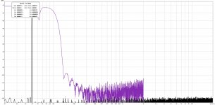

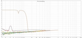

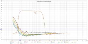

Hey all

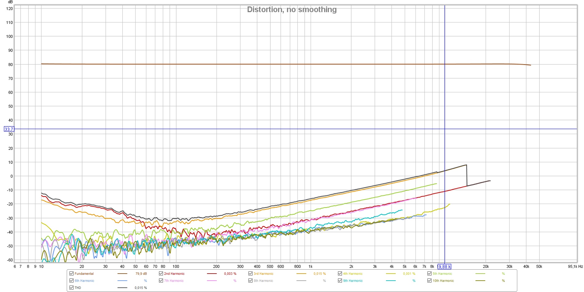

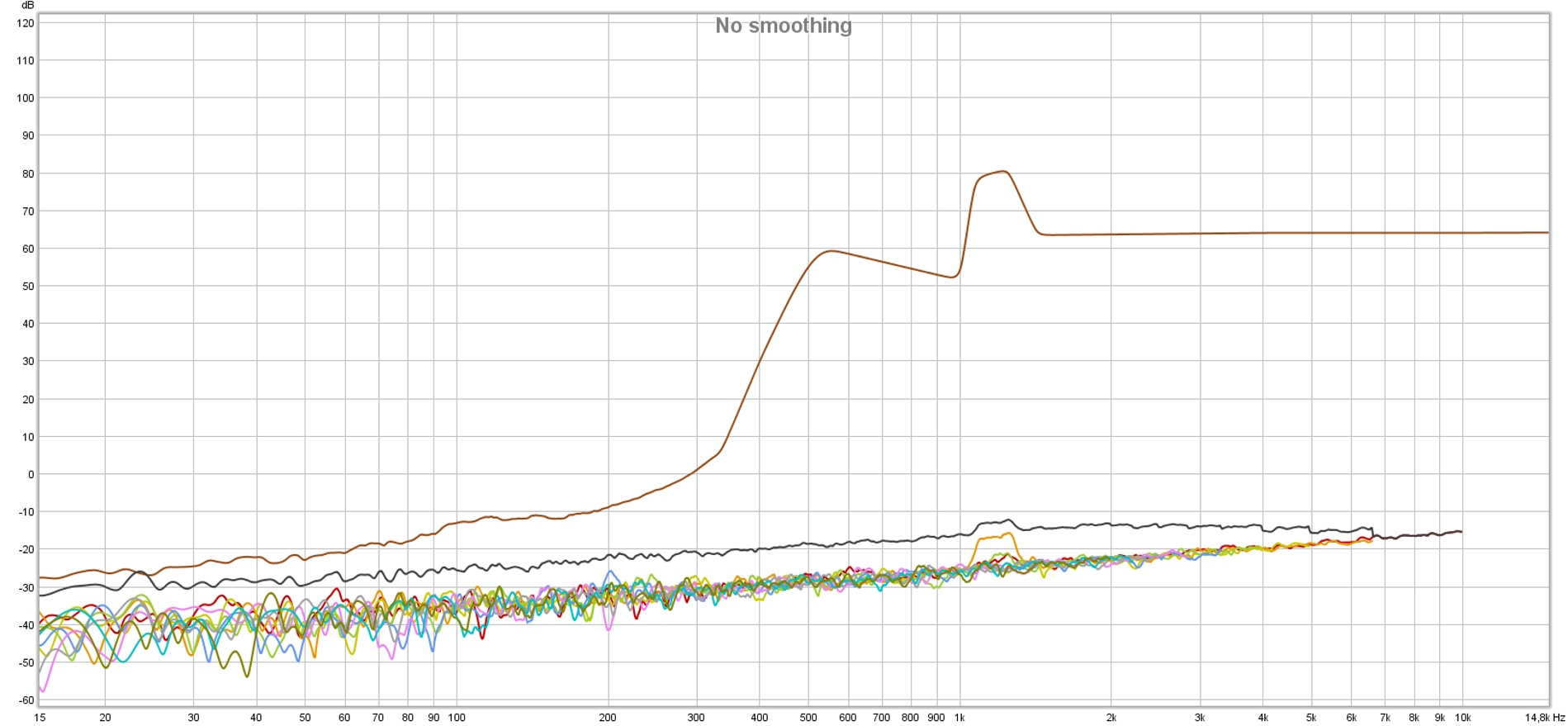

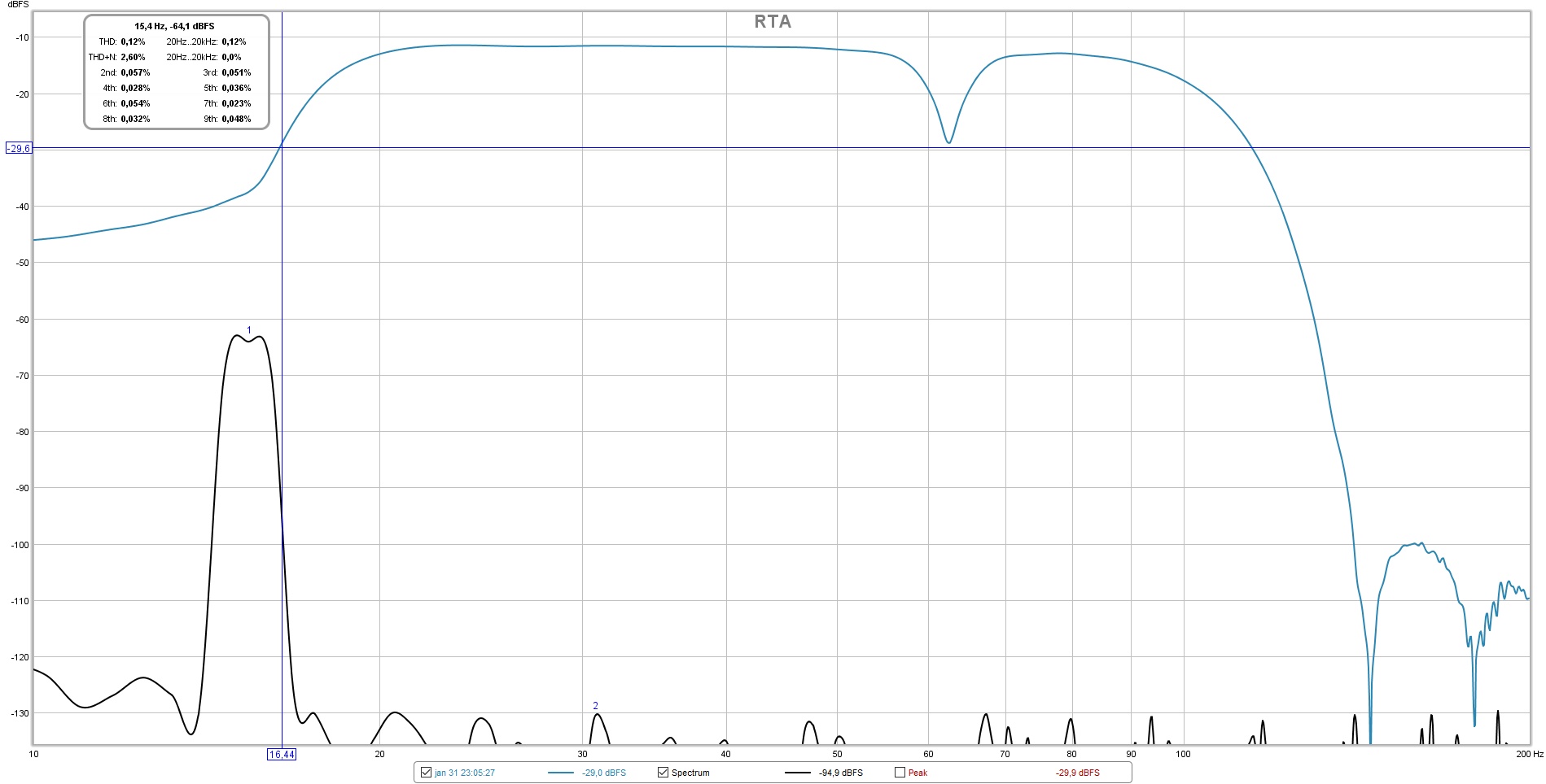

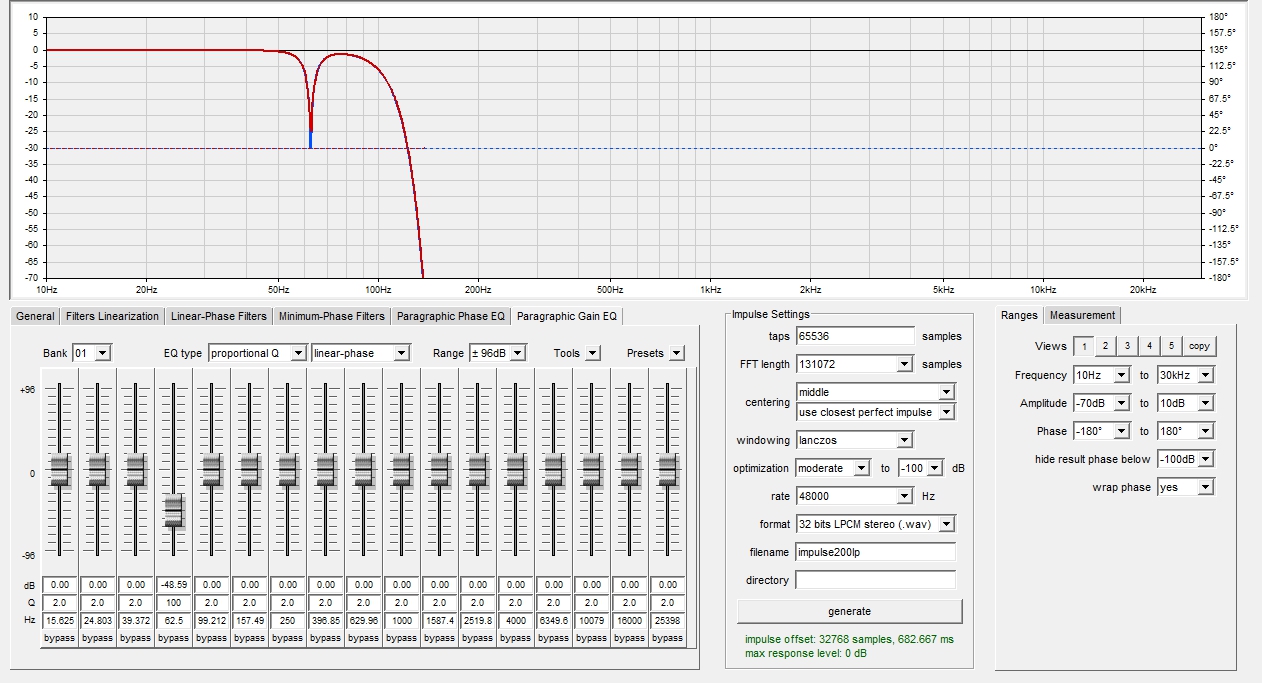

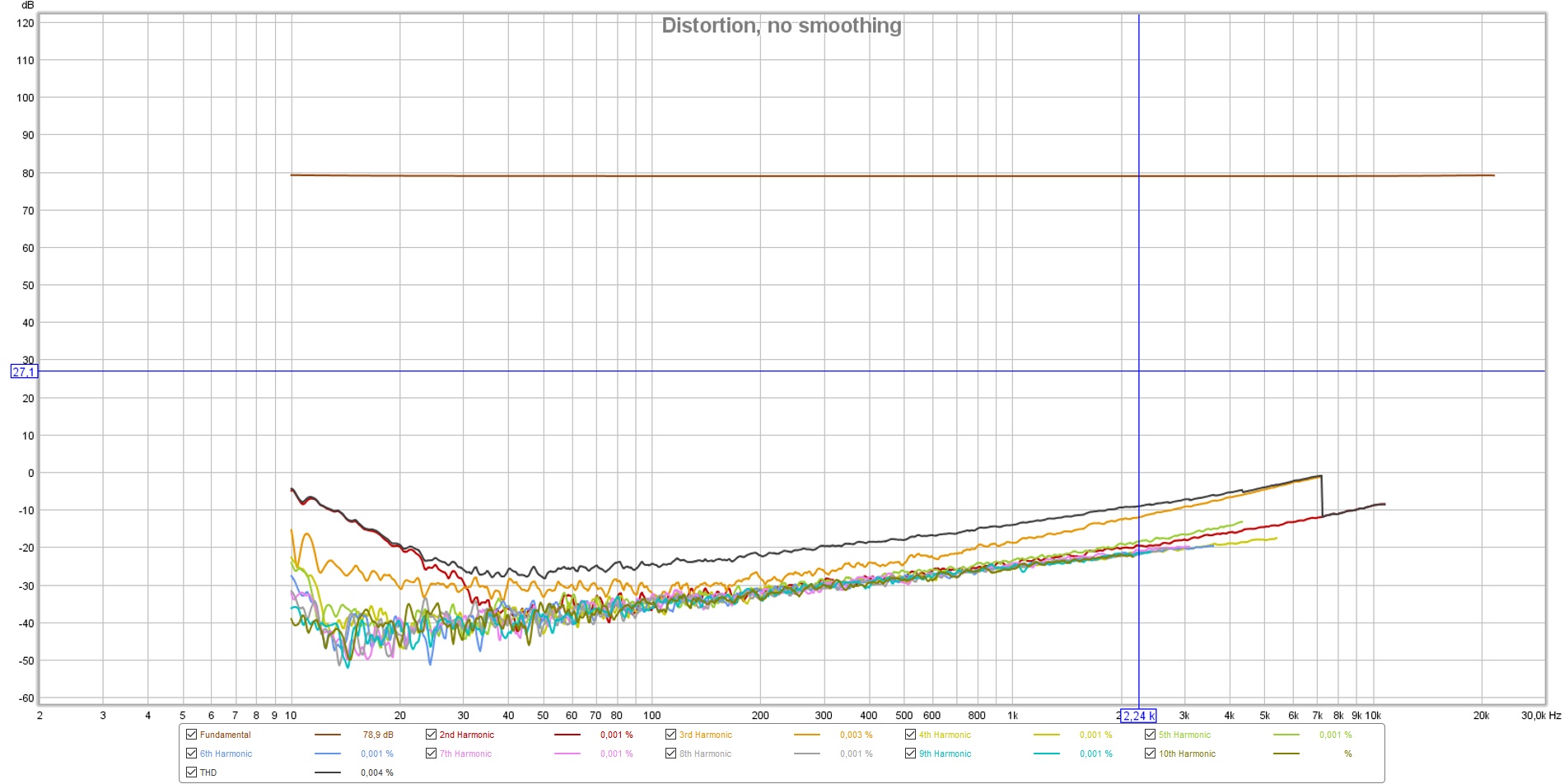

Today I measured the ASUS xonar U7 USB soundcard with analog loopback headphone to line-in. So no samplerate conversion!

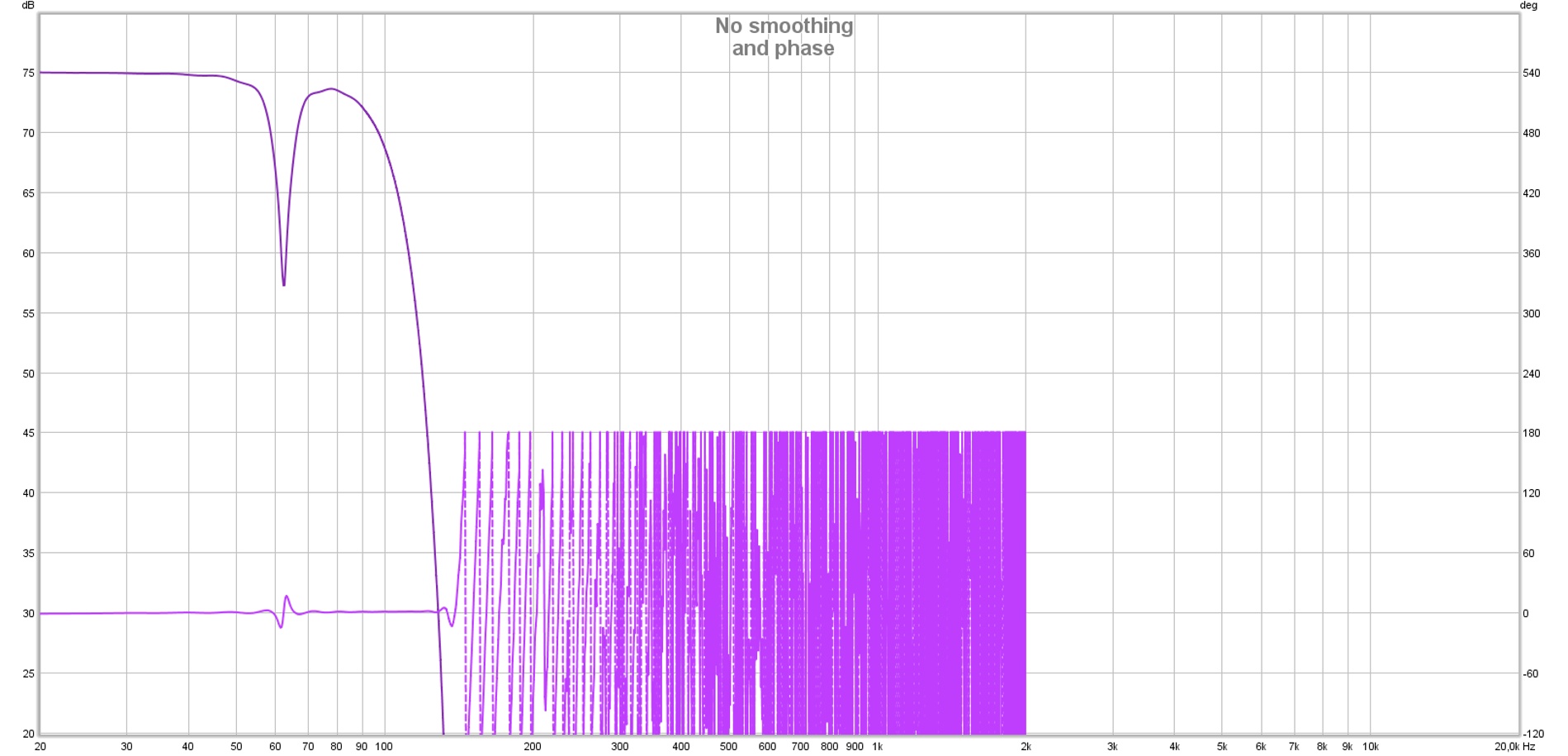

Was interested in distortion measurements when using the APO dsp program. Wondered if the free signalprosessing program distorted when running FIR filters generated by rePhase.
The PC is a Lenovo cobylake i5 so a little overkill.
Will maybe try a 100euro 7" Atom PC later.
The short answer. Suprising low harmonic distortion!

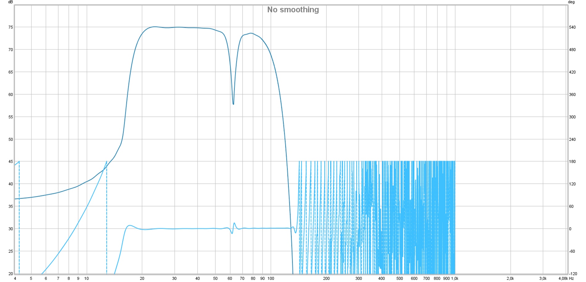

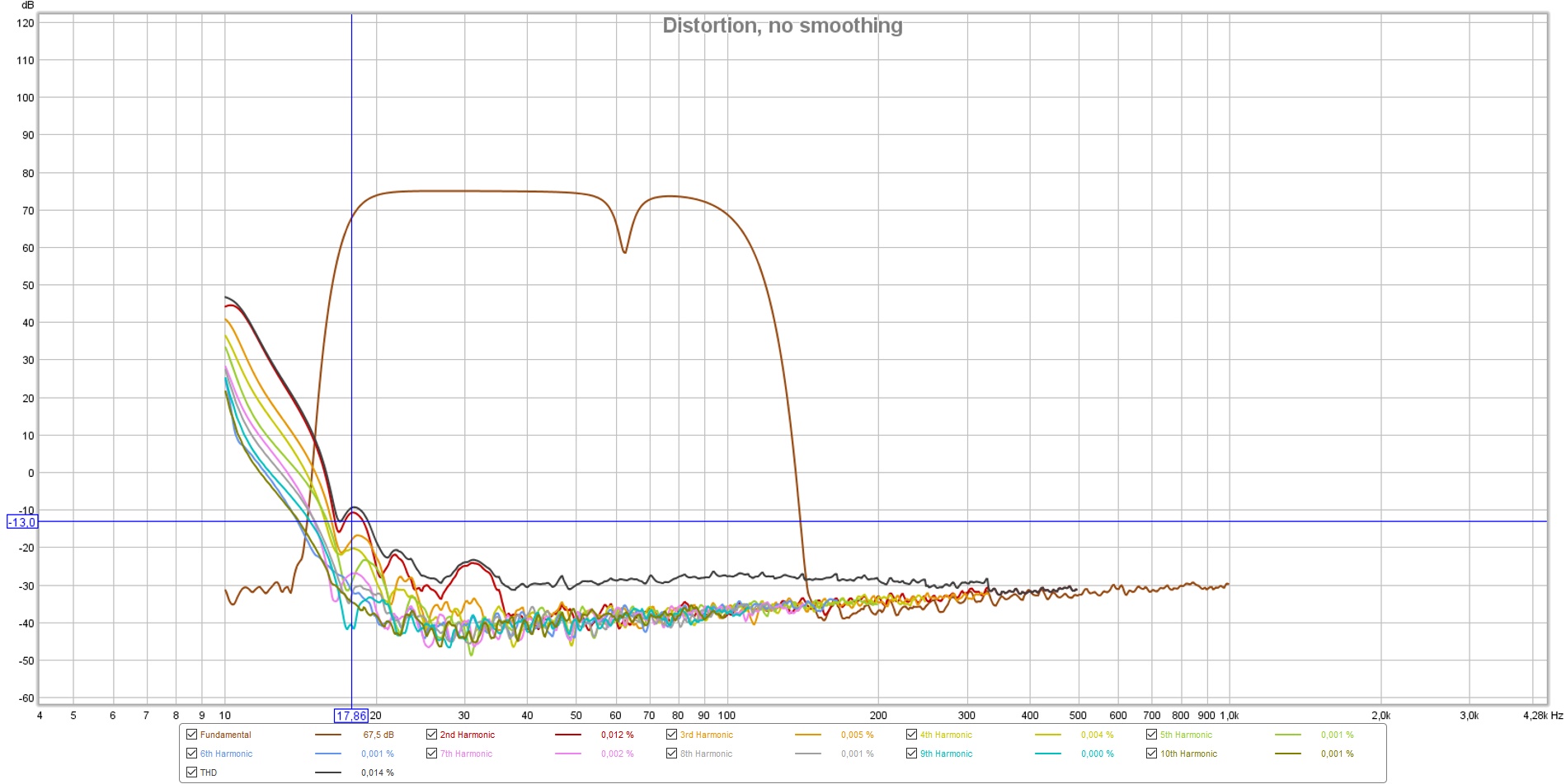

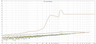

The last picture is just a extra measurement of a steep HP filter with a almost sqare 1kHz 20 dB boost. (Just some "difficult" eq:))
Used 32 bit wavefiles as FIR input

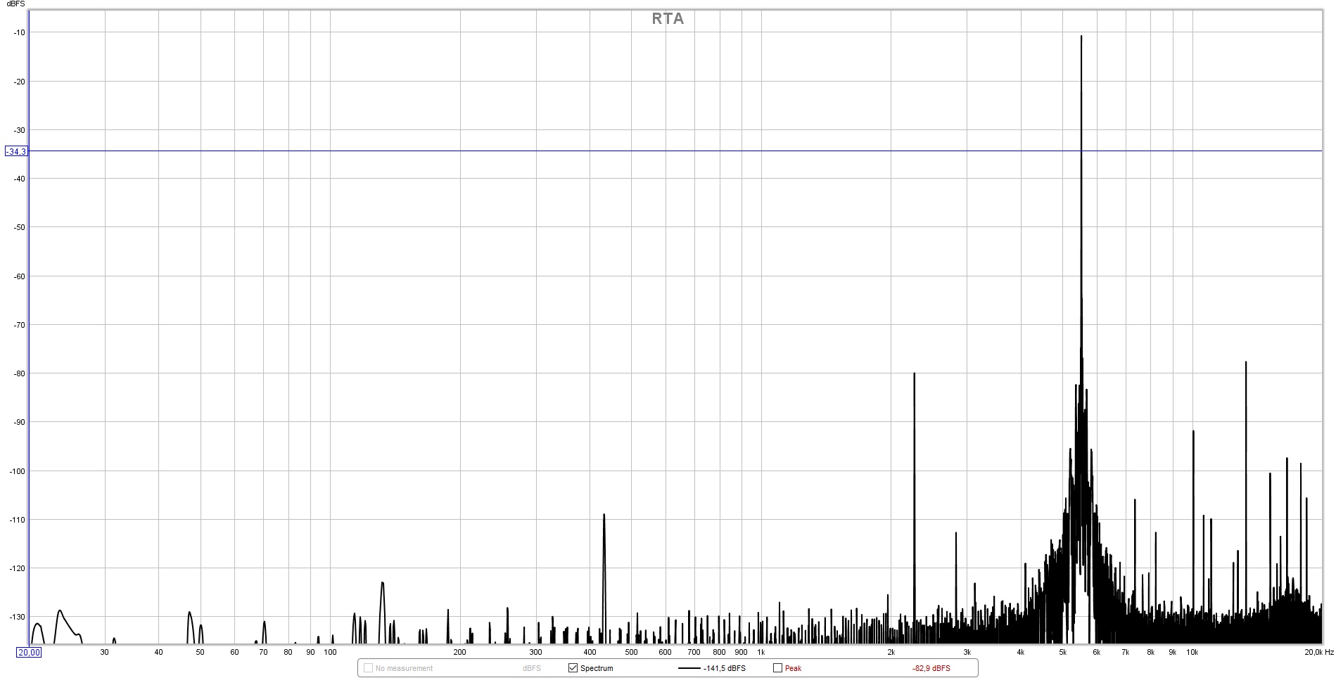

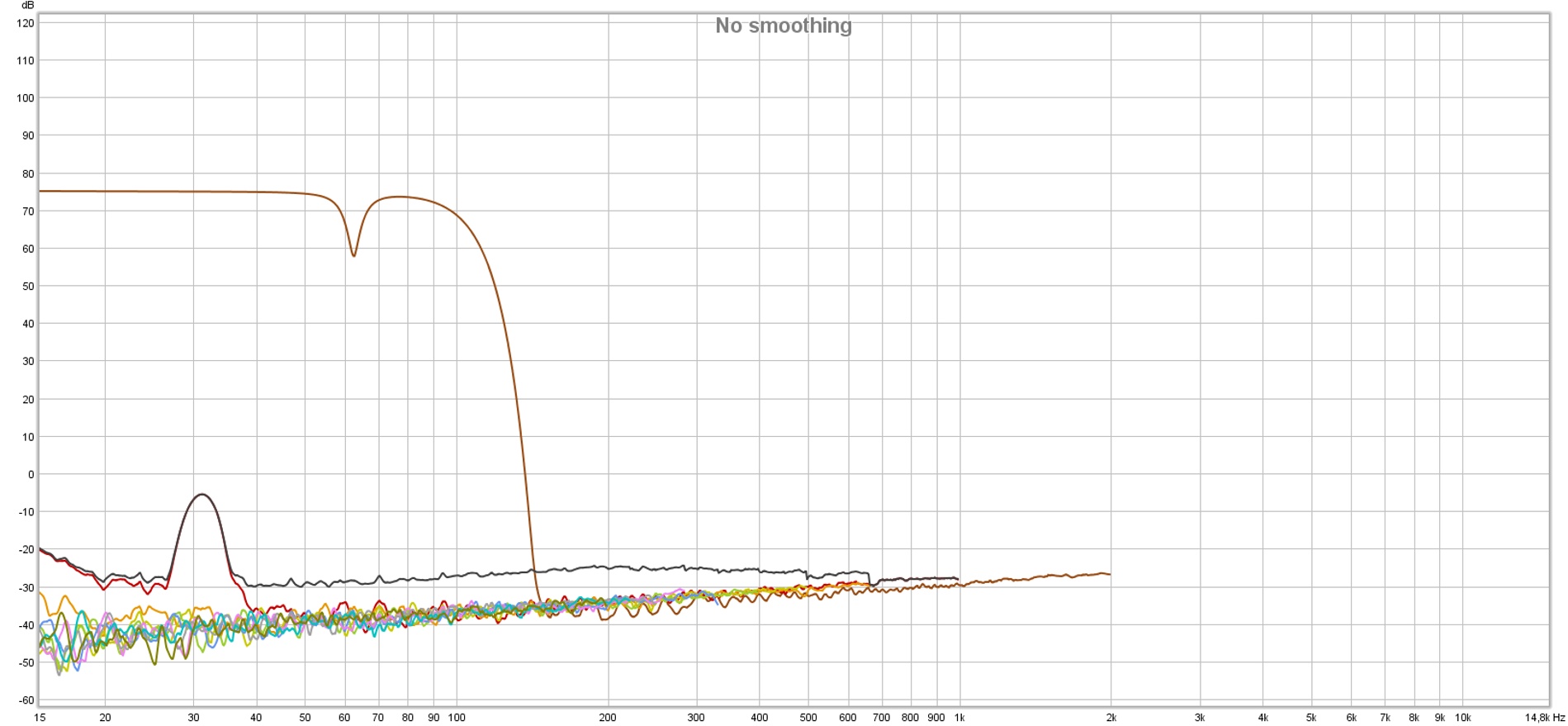

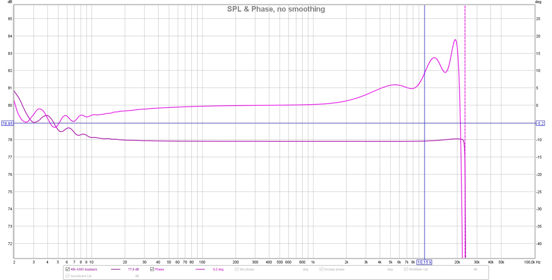

I had to turn off APO on input to make stable loopback measurements.

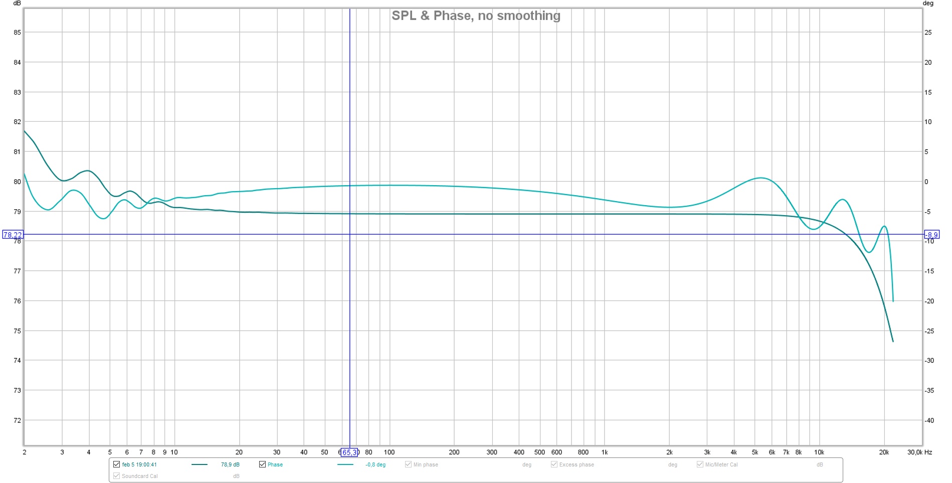

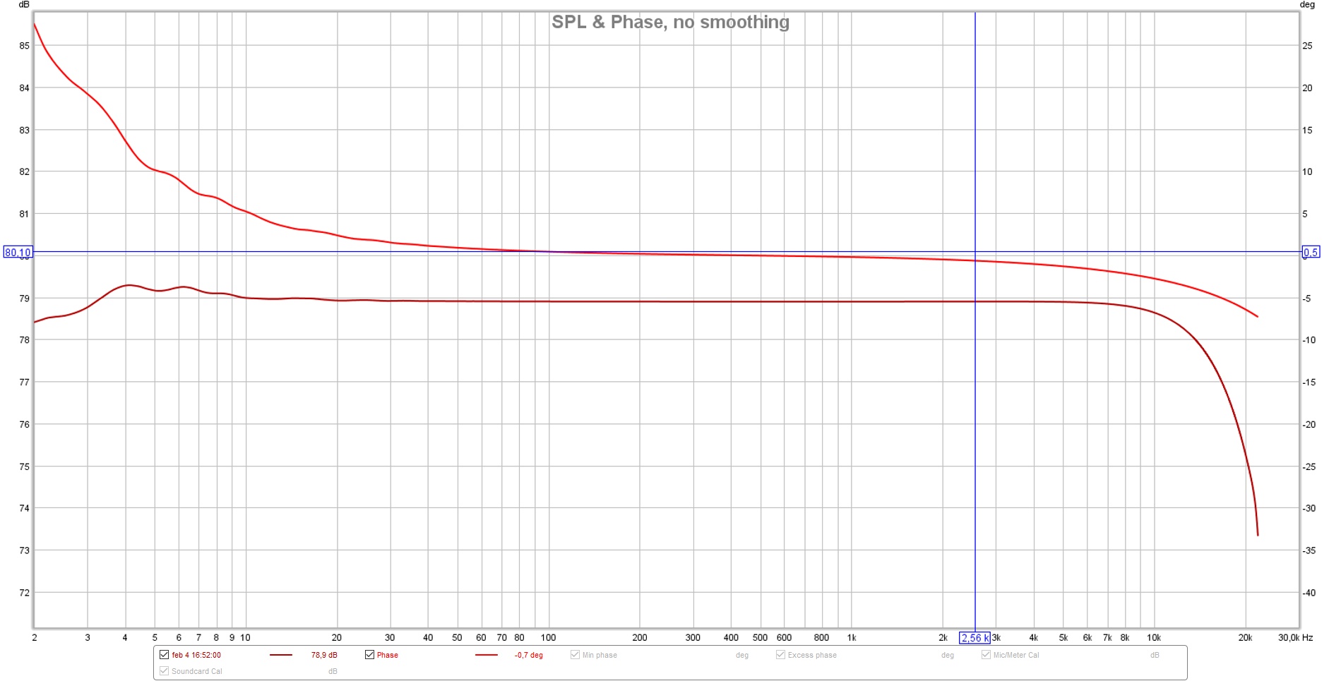

Enclose pictures of closeup phase and SPL with the ends of the spectrum. Be aware of the high resolution so it dont look good but it is good:)
Just a little very LF distortion

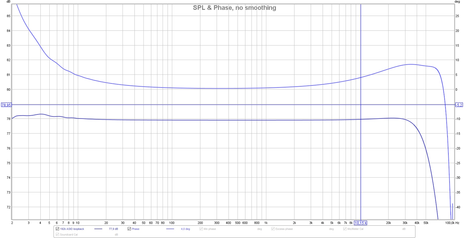

Tried also to set 196k samplerate on the U7. Still 48k JAVA samplerate.
Some HF attunation. I prefeer the no samplerateconversion

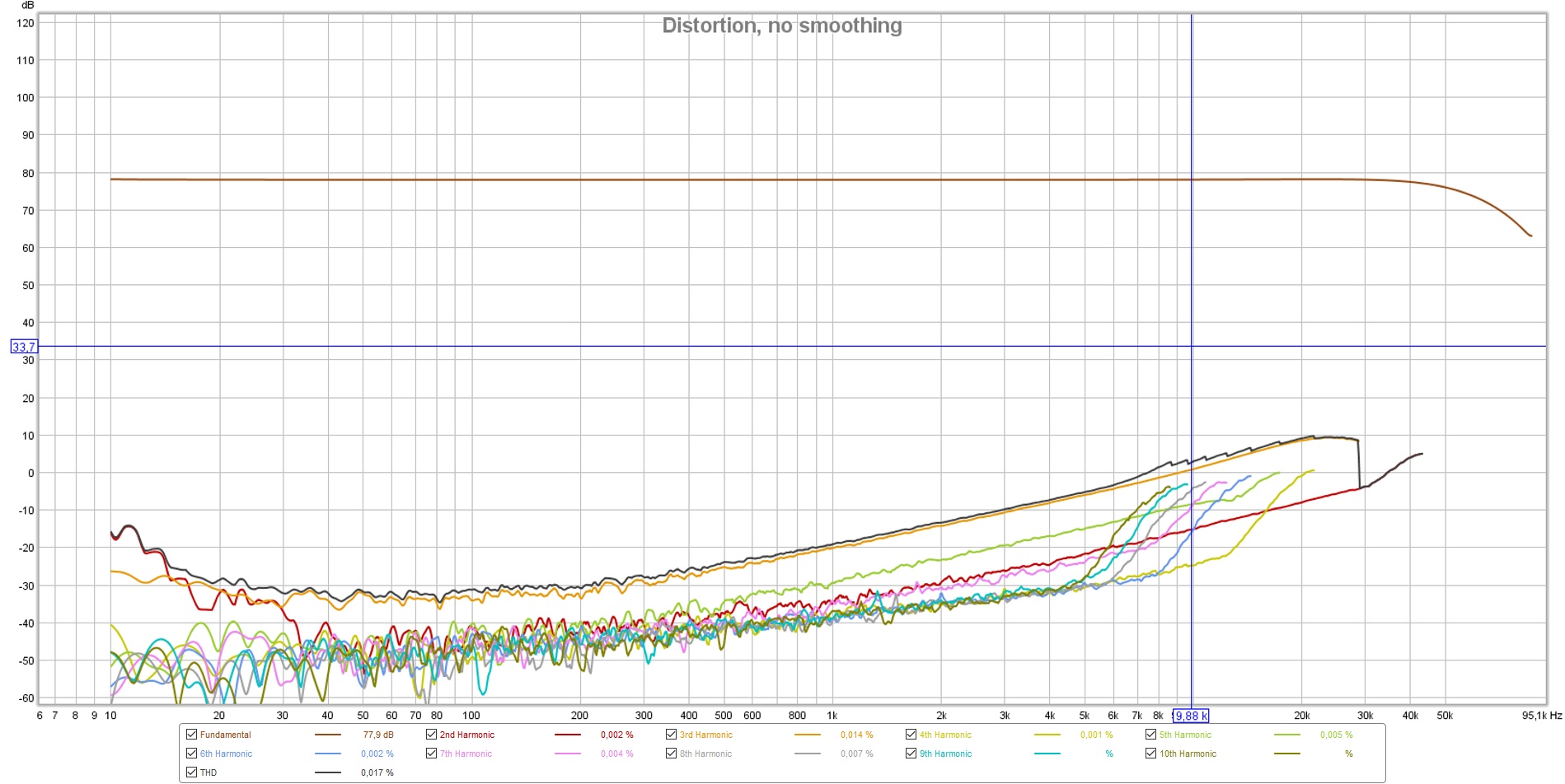

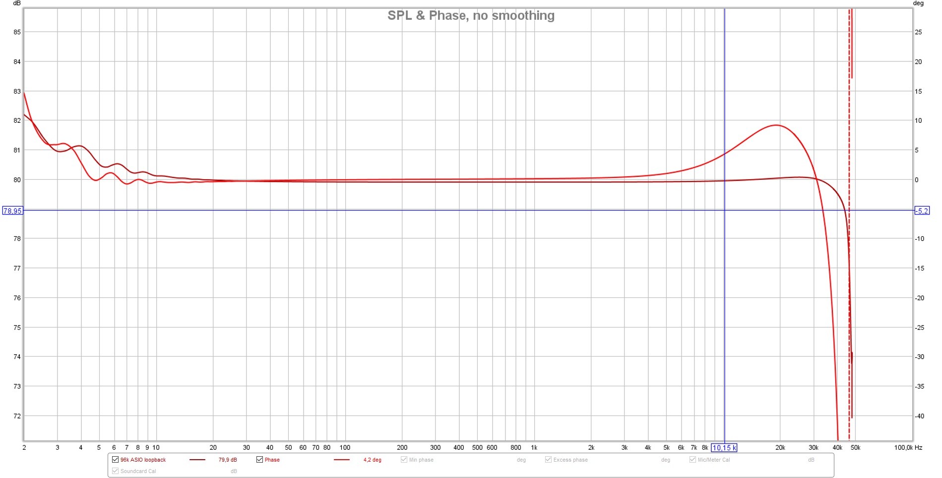

I enclose the pictures from REW ASIO measurements. Then no APO of course.
48k, 96k and 192k.
For HF FIR filtering, I liked the 96k measurements best.
Not the VHF:) THD of the 192k and the phase and SPL has nice and easy roll off at the top. Gives some room to eq an octave away form FS for 20-20k systems.

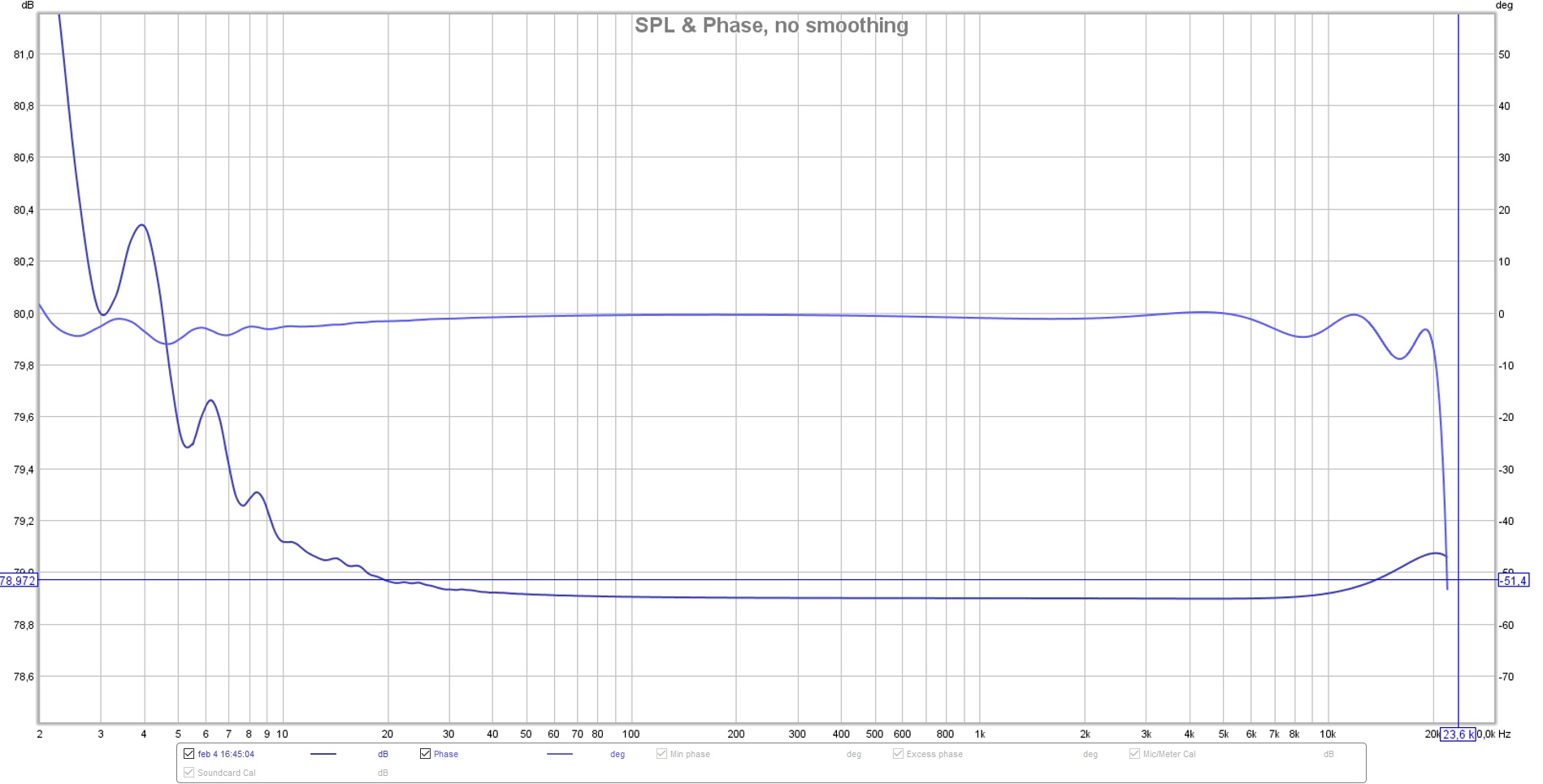

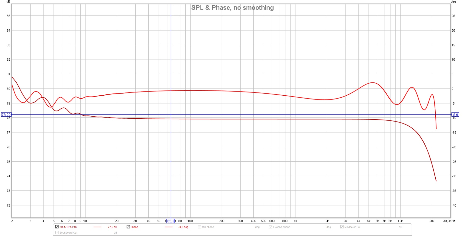

Also wanted to se how samplerate conversion is handled by Win10.
That is if both analog in and local mediaplaying is intended.
All measurements REW 48k samplerate Java driver.
1. All 48k samplerate
2. 96k out. 48k in. So no samplerateconversion on input.
3. 96k in and out. SRC both in and out.
No change in distortion
Not bad, but some HF attunation with SRC.

I'm not exactly surprised that distortion is dominant 3rd towards the high frequencies. The opamp model they chose is a stupid low power part with like 300 µA of quiescent current but 200 mA of maximum output, so output stage bias is ridiculously low and crossover distortion would be expected to be non-negligible. (The really stupid part is that they also used it on the headphone out, rather than a dedicated headphone driver.) A bit of class A bias might really help things out, though it would involve a current source of very low saturation voltage.
Guess ASUS tried to save some PC battery time?
To me the distortion is small enough. (Lower than most tweeters and poweramps)
The soundcard has a lot of small flaws, but no big ones imho.
I really like the low noise and that APO kicks in very soon after you turn on the PC.

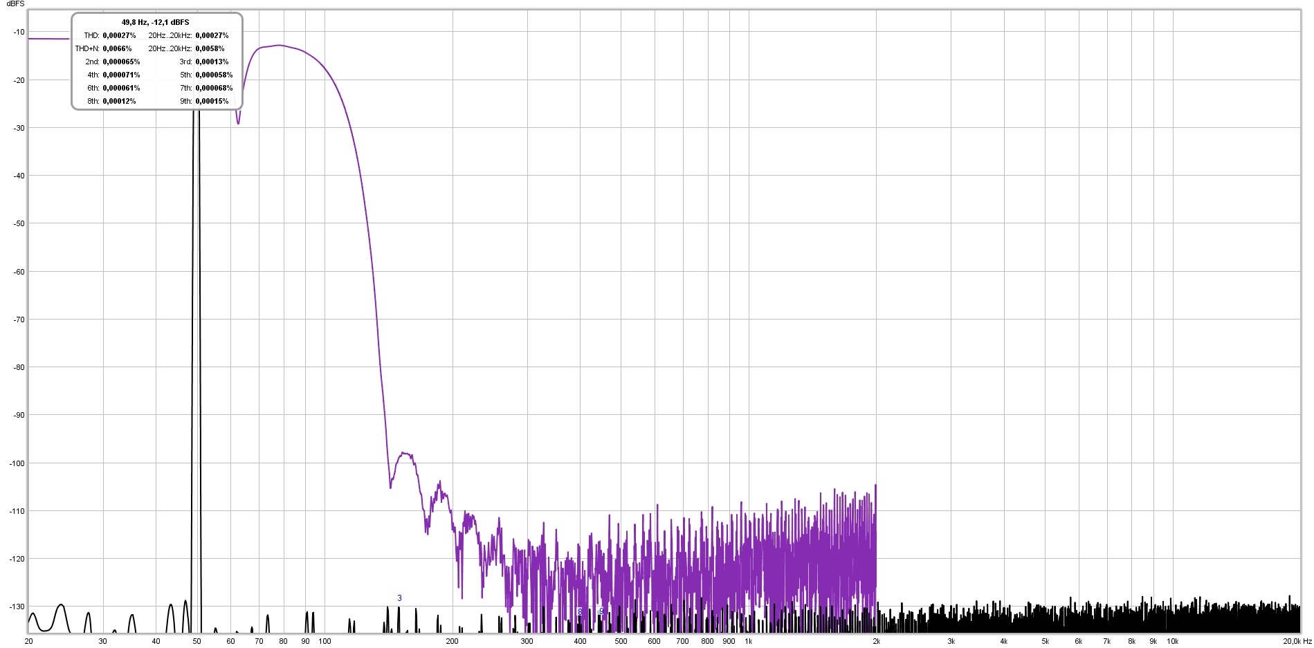

My use of the Asus U7 is FIR filtering for 2 x 4 way speaker.
Asus U7 8 ch into Denon surround receiver with analog 7.1 input.
See there is quite a lot of 50 Hz with harmonics noise. No signal out from measurement soundcard results in input at -85dB FS total. Dominated by 50 Hz and harmonics
Quess there is quite some groundloops with 8 ground wires from u7 to denon.
Then -85 dB is not that bad in an unbalanced system.
And I measured and sent signal with same soundcard so there is another source of 50Hz noise
I must connect the speakers later and check if it is annoying or just drowning in room noise.
