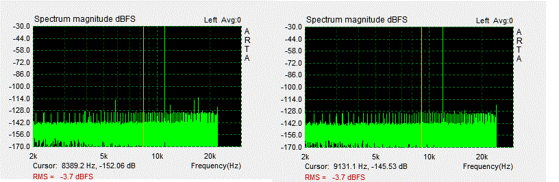

As it happens the Xonar uses an internal PLL within the Cmedia chip to generate its on board clocks.
From my own measurements I have a feeling that the Xonar might only bring in the PLL for frequencies at multiples other then the frequency of the main crystal. So for 192/96/48 etc it uses clock division of the main crystal. I am only basing this on my own jitter measurements in loopback though, so this could be full of holes.
44.1 on the left 48k on the right. Interestingly this problem goes away when comparing 88.2 and 96kHz, but it's reason enough to upsample using software imo. This was done using ASIO drivers.
attachment.php
Using a better external clock might improve the 48kHz performance, but I don't know if it would do much if there's a PLL after the clock.
