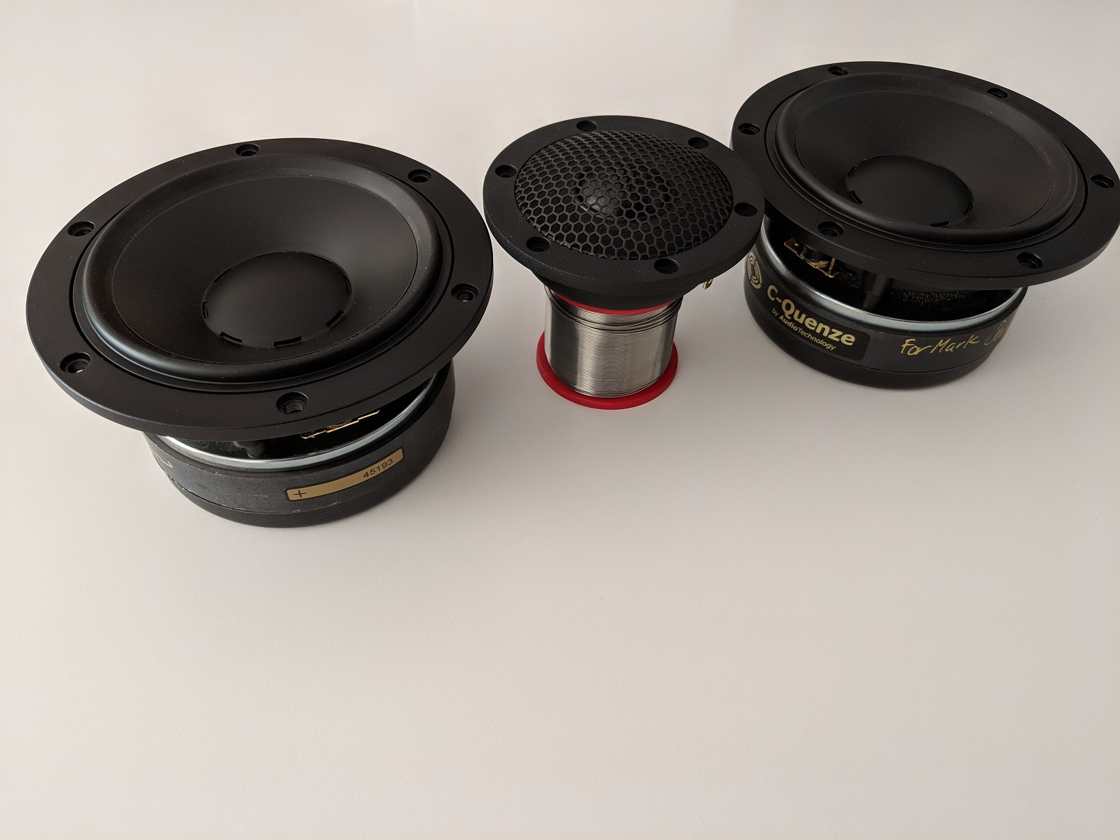

My stockpile of components for SA2014 is growing..
I also took delivery of 4 x Audio Technology 15H52 midrange drivers, signed for me by Per Skaaning :cool: These drivers deserve a good amp, and vice versa of course ;)

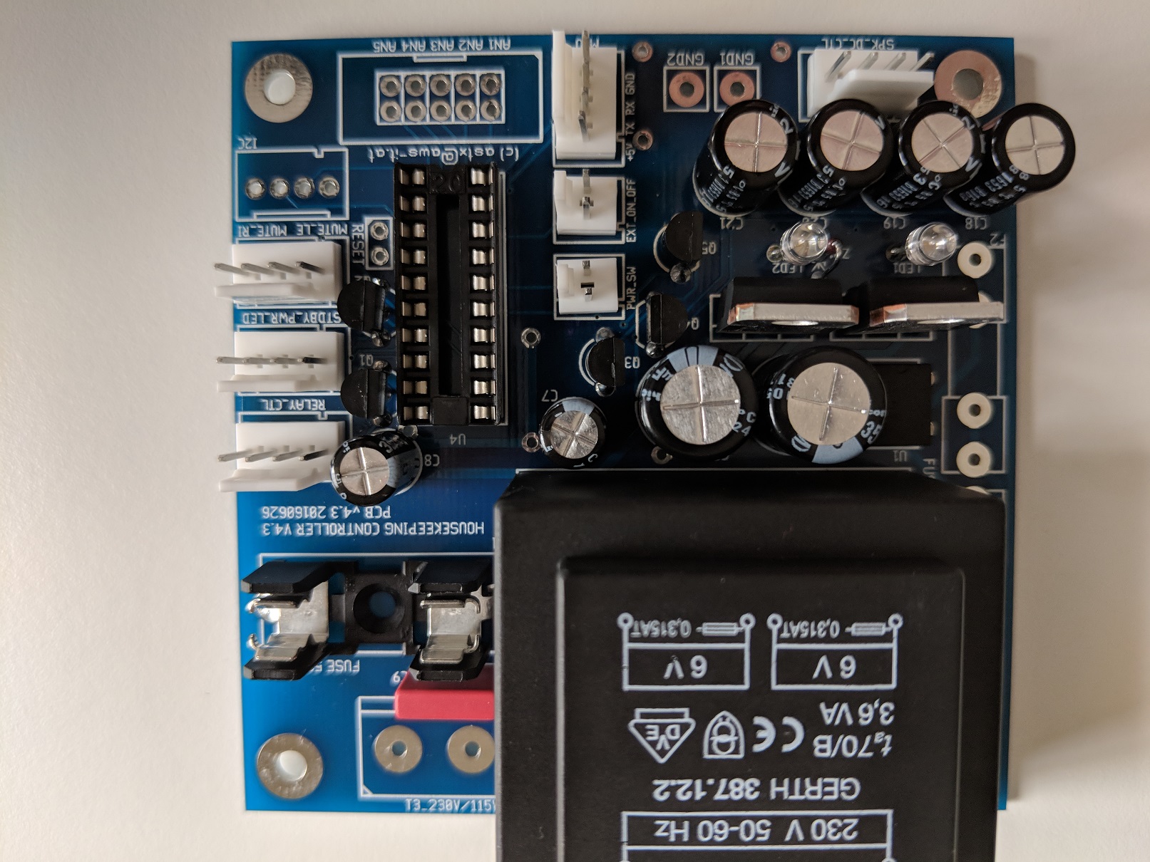

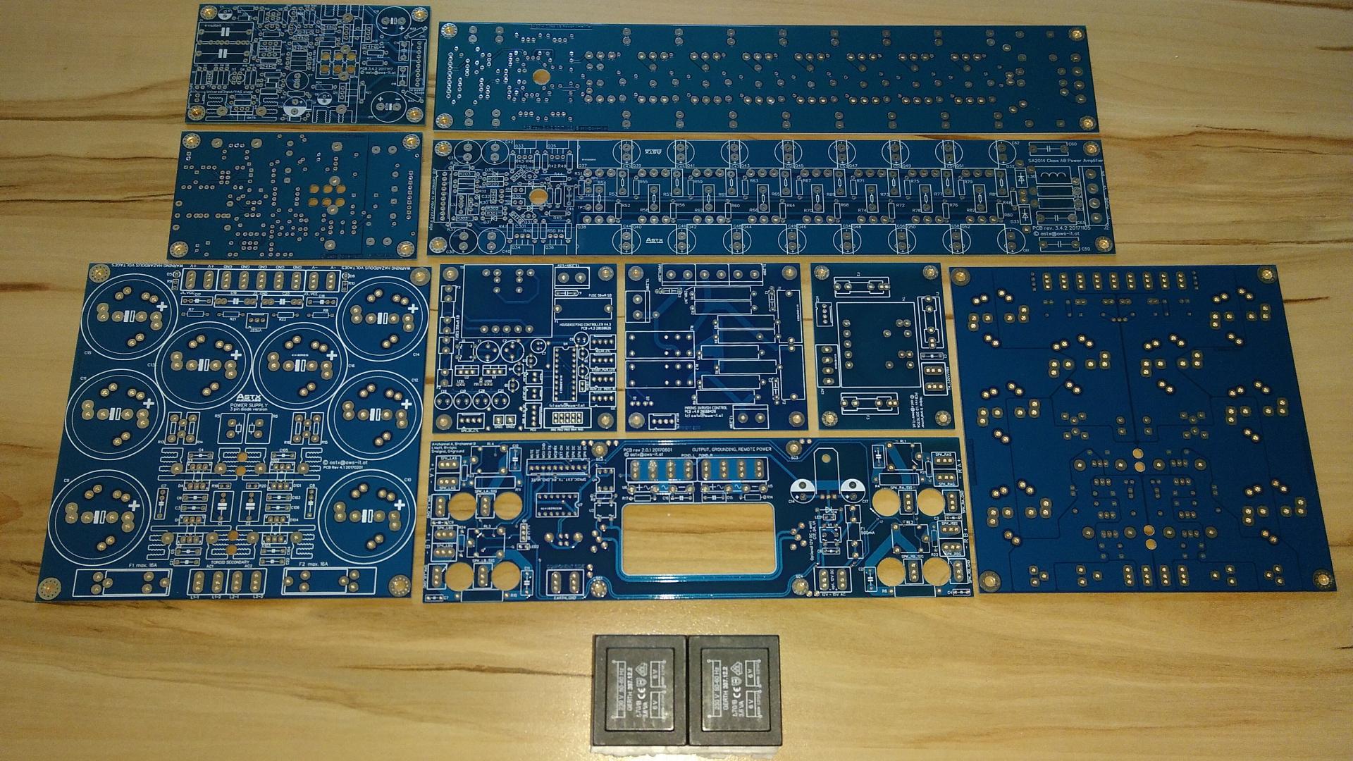

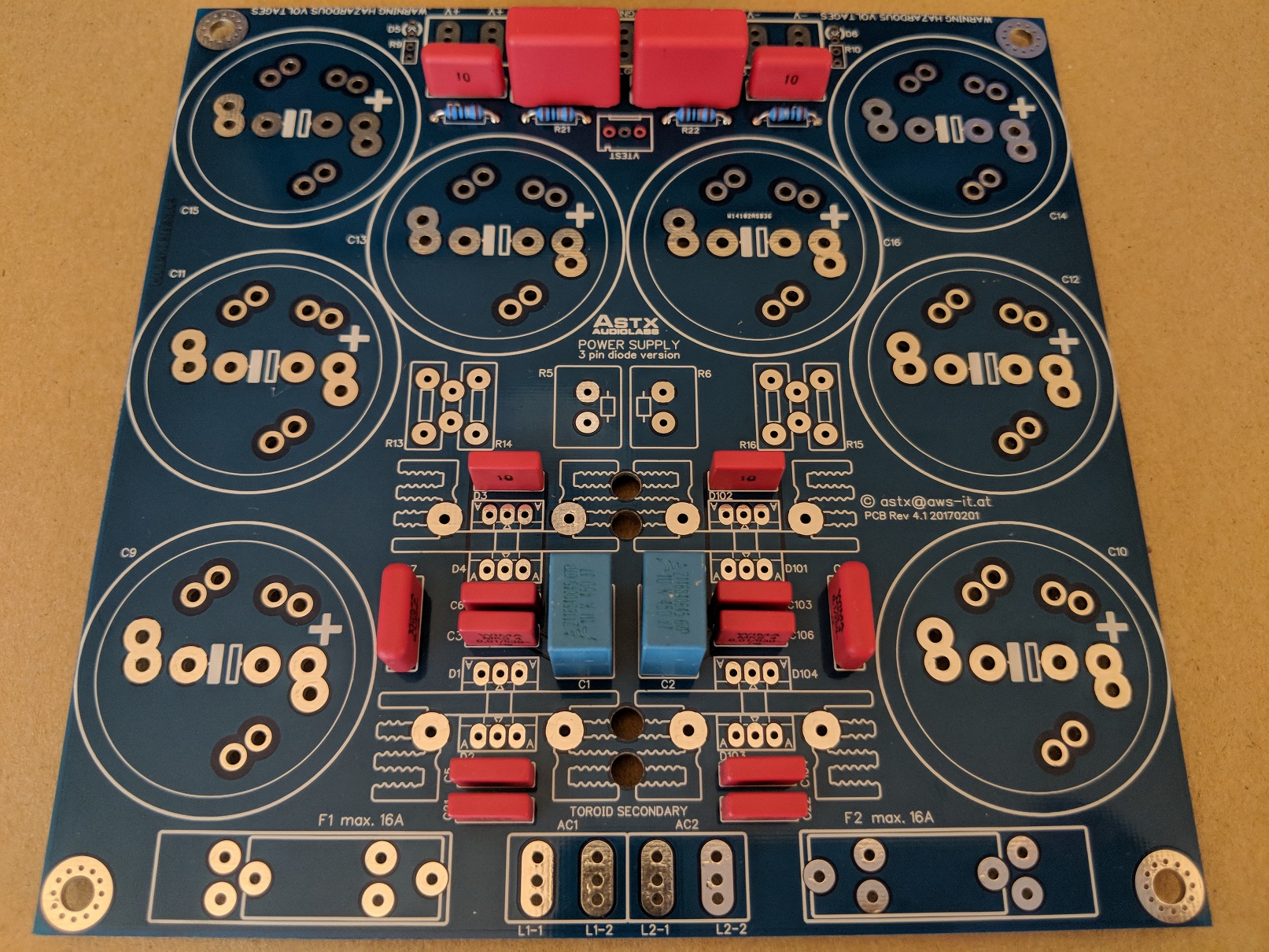

PCB's arrived!
PCB's and some other parts arrived from Toni a couple of days ago. Thanks Toni!
Going well so far, but I need to order a few more parts that I either forgot or were not in stock.
Soon I will start matching the transistors with Atlas DCA Pro. Any advice regarding acceptable tolerances would be appreciated. :)

Joined 2011

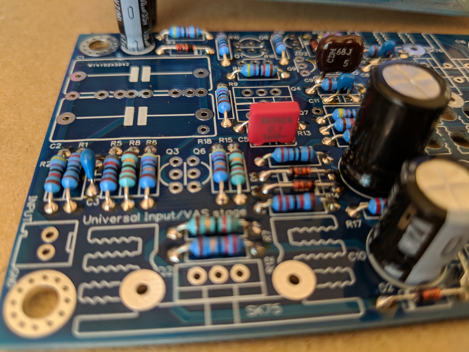

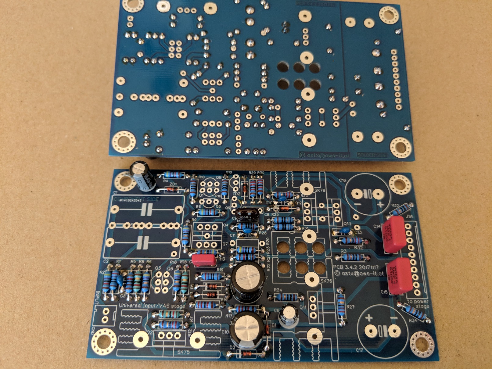

Very clean soldering!
One hint: first solder flat parts and last solder the highest parts.

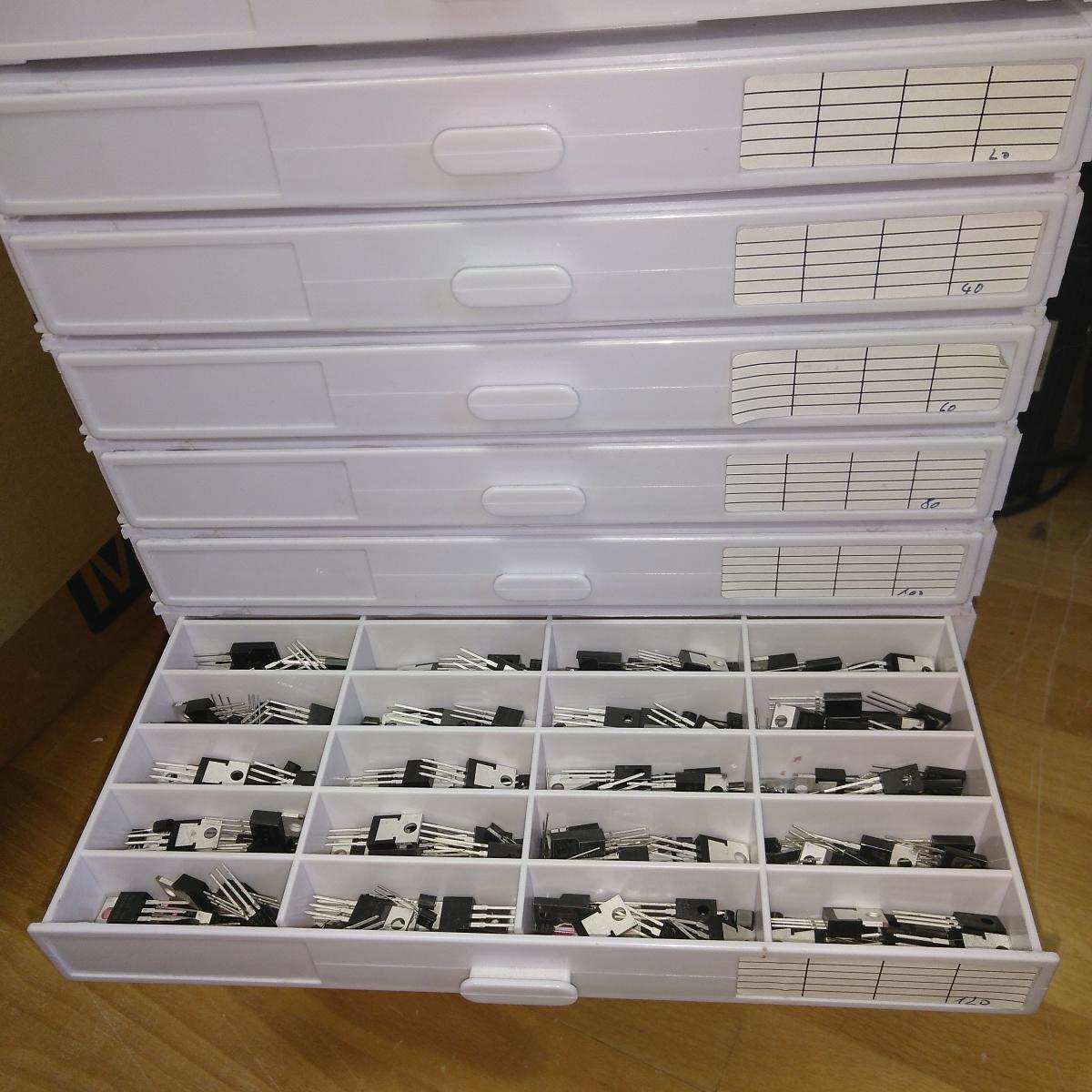

Matching: I have matched them out of the whole batch for lowest Vbe and hFe difference. During matching with your DCA 75 pro all transistors should have the same temperature. e.g. Use a thick aluminium brick and let the transistor cool down after you have touched them. After measurement write down the number on the back side of the transistor so you can find the part after sorting your spread sheet.
Have fun, Toni
Joined 2011
Of course it would be very hard to write down a number on the small signal transistors...
I have used this little boxes to sort them by number.
You simply "scan" your sorted excel sheet for pairs and select them by number from the box.

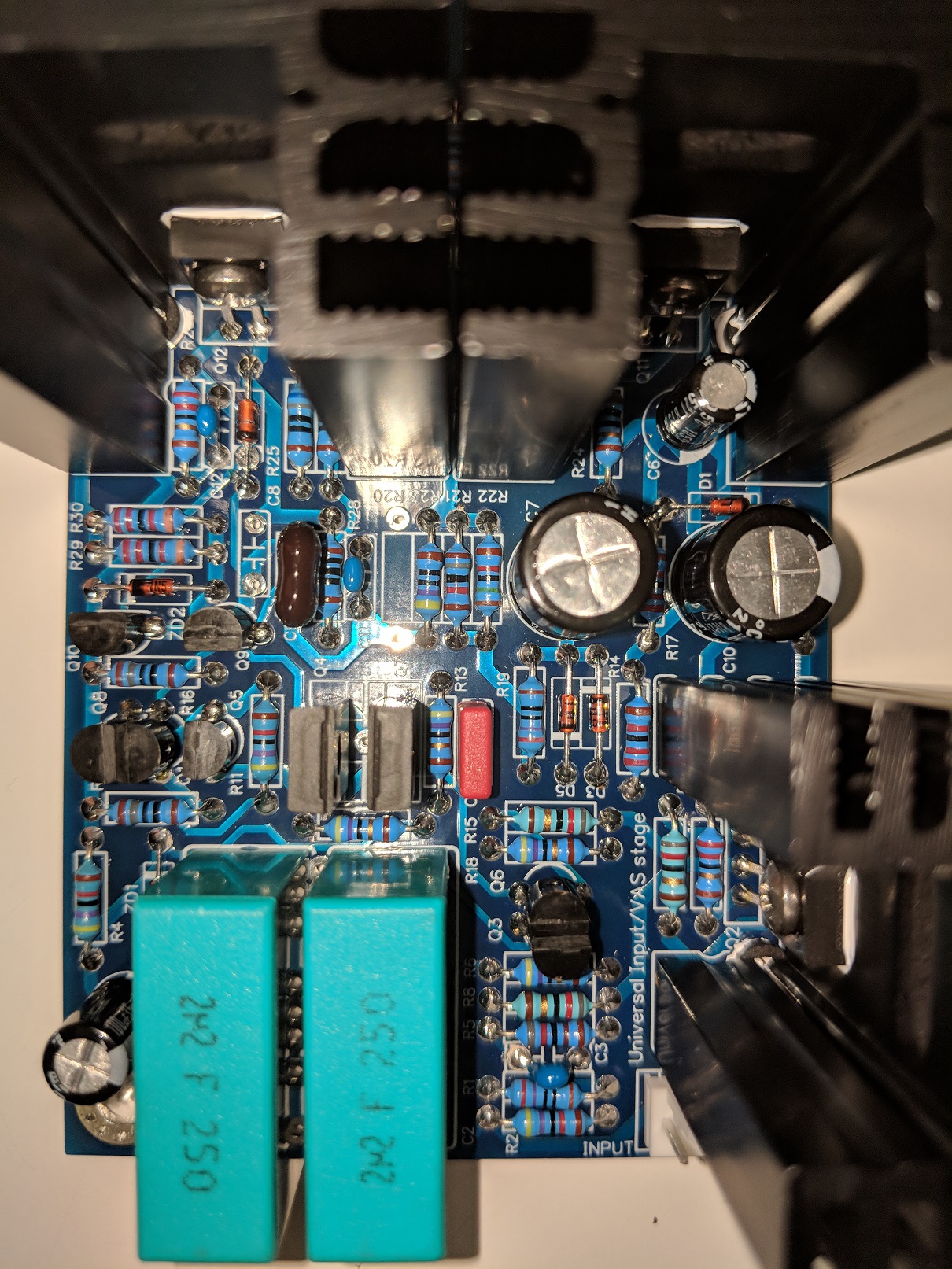

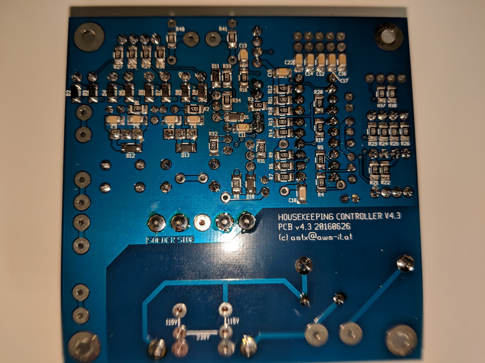

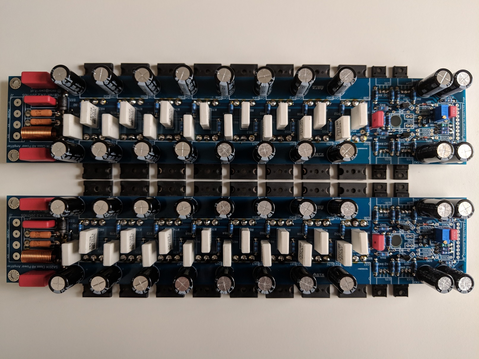

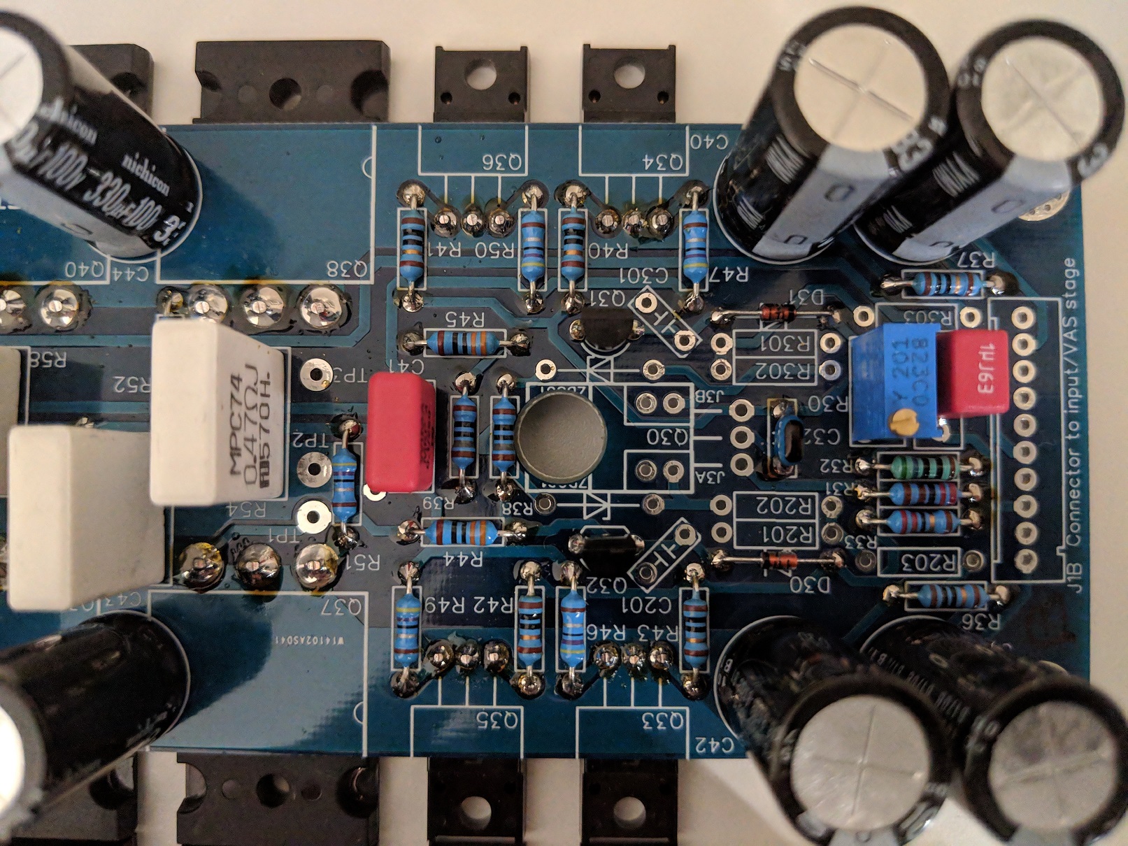

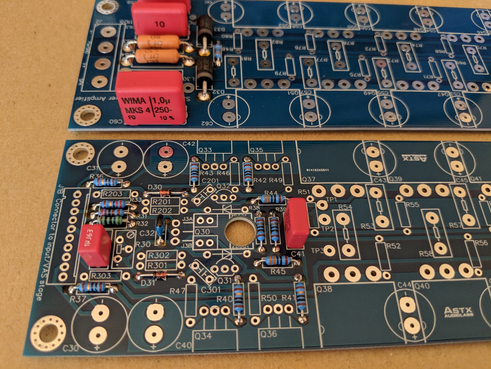

Been very busy lately but finally got a chance to spend some time on the SA2014 project.
If anyone notices a mistake, feel free to speak up :)
