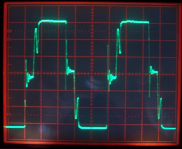

I exchanged the IR2110 by a GDT (Coilcraft sd250-4). The figure shows the waveform of Vgs. It is clean although a bit slow for my taste, and there are a peak that may trigger the mosfet (although the other will be off so I don't think that's an issue).
I have been able to obtain 375W with this and observe a good switching waveform. I haven't tried more but I am sure it will do well. I am almost sure that the mosfets heat up more quickly than with the IR2110 driver, I suppose that the rise/fall times are slower, so

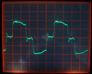

I have finally decreased sw. freq. to 40KHz, and now they become less hot, so switching losses must be dominating.
Unfortunately, when I have soldered the transformer and everything ok, I have done an stupid mistake and something has exploded and broken (but not the mosfets) But as soon as I have repaired all, I will try to add regulation.

The transformer gate drive waveform shows that the transformer is saturating and that leakage inductance is already limiting MOSFET turn-off speed, so it can't be improved. There may be also some cross conduction due to the leakage inductance spike.
You can't just drive MOSFET gates directly from a transformer and expect low losses, this only works with IGBTs that have input capacitances almost an order of magnitude lower than MOSFETs, and with bipolar transistors that are current driven.
It would be a good idea to add some kind of gate buffering, at least for turn-off. Don't try to load the transformer with a lower gate resistor to get faster turn-off since this will only make the leakage inductance spike issue worse.

From drooping dc level on your gate pulses. 10 different choices also why it is happening, I dont know your exact part values and scematics so difficult to say. Do you use dc-decoupling cap on GDT primary? too small dc-decoupling cap or too small chip vcc cap can cause similar dc pulse drooping as core saturation.
I dont see any tricks to speed it up, lower leakage tranny is only option if your layout is already reasonablyy good. I have had good results with DIY gate drive toroids, sub 50ns risetimes to 6nF load with minimal ringing. Sorry, cant recommend any off-the-self products.

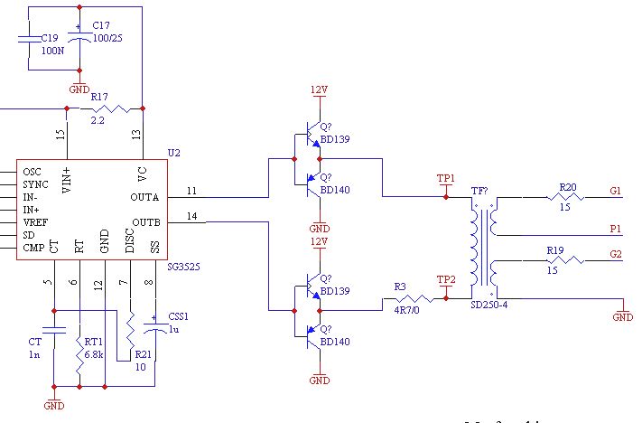

Hello, Eva. Nice to hear from you again.
Here is my drive stage schematics. Forget the NPN/PNP buffer because it is not implemented by the moment, although I would like to try it at some moment. I have ordered a couple of samples of Pulse GDT's, let's see if they work better.
I have selected this IGBT, do you think it can be suitable for 40 to 80KHz operation? : IRG4BC20W

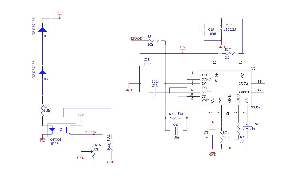

Now I have another problem: I am trying to implement regulation, using an optocoupler (see attached schematics).
The problem is that, while adjusting the potentiometer, R16, (that does vary the "ERROR" node voltage from 0 to around 9V), it cannot make the PWM go lower than maximum duty-cycle, that is, the output of the error amplifier inside the SG3525 chip doesn't go lower than about 3.7v (max. duty cycle corresponds to about 3.5v).
In fact, I have tested with no power, simulating the NFB loop by putting a variable voltage at the "ERROR" node, and as I increase it, the error amp. output goes down to about 3.7V and there is a point where it starts going up again, so I can never reach PWM less than around 50%. Strange, isn't it?
I think it is an issue with the reference applied to NI input or something like that.

IGBTs don't have a body diode like MOSFETs so you should either solder a diode between collector and emitter or get an IGBT with built-in diode.
IRG4BC20W doesn't include a clamping diode but otherwise it would be fine. Note that reverse transfer capacitance is less than 10pF. Also note that IGBT conduction losses at low currents will be higher than in MOSFET, but they won't skyrocket as current is increased like in MOSFETs.

About regulation, I have built a small prototype board with the sg3525 chip just for testing, and found that the problem was that the inverting input gain (resistor between pins 1 and 9) was too low: 1.5 V/V (R was 15k and input R was 10k), so the error opamp output (pin 9) was doing strange things (as not inverting for some input ranges).
Once I have increased that resistor to >150K (G>15), the circuit responds linearly with increasing duty cycle for decreasing voltage and vice-versa. All this in a very limited range of about 300mV of input voltage around 5.1v (Vref): Below around 4.95V, PWM is 47%, and above around 5.25V, PWM is 0%.

SG3525A suffers from error amplifier latching when inputs are allowed to go below 1V above groud or so. I stumbled into similar problem because I'm using this error amplifier for average current control, and I solved it by adding a 2.5V bias to both signals.
There are other low-cost ICs like TL494 whose common mode input range includes ground, but TL494 has its own drawbacks in comparison with SG3525, particularly it lacks double pulse supression and premature pulse termination capabilities.
Also, be very careful when loading COMP output of SG3525A, it has a very low sink current capability, something like 100uA, so load impedances below 50K may be troublesome. Try to use that amplifier as an unity gain buffer and place the actual error amplifier and its compensation in the secondary side instead, before the optocoupler.

Ok, thanks for the suggestions.
As a first approach, I will use the SG3525 error amplifier in the primary side and only zeners+resistors in the secondary, as shown in the schematics I posted. Let's see how it works then. Once it is up and running, I will try to improve it.
As for the coupled inductor to balance both outputs, I am planning to stack two T106-2 cores (micrometals) and bifilar wind about 40 turns for 20uH, with 1mm wire. Then I will use one wire for each rail, but in opposite directions.
