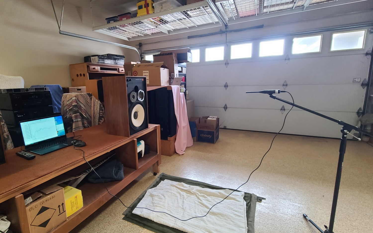

Measurements posted by a user on ASR: Details belowIs this your measurement? Was it on a stand, and away from walls, etc?
"I thought this group would be interested in how some vintage speakers compare to each other under the same measuring conditions. I have a collection of vintage speakers and simple measuring setup. No Klippel machine for me! I measured the frequency response of each speaker with:
- Laptop PC with Creative soundcard
- REW software
- Dayton UMM-6 microphone, with calibration loaded in REW
- Random Denon amplifier
- 1 meter distance, on the tweeter axis
- 20x24 garage with hard floor and 9.5' ceiling
- Small amount of damping on the floor
Here's the setup."
