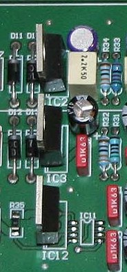

The three stabilizers at the bottom, vertically in line with the "analog output stage":
IC2 = 1587AT, on top of that is printed D49AB
IC3 = 1587AT, on top of that is printed D49AB
IC12 = 1587AT33, on top of that is printed DG7AB
These I'm not familiar with, googling revealed these to be voltage regulators (= stabilisers) for very low voltages (1.5 and 3.3 V).
Only IC2 is in the analogue section, the other in the digital.

I take it you mean the section in the attachment.
IC1 is not in the section, did you mean IC12? If so, the 3.3 V is correct. This seems to funcion OK.
But the other two, IC2 and 3, should not have these high voltages. If I read the datasheet correctly the 1587 voltage regulator is either fixed to 1.5 or 3.3 V or, if an adjustable version is used, variable between 1.5 and 3.3 V. This is where I'd start my search for the fault. No surprise, actually, the high ripple already indicated a problem here.

R31 & R33: gn-br-br-bk (-br)= 511R 1%
R32 & R34: or-or-bk-br (-br)= 3k3 1%
The 3k3 resistors are attached to the ground plane on one side (see attachment). This would mean that they are R2 in the formula from the datasheet:
Vout = Vref (1+ R2/R1)+Iadj(R2)
Vref = typically 1.25 V and Iadj(R2) is so small, it's negligible.
Then Vout = 9.3 V. My assumption the adjustable version of the 1587 can't go above 3.3 V seems wrong.
That's good news actually, that means that the components behind these stabilisers didn't get fried by overvoltage!
If I read the colours correctly, then IC 2 and 3 are set to the same voltage (i.e. 9.3 V), in which case IC2 has seriously low output. This is a power supply for the analogue section. The LF50 behind it probably doesn't get enough voltage to work properly.
Something is going wrong around IC2 which may affect IC3's output as well (without IC3 being defective).
Now it's a matter of finding if the fault lies upstream or downstream (or the stabiliser itself).

Agreed, it's strange, but don't forget we don't know what's the cause yet. Judging by your descriptions it has all the signs of PSU failure, but keep in mind something else might be wrong (too).
Besides, you only know the voltages of three of the regulators and there are eleven in total...
