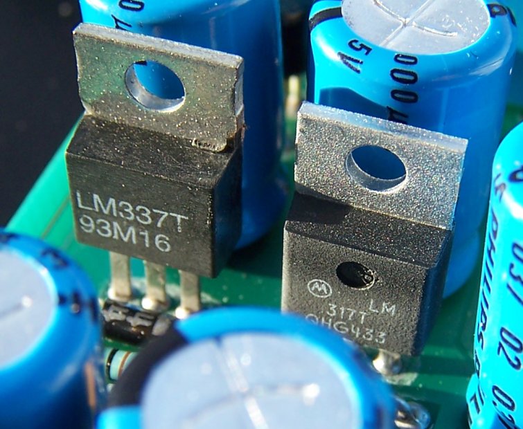

I took the DAC to a hi-fi technician today. We opened it up and checked it using a voltmeter and oscilliscope (not that easy as we do not have a schematic).
We found the following:
- in one area of the power supply section, on the PCB, there are three components (look like the component in the attached image; I am not sure what they exactly are
) in a row.
- one of these (labeled IC1) measures roughly 3.3V and is flat on the 'scope
- the second one (labeled IC2) measures roughly 5V and shows a 0.2V point-to-point ripple on the 'scope
- the third one (labeled IC3) measures roughly 9V and shows a large 1.4V point-to-point ripple on the 'scope
He also measured the outputs on the scope. The left RCA jack exhibits a 0.4V ripple (right output is flat/silent, as it should be).
As to what the above actually means and how it can be fixed, I do not know. I have sent the info to the manufacturer and am awaiting a reply. I don't suppose you could shed some light on this? 🙁

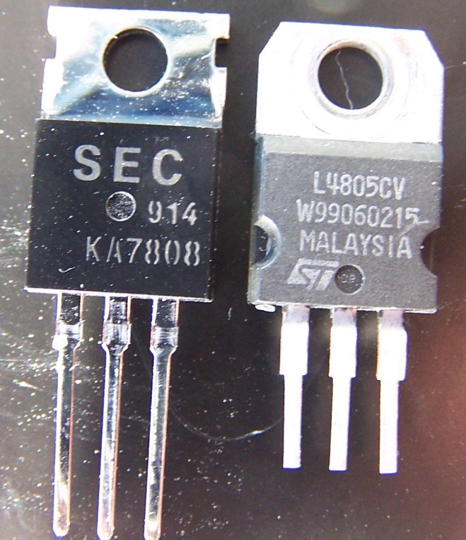

It's impossible to say from your picture, but the DAC is RTB as a manufacturers return via your distributor. It's faulty.

In the picture left to the component I can see "C1" which is cut off. That would be the "IC1" you mention. I also see a 0.1uF cap and an elco in the vicinity. For me they are signs that these components are most likely stabilisers.
They should not have more than some mVpp ripple when fully loaded (which they are not, there is no heatsink on them).

In the picture left to the component I can see "C1" which is cut off. That would probably be "IC1". I also see a 0.1uF cap and an elco in the vicinity. For me they are signs that these components are most likely stabilisers. They should not have more than some mVpp ripple when fully loaded (which they are not, there is no heatsink on them).
I unfortunately did not take a photo of the entire PCB, and the DAC is with my technician at the moment. I found a low-res image in a review and have attached an image with lines pointing to where these are located. There are three in a row (~3.3V, ~5V, ~9V). Looks like the path is from transformers to PCB through some caps and then to these, so perhaps they are indeed voltage stabilizers.
There's the source of the hum! Since the R channel has no hum, it doesn't share the power supply with the L channel and must have its own (useful for comparison when measuring!).

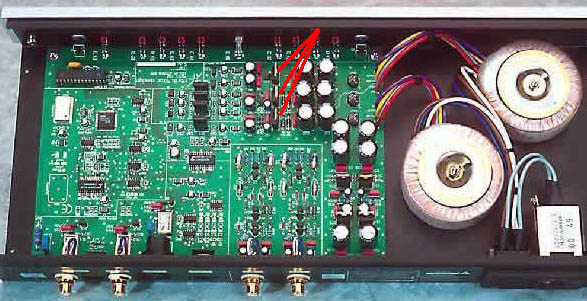

It may be worth taking a closer look at the pcb (take it out to have a look at the solder side too). Maybe the US distributor left some debris that shorts intermittently. It happened to me a few times...
Yeah, I found a picture on TNT audio, it seems to have completely symmetrical R & L supplies. It COULD be intermittent, a dry joint on one of those big caps on the 9V LH supply would probably do the trick. It could be as simple a fix as reheating the solder joints on it. Not a big risk even for a novice...

Hi guys. Thanks so much for the assistance thus far. I could not find any debris on the PCB. Would dry solder be visible at all?
I have some more photos which I uploaded to a hosting site (as they are larger than the size limit here).
The first one is an overview of what looks to be the power supply section. At the top left (very blurred in this photo) it says "ANALOG SUPPLY" and at the bottom right it says "DIGITAL SUPPLY". I am not sure if that "DIGITAL SUPPLY" section is the area which continues to the right in the photo. Also, you will notice that the three stabilizers are marked (top to bottom) IC2, IC3, and IC12.
The second image is of what looks to be the "ANALOG SUPPLY".
The third image is of what looks to be labeled the "DIGITAL SUPPLY".

Yes it is very neatly laid out and labelled. Below is a photo of the entire PCB which may give a better "big picture" view of what may be happening, where the power is going, and if/where it splits between L and R output. It shows the neat delineation between the "analog supply", "digital supply", "analog output", "digital input" sections etc.
I think there is more stabilising going on further on in the digital and analogue power supplies as I see some more TO-220 (name of that particular shape) ICs to the right.
Does the above "big picture" photo reveal anything perhaps?
The power supply traces seem to be hidden from view (they're probably on the solder side of the pcb). So I can't really tell from the picture if they are separate.

This is where my limited knowledge really starts to show. Which components are you refering to? And would you need the white writing that is printed on those components?
Let me help you. Usually three things are printed on the component: the brand, the type and a batch code. I'm only interested in the type (several brands produce the same type of very common components).
In the attachment you can see an LM337 and an LM317, the writing below the type is not of intrest to me. You will find similar printing on the case of other types.
It would be useful to have the reference designator (i.e. IC1, IC12, etc.) that is printed on the PCB next to the component too (e.g. IC53 = LM317).
