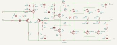

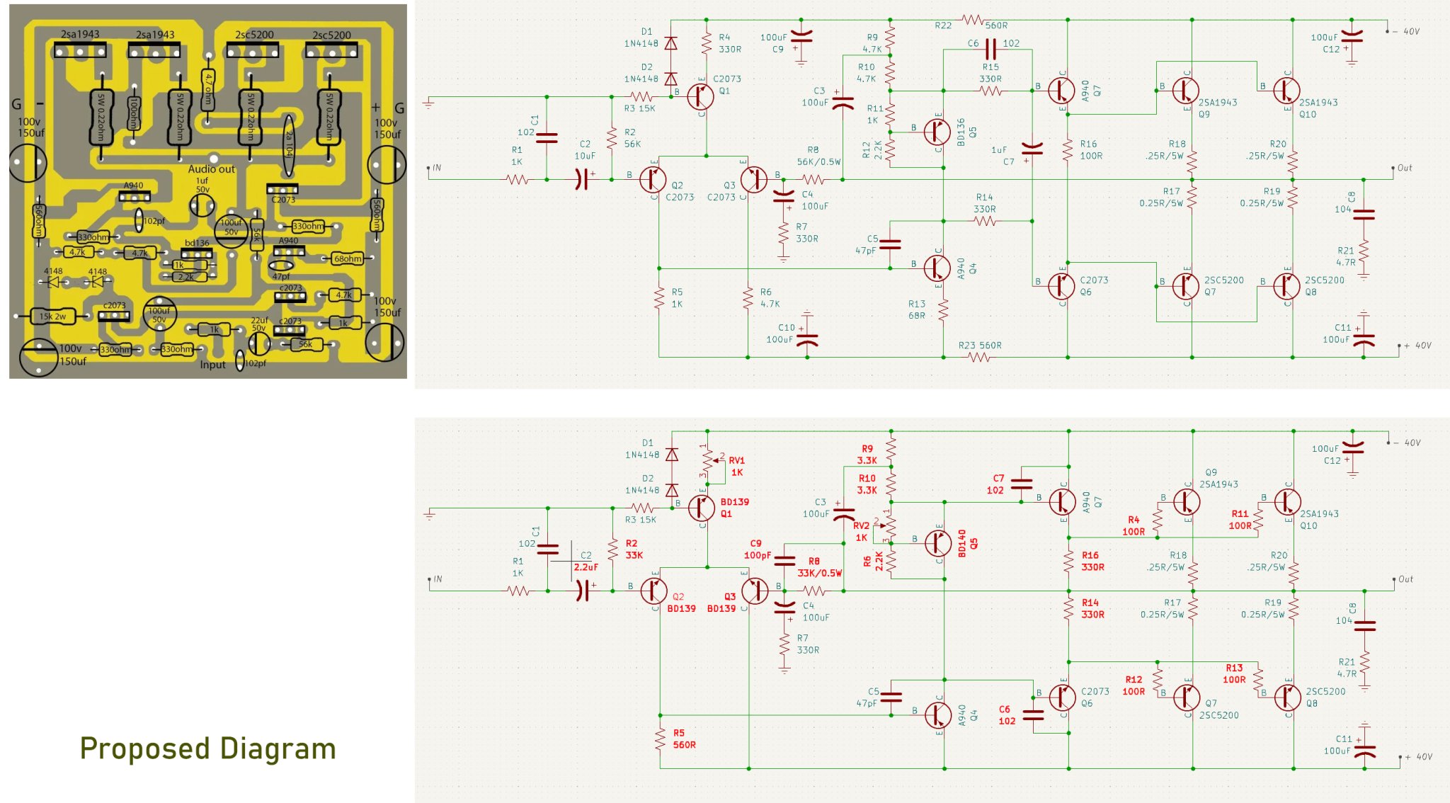

Hi, this circuit is really popular in Bangladesh among users of the system for small events. they don't care quality sound they just need to roar for 12 or 15 inches speakers.
I bought a PCB to explore with, and I believe I should strive to make it better.
This board is what I've chosen because it's produced locally and is quite affordable. If a small adjustment would enhance the sound quality, individuals who have already invested in the board will save money as there would be no need to buy a replacement.
The majority of people that build these kinds of systems in our country lack training and are ignorant of concepts like bias current, DC offset, etc. as A hobbyist I would like to assist those who are looking for better-quality sound.
Do you guys believe that the circuit is well-designed and should I work on it?

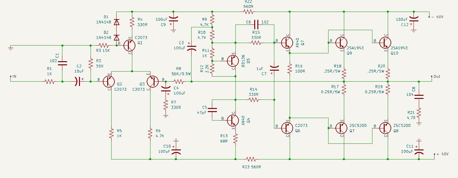

Error! The base of Q4 must be connected to the collector of Q2.
The scheme has been traditional since the 70s.
The choice of a pair of transistors Q6\7 (insufficient power) raises a question.
R14 should be bypassed with a capacitor (like R15).
Makes it look like something new and exciting, when there is in fact nothing new under the sun.

It’s just been done to death already. “Is this any good” depends entirely on your particular implementation. It can work well or it can suck. Drawing it upside down doesn’t make it any different.
Doing idiotic things like using 2SC2073 TO-220 drivers in the diff pair doesn’t exactly inspire confidence.

The guy is just asking for help to improve a schematic sold as a consumable in Bangladesh, he is not asking for a dissertation on what is good or bad, just something to improve this ancestral thing.

If he just used transistors intended for their purposes. BD140 VAS and a small signal input pair. Even BD139 input diff pair is a little silly. You don’t need ”something big to keep it from blowing up” there. If you get fakes and THAT causes a problem it’s on you.
If the only thing you can find or afford are fake output transistors and drivers then reduce the power supply to +/-30 volts and simply live with the amount of power it generates that way. It won’t blow up if you use all generic parts that way - including TIP3055/2955 outputs or whatever is inside fake 2SC5200’s. Higher supply rails simply require The Real Thing. There is no getting around that.
