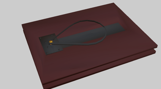

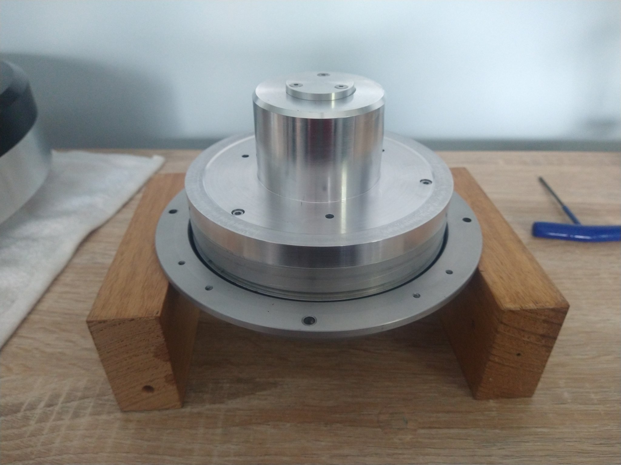

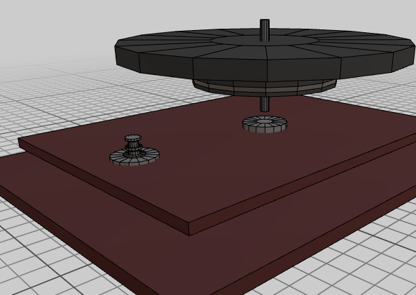

HI,Preliminary design. Wooden base, aluminum plate for locating the top section of the motor and main bearing. The motor controller is the critical component here. I have located some '9V DC motors' and 'PWM' controllers for electric motors, but no way of knowing how accurate they are. The standard Victrola fare should do for the moment. Or the Crosley (See image in step 3). These are just plans, it would be difficult for the wood work to be done here, maybe.

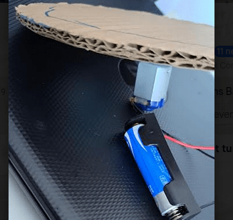

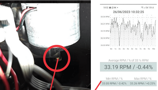

With the smartphone based app which measures the wow and flutter of a turntable, it occurred to me that it would be possible to test the variation in speed of any rotating turntable, even a simple one. I decided to set up a turntable with a simple motor and measure it with the smart phone app, to get an idea of what sort of speed variations take place.
This was a cardboard turntable with the common type of DC motor and a 1.5 V battery. It was difficult to get the turntable turning with the weight of the phone on top of the turntable, so it had to be turned by hand, once it started moving, it kept moving.

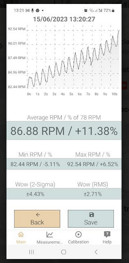

Here is a screenshot:
2.71 % is ten times the minimum value it should be, but this is without a speed controller of any sort. The experiment highlights the need for a powerful motor to start up the turntable, which in any case will be heavy, even given the multiplier effect of the belt, though in this case a direct drive was used.
I might try again with a more powerful motor and a speed controller. If the speed of the turntable can be somehow controlled to within 0.20% then it looks like it
could be the basis for a drive system, otherwise I will have to look for alternatives.
Even if it does not work out, I can test the effect of turntable weight on speed stability.

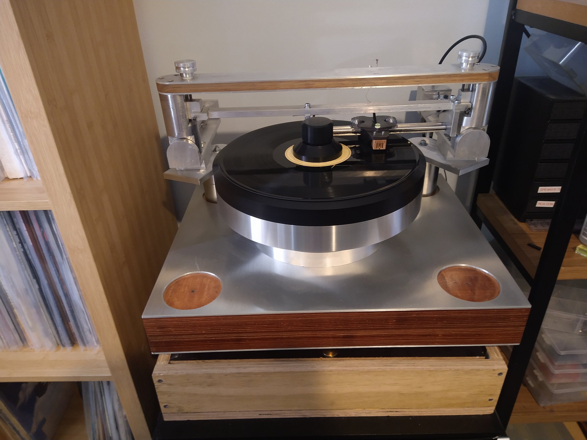

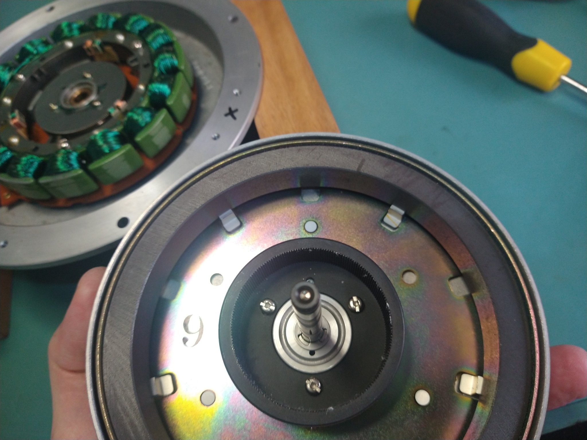

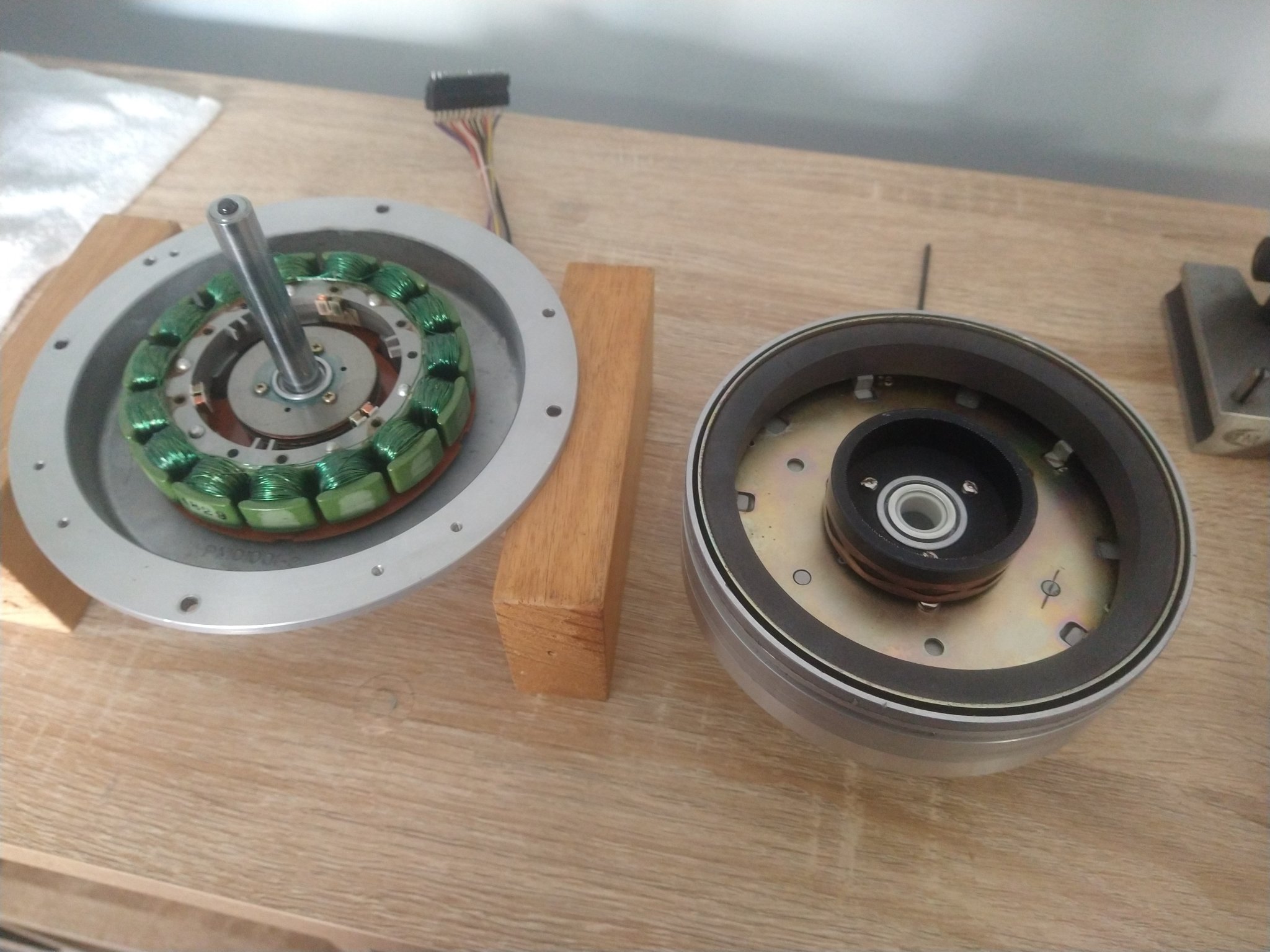

I thought I'd add my experience modifying a Technics direct drive motor. Hopefully this will give you some insight to making a bearing and platter for your TT.
The original motor used a 9/32 spindle in the usual way with the point of rotation under the motor. I modified the motor to use an inverted bearing.
The journal is 12mm Silver Steel and the sleeves are made from Vesconite. The sleeves are a very close slip fit this is not a hydrodynamic bearing. A custom platter was made from aluminium and POMC. The large journal sleeve carrier only mates with the Al base of the platter the POMC does not touch the bearing and the LP spindle is decoupled so it also doesn't touch the bearing. Bearing noise in the platter is below the noise floor (-110dB) of my test equipment.
I guess the takeaway is POM is a great material for platters. Placing a stethoscope on a stock platter mat you can clearly airborne sound in the platter, the POM platter there is zero audible sound emanating from the platter. Vesconite is a good polymer to use for bearings, once run in (about 1hr) it's almost totally silent when measured directly on the motor housing. I add a couple of drops of ISO68 oil to ball on the top of the spindle and that's it.

That's a really nice turntable, thanks for sharing. Many questions: Vesconite? POMC? Is that a linear tonearm?I thought I'd add my experience modifying a Technics direct drive motor. Hopefully this will give you some insight to making a bearing and platter for your TT.
Some say a turntable is a precision machine, this certainly looks like it.
Vesconite is a polymer specifically designed for bearings in hostile environments it's used in train carriages. IMO it's better than PEEK and Torlon as it's far quieter due to its lower coefficient of friction. BTW I use Hilube.....
https://www.vesconite.com/vesconite-hilube/
POM is Polyoxymethylene there are 2 variants Copolymer and Homopolymer, also known as Acetal which can be C or H. Dupont has a proprietory version called Delrin which is a specific Homopolymer.
Yes that is a linear tonearm which I made.
I'm in the "Turntable is a precision measuring instrument" camp. Most audiophiles have no understanding just how sensitive of a seismograph a TT is. It is so sensitive it can pick up a conversation 10 meters away in another room. If you can design the TT to isolate the stylus/LP interface from all of the external vibrations happening then you are well on the way to an exceptional TT.
As you have indicated you're fairly new to this I'll go into more detail.
There is a considerable amount of energy generated by the stylus in the groove, this energy needs to go somewhere if the platter is well designed then the energy can be transferred into the platter where it travels through to the bottom and some reflects back to the stylus. The idea is to make this journey as slow as possible. POMC has similar acoustic impedance to the LP so there is good energy transfer into the POMC. POMC also has greater density than acrylic so the energy attenuation in POMC is greater. The aluminium base does 2 things it prevents the POMC warping (I use 30mm flat sheet) as well as providing stiffness and an interface where there will transmission and reflection of energy spreading and attenuating the returning energy wave back to the stylus.
I use a stethoscope to listen to various parts of the TT and it's interesting just how much of the music you can hear the stethoscope from the LP.
There is a reason a lot of highend TT manufacturers are using POM for their platters now.

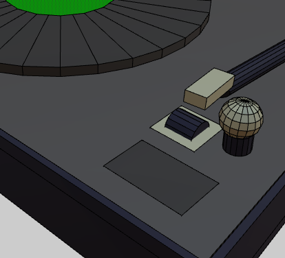

I think a microscope for viewing the stylus and an automatic roller brush to clean stylus after each side might be a good idea.
I have not been able to find such a feature on any turntable. The black screen in front will show a magnified image of the stylus.

I disassembled an USB turntable, the EZCap 613 as seen in the image below, and it has a motor that looks like the motor sold on Ebay.
The wow figures dropped considerably with the record and the 185g smart phone on the platter, so a heavy platter and suitable bearing should ensure that the speed variation is within acceptable levels. Assuming this is the case, and that this is a servo motor, not needing any extra speed controlling hardware, the following preliminary design is suggested. The black rectangle is the mounting plate that is shown suppressed for clarity. The motor will be mounted in a cut out in the MDF layered plinth.

Nice drawing work.

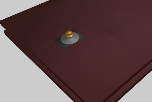

With the motor secured (virtually, in 3D, and the belt in place, time to source the platter and bearing. The platter weight does not seem to have a bearing(!) on speed variation, I have found from testing the EZCap. Wow is at 0.23% or so, but depends on the time of day, it may be the power line. Will test with batteries.
Here we are: platter, bearing, motor and everything else. Free shipping as well. A cork mat should improve things, hopefully wow and flutter is at a minimum. I purchased this in 2020 or 2021 and cancelled the order because I was not sure if it was a complete turntable or just parts. I know better now.
