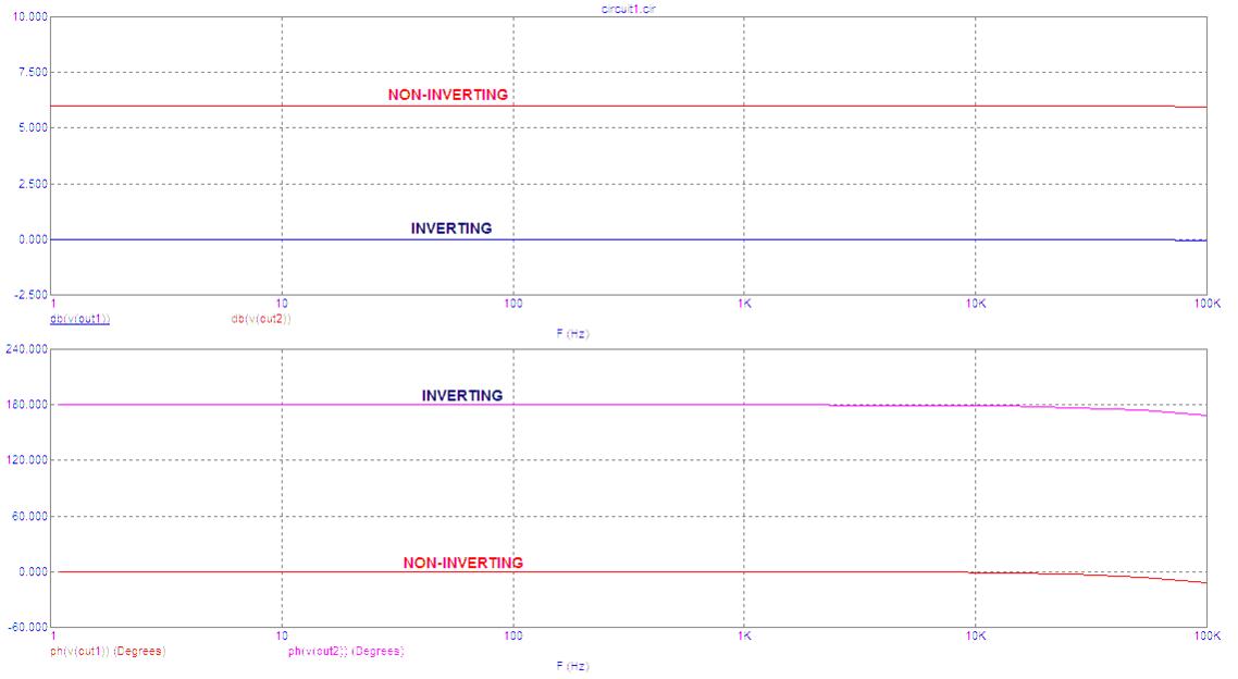

Hi Geatan/and others,
Why was it not immediately apparent how inadequately a non-inverting gain-stage (op-amp) performs in a tone control application where symmetry in potentiometer setting (boost/cut) and linearity is the objective?
The graph of HAKSA tone control shown in your post is not at all representative of a tone control using a non-inverting gain-stage with the tone network in the feed-back loop.
I am sorry if I am being hard on you Geatan, but it is unfair to other readers of this thread (not having the skill to question) thinking that what they are going to build is a symmetrical bass & treble control (which is what your graph shows) while this is not the case at all.
Besides to achieve a "semi flat" response with the current design, the controls would have to be set closer to a 2 or even 3 o'clock position and not a 12-o'clock position that one would expect to achieve a flat response.
The objective of a group design is for skilled members to highlight problem areas and offer possible solutions.
The current tone control in my opinion is inadequate and the weak link in this simple HAKSA design. If nothing else I would encourage it to be a simple passive circuit and humping up the amp gain to counter for the losses.
Kind regards
Nico

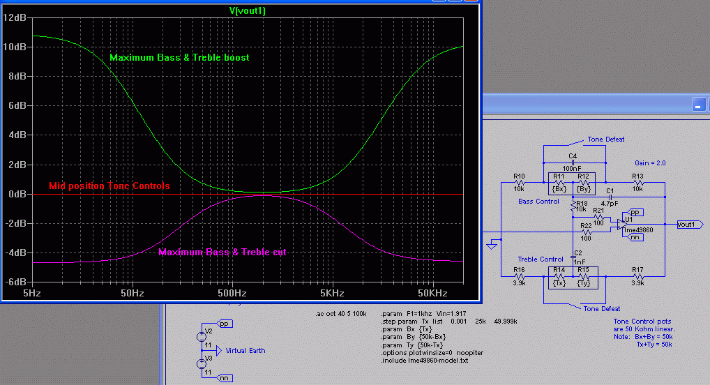

Thanks Gaetan!
Very nice graph, you did that in Tina?
When you gun for more cut/boost with the circuit used in the HAKSA, when controls are flat there are serious discrepancies in the FR. With the values chosen, there is no such effect, but cut/boost are limited, also by the non-inverting issue, which is not usual for a conventional Baxandall and I wanted to avoid. Without the small 22pF cap on the fb loop of the opamp, there is serious gain peaking, but with it, all is well.

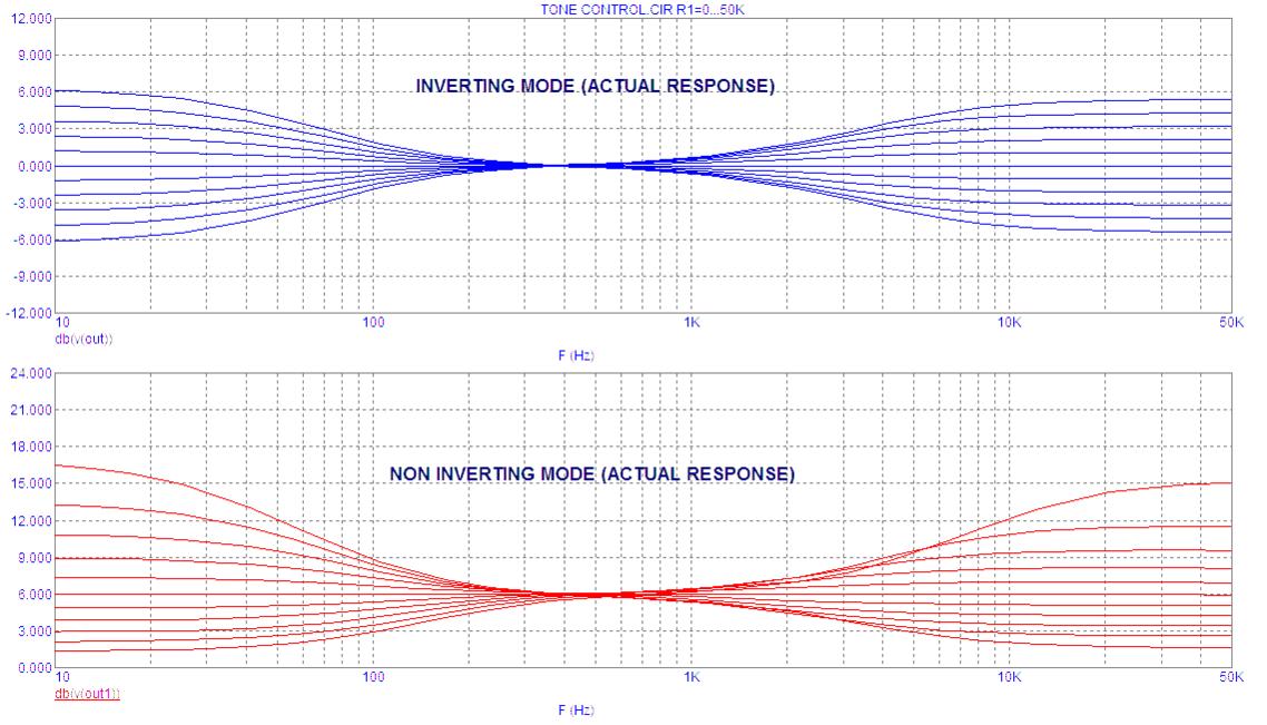

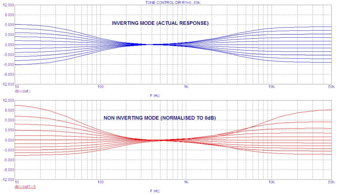

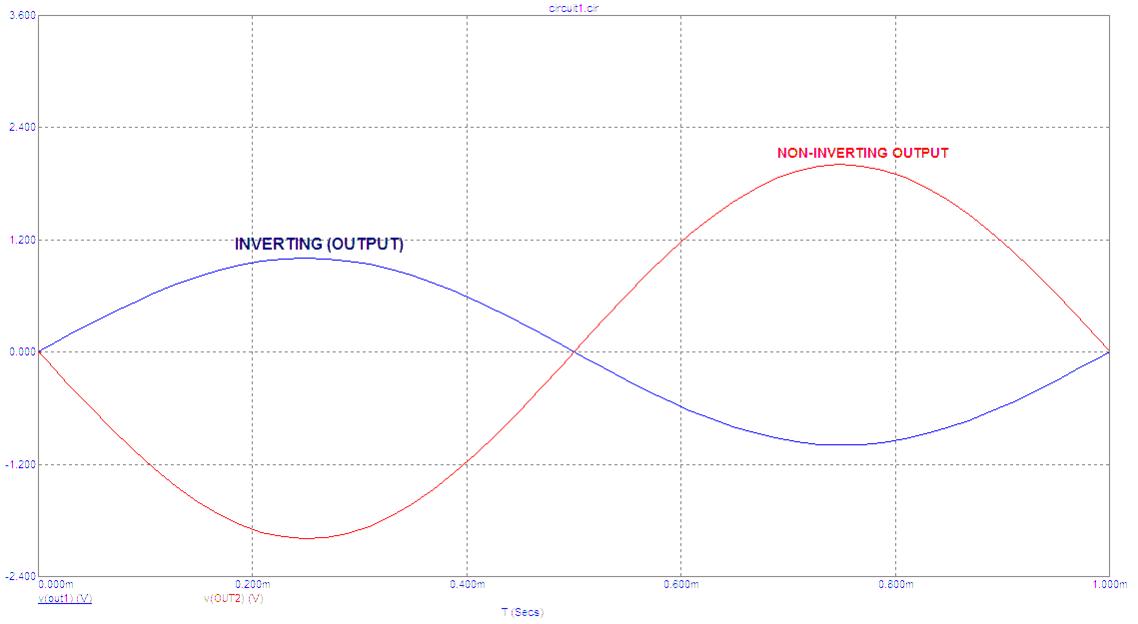

Response Curves for inverting & non-inverting comparison
What I am attempting to demonstarte is the difference between the response curves for the bass and treble control in the feed-back loop utilising either non-inverted and inverted configurations.
You can clearly see the non-linear operation of the tone controls in non-inverted mode.
On the other hand if this appeals to you then so be.

Hello Nico
The first simetrical graph was the Quad 34 preamp as I said, comming from Quad web site.
So I never said that Haksa tona amp graph was simetrical, but that it was less strong boost that the Baxandal type tone control.
And for the simulation I can't do other sim since my Tina-Ti simulator don't work properly.
